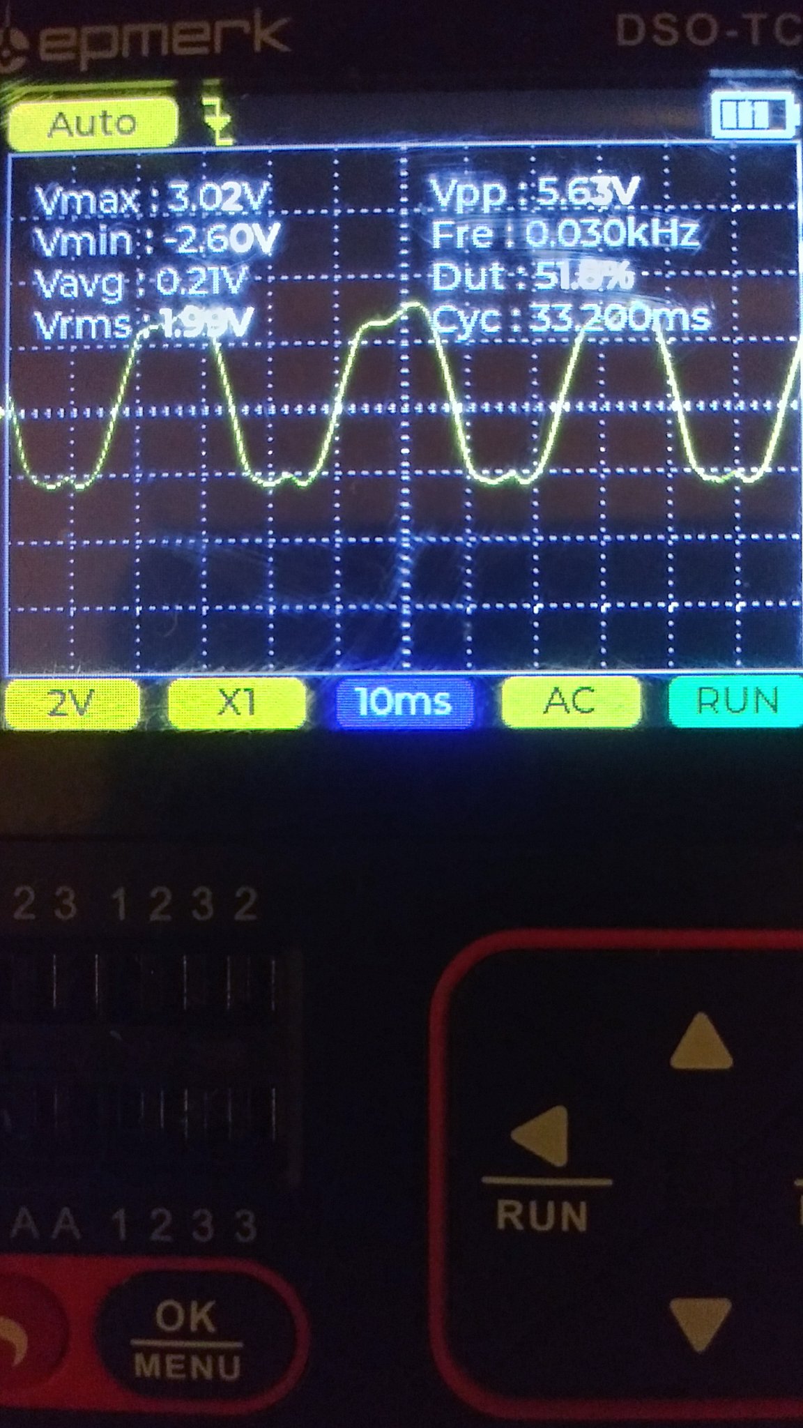

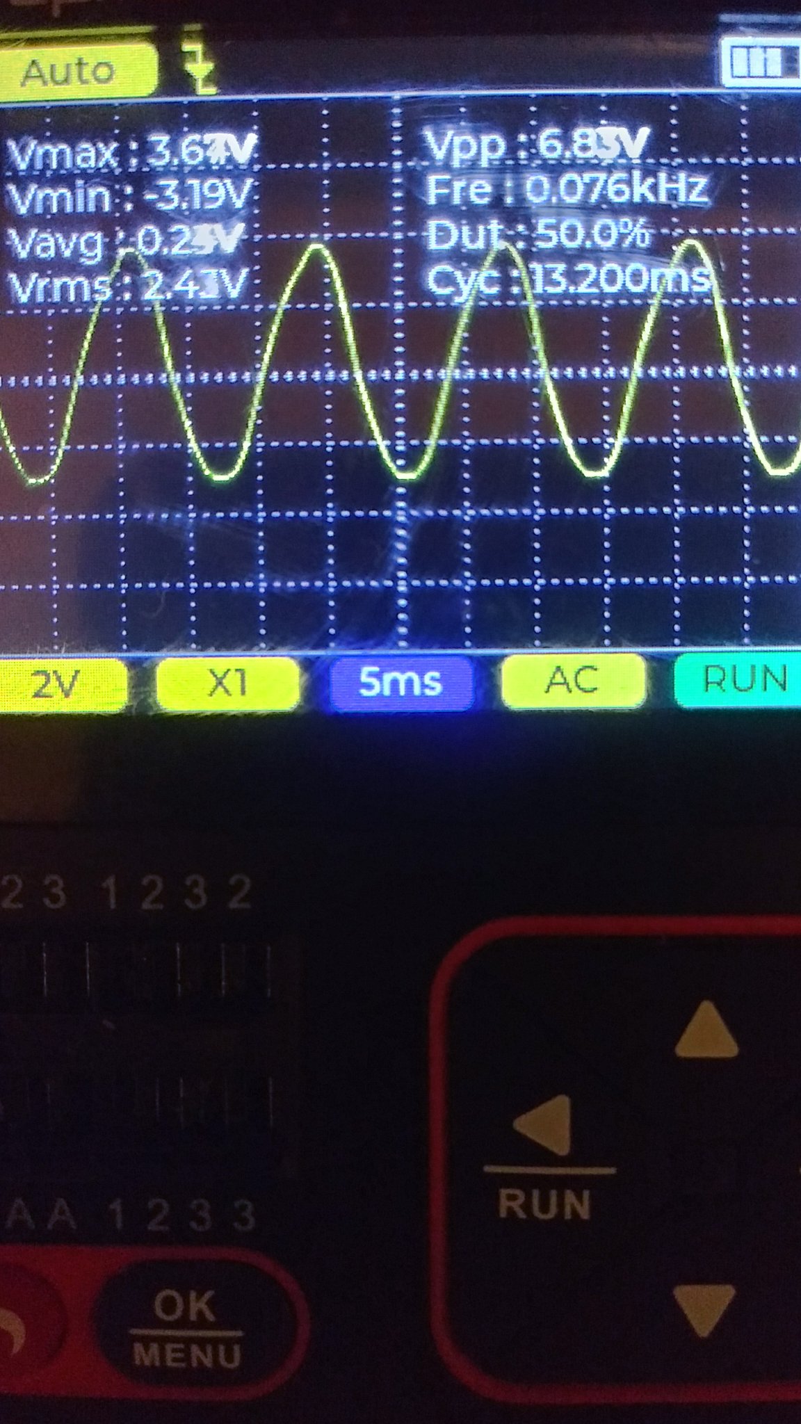

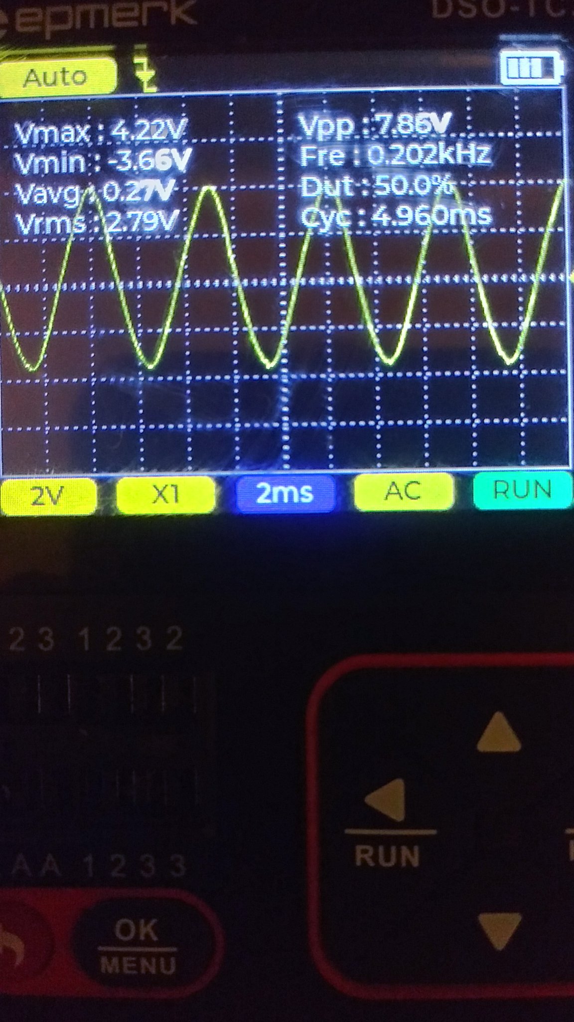

PLEASE ADVISE ME ...I bought Krell 400xi I am considering to hold it or give up and send back.. I notice 30Hz 4dB lower sinusoidal signal compare to 1 KHz and more on 20 and 15 Hz.
Channels difference at 1khz is at preamp section 0.0dB but on speakees posts 0.2dB but at 30 Hz both channel difference is 0.7 dB . power section non polar input 47uf capacitor right is 43uf left is 46uf . MAIN PROBLEM IS : ON OSCILOSCOP AT AVERAGE VOLUME LEVEL 1kHz sinusoidal wave is fine but below 100Hz looks like cut out tops and buttoms 30hz worse. . IS SOME SEMICONDUCTORS BROKEN OR INPUT NON POLAR CAPACITORS COUSE SINUSOIDAL WAVE TOPS AND BOTTOM WITH DOUBLE BUMPS PROBLEM? I AM NOT TOO EXPERIENCED WITH OSCILOSCOP . AMP SOUND WITHOUT STRONG BAS BUT JUST REGULAR.

These toy integrated, smd-ed Krells always terrified me. As there is a VC section, one would first need to isolate this, just in case, and take measurements at the actual power amp input.
IMO the most likely culprit for the reduced output at LF would be a dried out NFB decoupling cap if such exists. Not even sure if there isn't a servo in this model.

I meassure preamp section output and Both channels plus and minus output are perfect ... but output measuure before and after output ressistors in Right Differencial plus is 20% louder than differencial minus! Simillar Left channel . Its mean its overloaded or bipolar feedback capacitors make short for frequencies below 100hz .... ???? please help me with this . I know how play original krell 400 with ts positive and negative aspects ....compare to mark lewinson 4808 but i need to fix mine.
