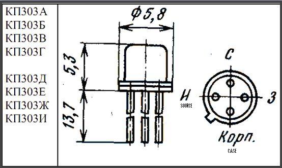

KP303 fet bought on ebay--pins details needed. The attached photo has designation in Russian and would someone help me to decode which one is: source-- drain-- gate-- case-- Thank you.

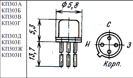

alex mm Member Joined 2006 2010-07-24 8:54 am #2 2010-07-24 8:54 am #2 .... it's all I know about KP303 ..... 🙂 Attachments KP303.jpg 34.1 KB · Views: 159 index.pdf index.pdf 155.7 KB · Views: 157 M Mikewong Member Joined 2003 2010-07-24 9:33 am #3 2010-07-24 9:33 am #3 Thank you for your attached file but it didn't solve the pins designation in english. и=Source с=Drain з=Gate корп=Case Are the equivelent correct? What's the noise figure of this low noise type fet? Last edited: 2010-07-24 9:50 am Status Not open for further replies.
