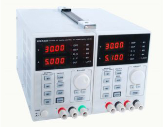

I decided to answer my own question. I purchased an KA3005D-3S from SRA Soldering Products.
The KA3005D-3S is pretty obviously two KA3005Ds in one chassis. Fair enough. In addition, with the dual supply, you get an unmarked +5 V, 3 A supply as well.

The supply section on the left, I'm sure, is an unmodified KA3005D single supply. The supply section on the right has the +5 V output added and has some of the buttons repurposed for additional functions: Series (SER) and parallel (PARA) modes. Hold in the SER button for a second or so, the supply goes beep, and the SER LED lights up. Then connect the load (+) to the red terminal on the left supply section and the load (-) to the black terminal on the right supply section. Dial in the voltage on the right supply section, but note that you get twice the voltage indicated on the display. Similarly, the PARA mode allows you to connect the two supply sections in parallel. Connect the load to the terminals on the right supply section and dial in the voltage and current there. Note that you get twice the indicated current. These features are a little clunky, but if you keep in mind that you're dealing with two supplies in one box, it sorta makes sense.
The beep sound is rather anemic. Not a big deal and you can turn it off ... but only on the left supply section as the BEEP OFF button has been repurposed on the right supply section. That's truly one of those, "really?!" kinds of moments.

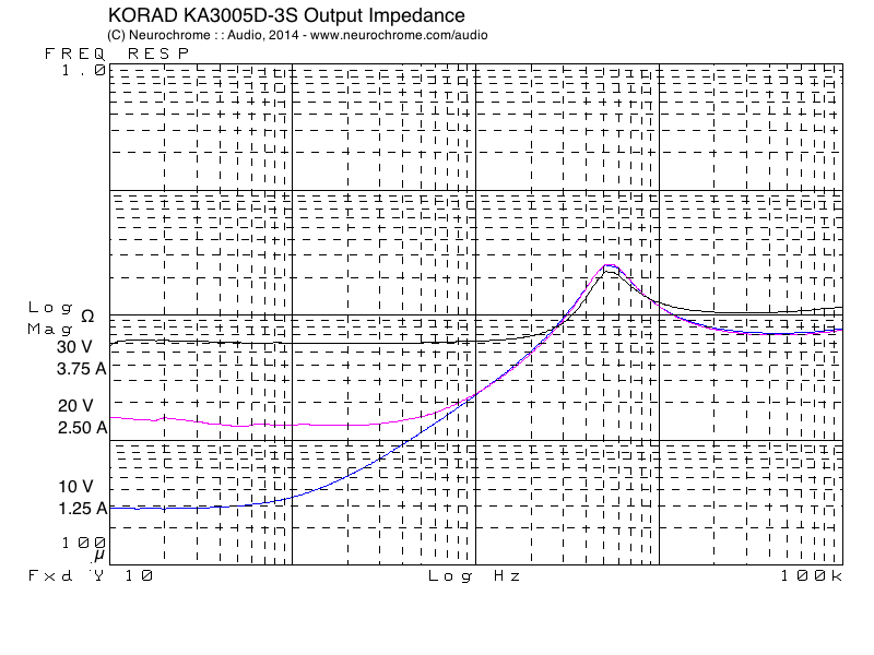

The output impedance is nice and low. It varies with the load current, as you'd expect, and shows good stability of the control loop (no high-Q peaking). Except for a hump at 5 kHz, the output impedance is below 10 mΩ for all the voltage/current combinations I tested (see attached plot).

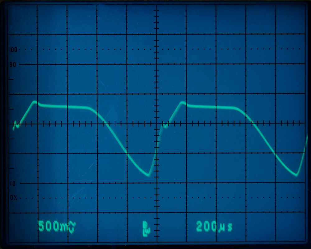

Hmmm... Apparently, small-signal output impedance is one thing; large-signal output impedance quite another. Attached is a scope shot of the supply ripple when the Korad is loaded by a class AB output stage providing 1 kHz @ 40 W into a 4 Ω load (4.47 A peak; 1.58 A RMS). Pretty pathetic...
I think this one goes back to SRA...
~Tom
I was surprised too. I'm guessing the micro controller used for the display handles the voltage regulation as well and flat out runs out of bandwidth. The output voltage actually increases by about 0.5 V under these load conditions. I put a 1000 uF cap across each output, that helped some. Above scope shot was done with the 1000 uF in place.
I guess I'll be building my own supply. It's not hard. It's just time consuming.
~Tom
My guess from the waveform is that the Korad has a slew rate limitation in the control loop. The downward slope may be the control loop failing to turn the pass transistor/MOSFET on fast enough as the class AB output stage current increases. Then the output stage current falls and the ouput recovers.
My guess is that they have used a power stage with gain such as a PNP transistor or P channel MOSFET to keep the drop out voltage to a minimum. Then used high value capacitors (but low current control circuit) to keep the voltage regulation loop stable.

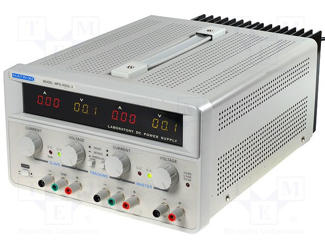

It looks near as makes no difference identical to this one from GW Instek (but then with 4 instead of 2 displays):
We have several of these at work, and they are 15+ years old and still going strong. No problems.
Some of them actually are rebranded as Tektronix, so should be good enough to be sold under that well-known brand...
That exterior is found with a variety of internals, so its quite possible they purchased the guts for a Korad supply and used those externals. It's also equally as likely that they just copied the model number style and there is no relation at all. The single channel version of this exterior is even more copied and the internals vary heavily in quality. It's not at all an uncommon practice in cheap power supplies. Get the guys from one discount firm, the shell from another. Whoever gives the cheapest price. I can promise that this supply is not rebadged as a Tek.
That exterior is found with a variety of internals, so its quite possible they purchased the guts for a Korad supply and used those externals. The single channel version is even more copied. It's not at all an uncommon practice in cheap power supplies. Get the guys from one discount firm, the shell from another. Whoever gives the cheapest price.
Of course I can't be sure that the internals of the Matrix (hmmm, that somehow sounds familiar) PSU are the same as the GW Insteks and Tektronixs we have at work.
Maybe not the Matrix, but certainly the GW Instek from my previous post, we have several of these:
To me these look like GW Insteks with a Tek badge... And why not? The quality of them is fine.
I delved a bit deeper and found some tear down pictures on a Polish website of a smaller Matrix PSU (MPS-3005S).
If the dual MPS-3003L-3 is anything alike, then I can tell you that the internals of the Matrix are definitely different from the GW Instek/Tek models from my previous post. They may have it made to look like it (esp. the pattern of the ventilation holes in the cover had me fooled), but it certainly isn't.
Next week I'll have a look inside the GW Insteks and Teks at work, and maybe take a few pics for comparison. But remember, these are 15+ years old.
