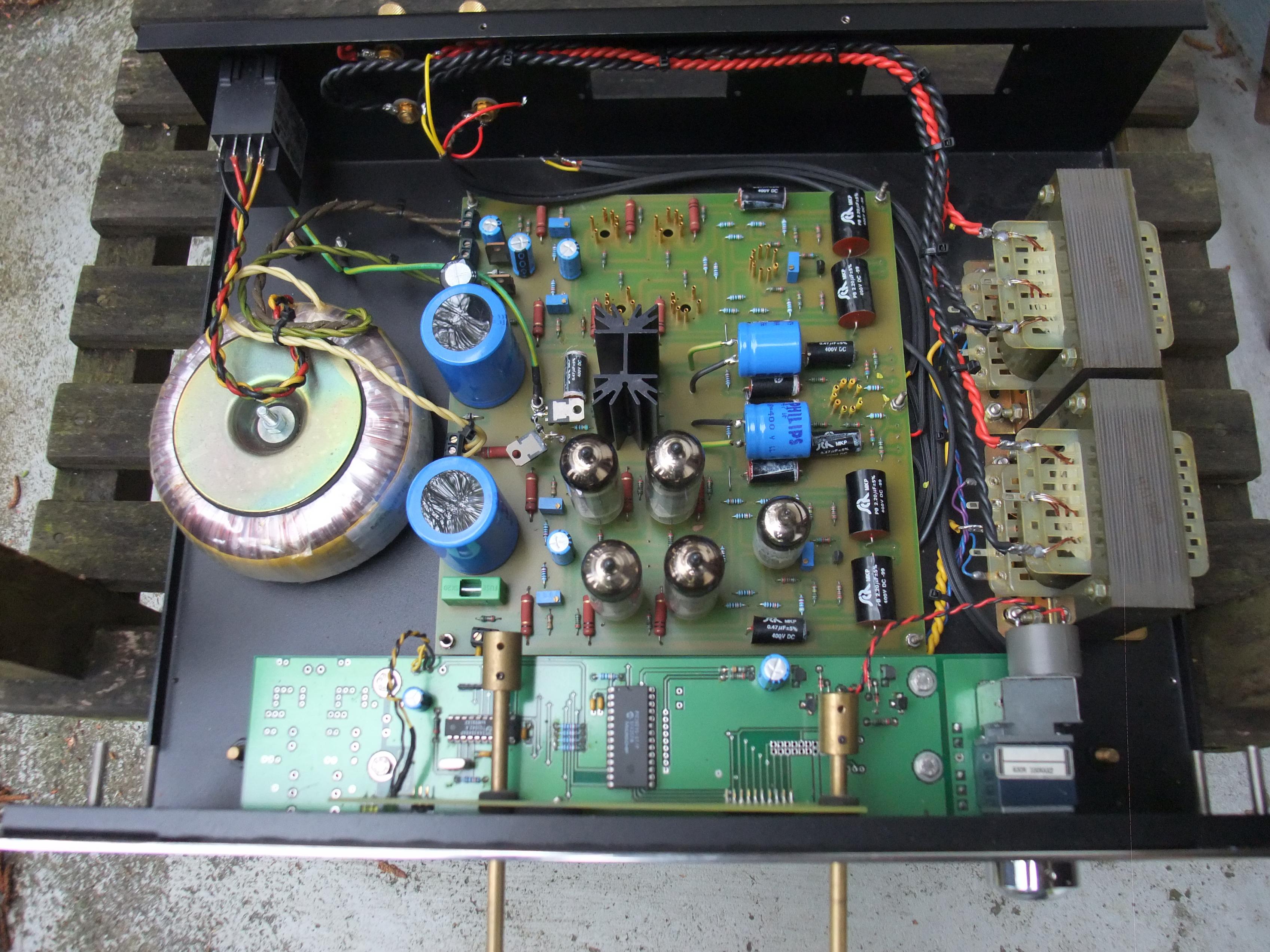

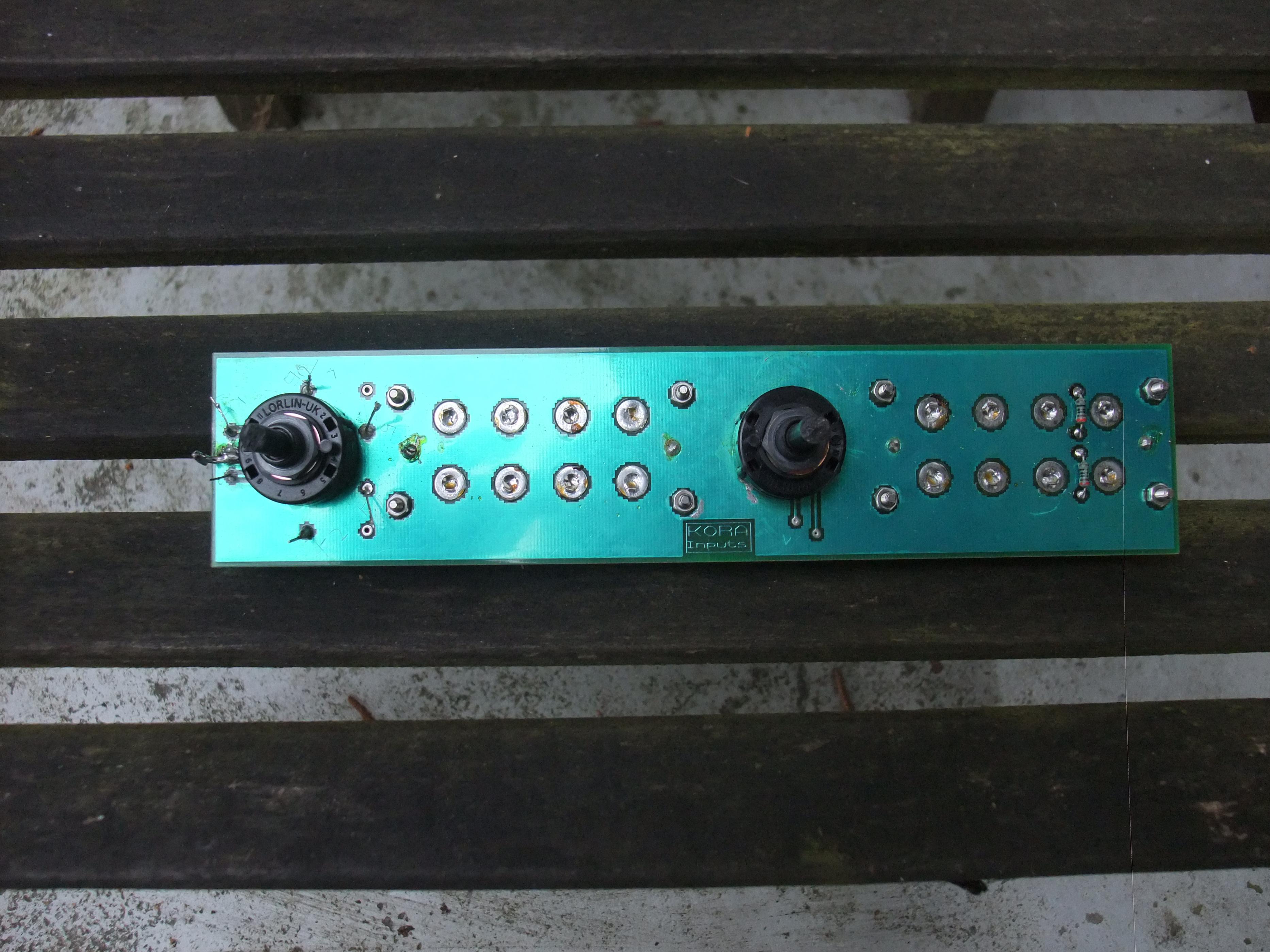

KORA Mercury Schematic Diagram - LORLIN Rotary Switch replace by ELMA 04

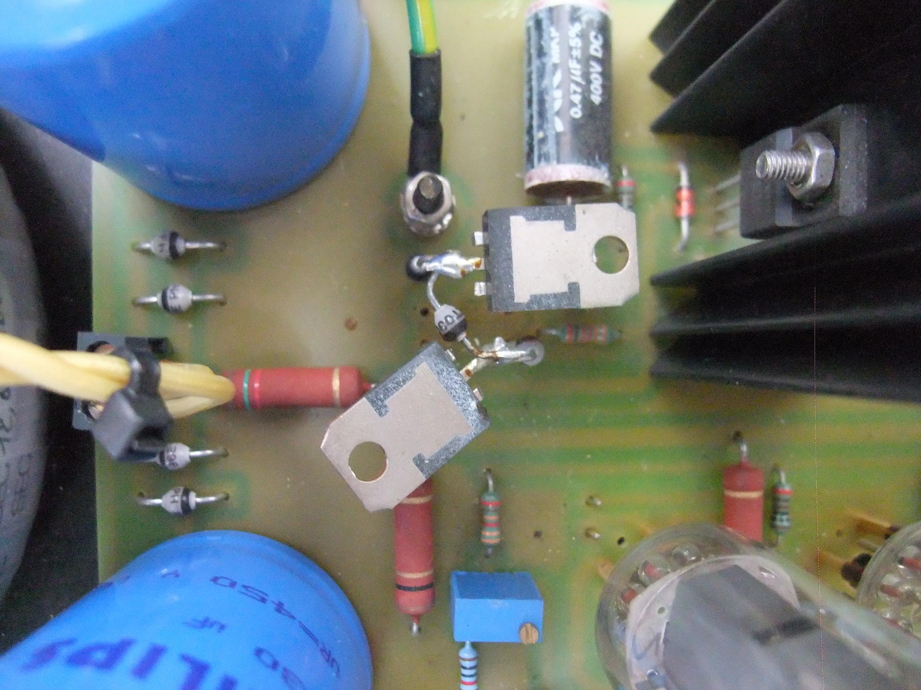

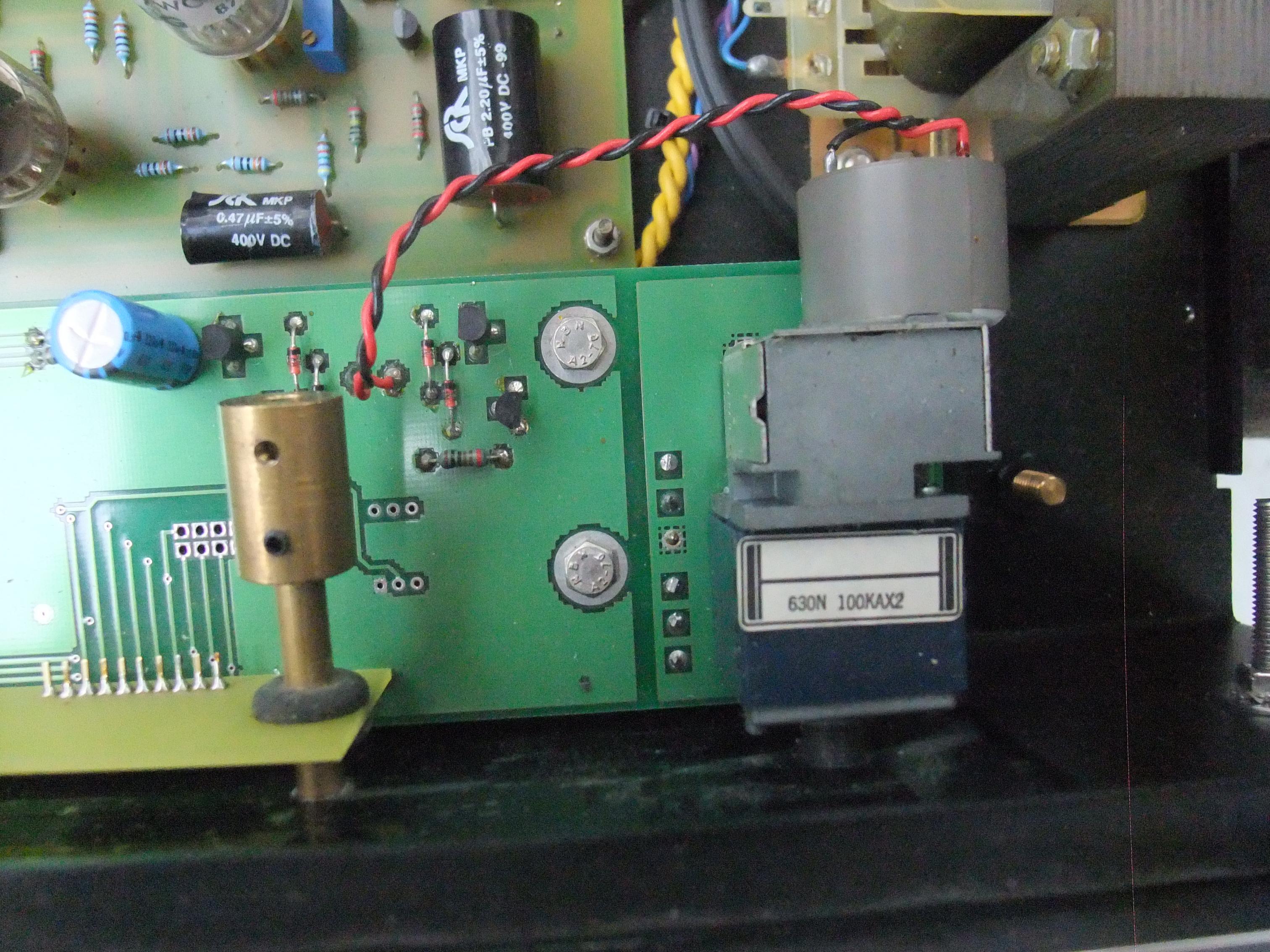

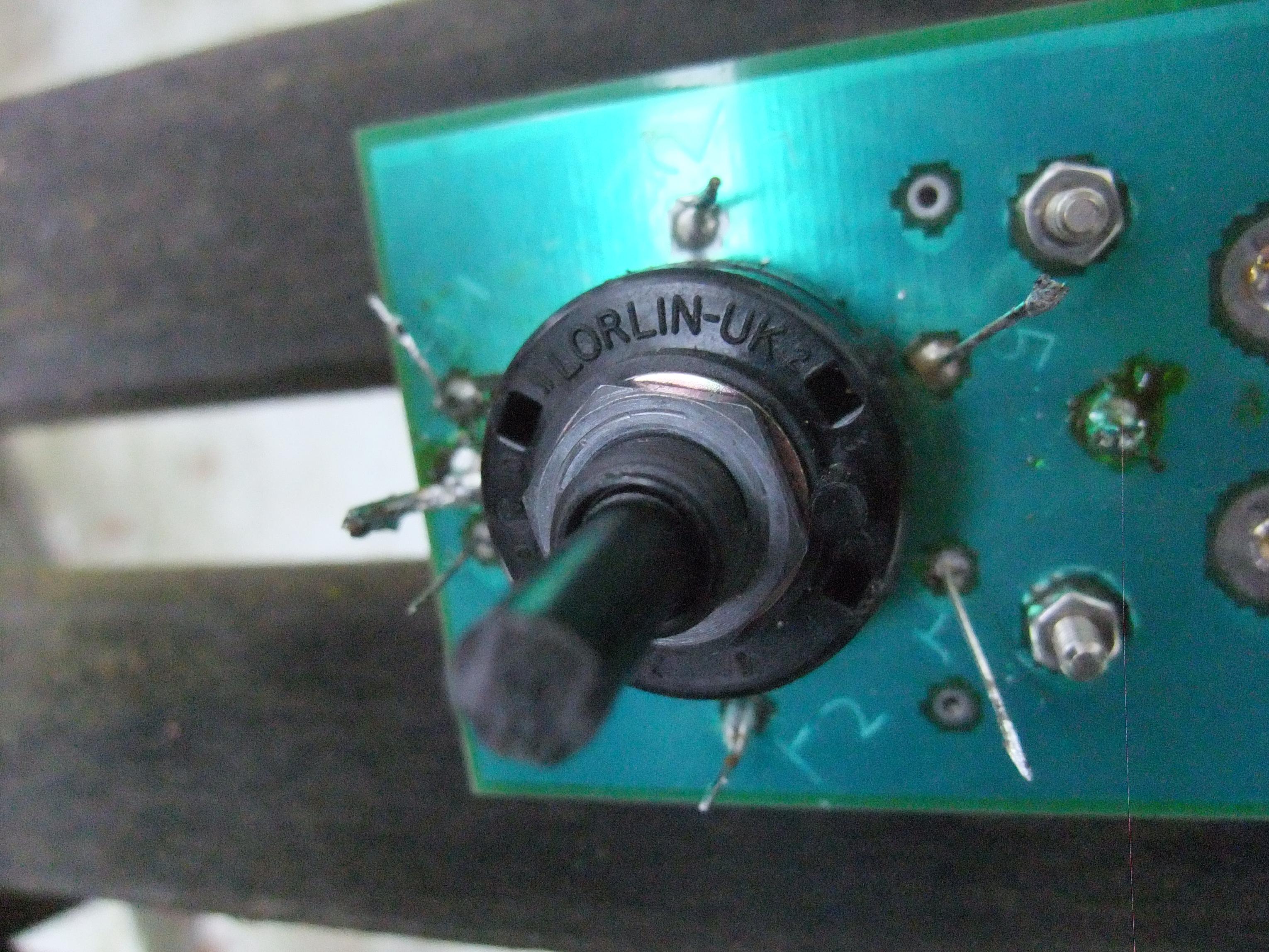

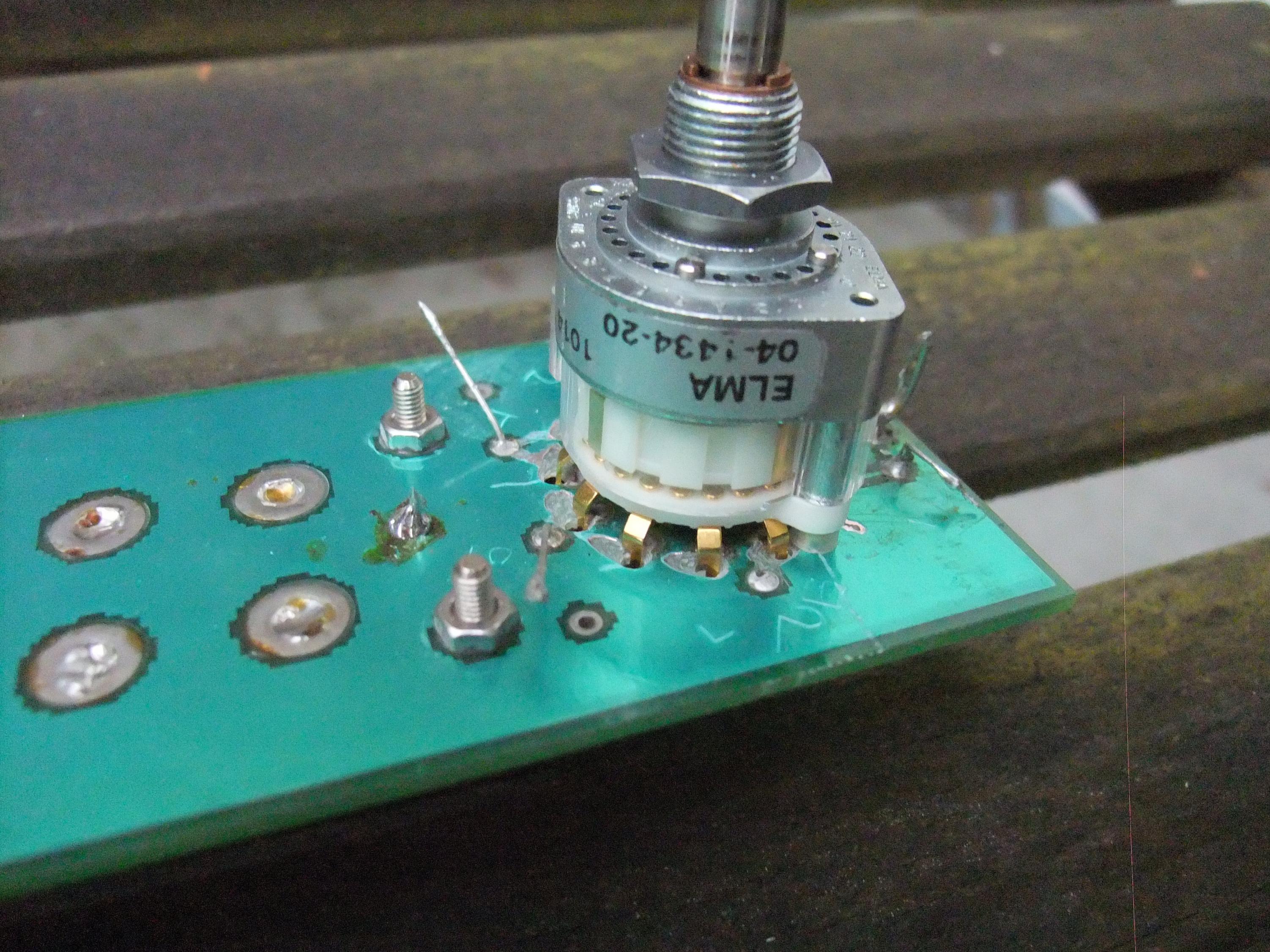

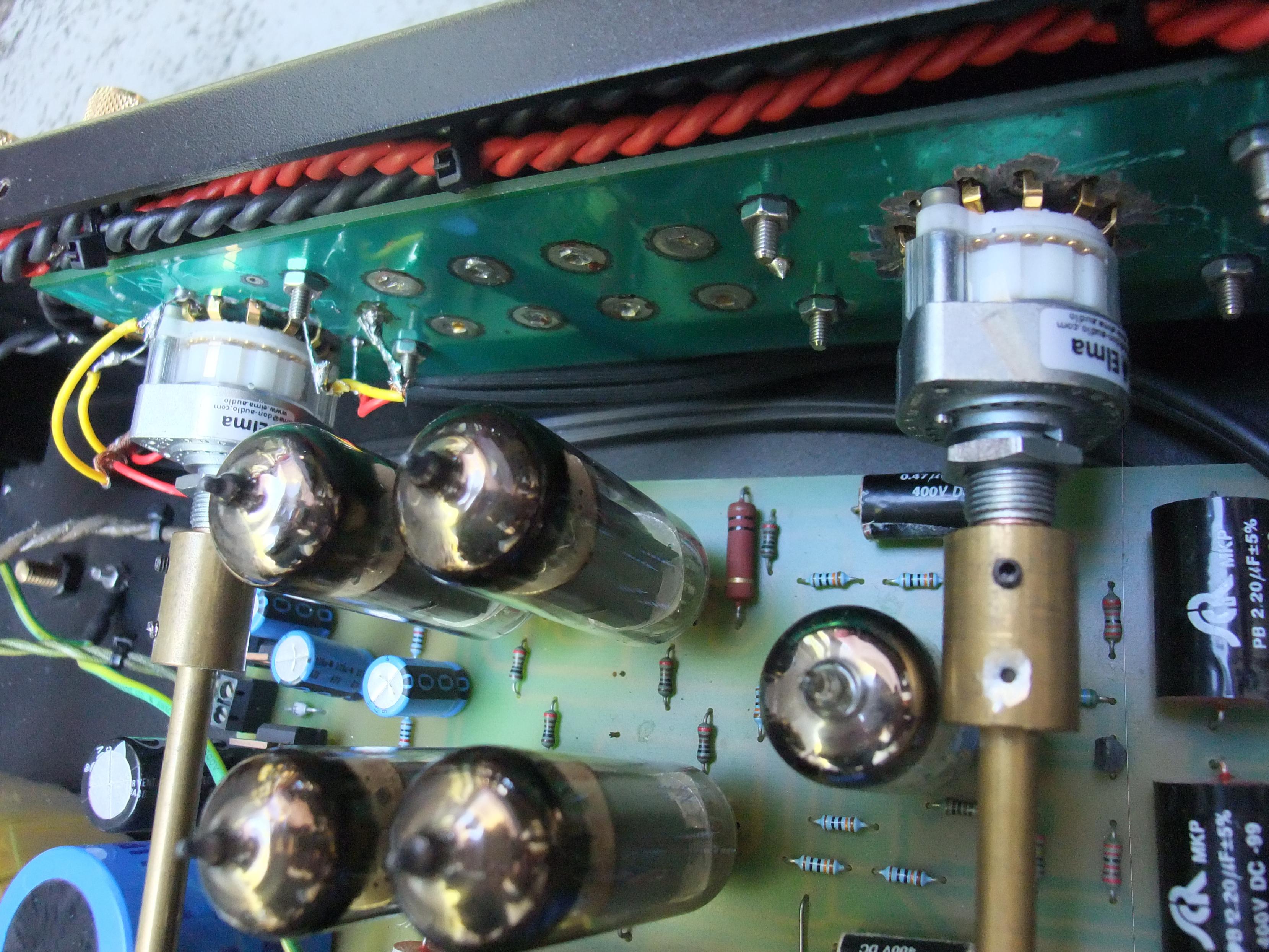

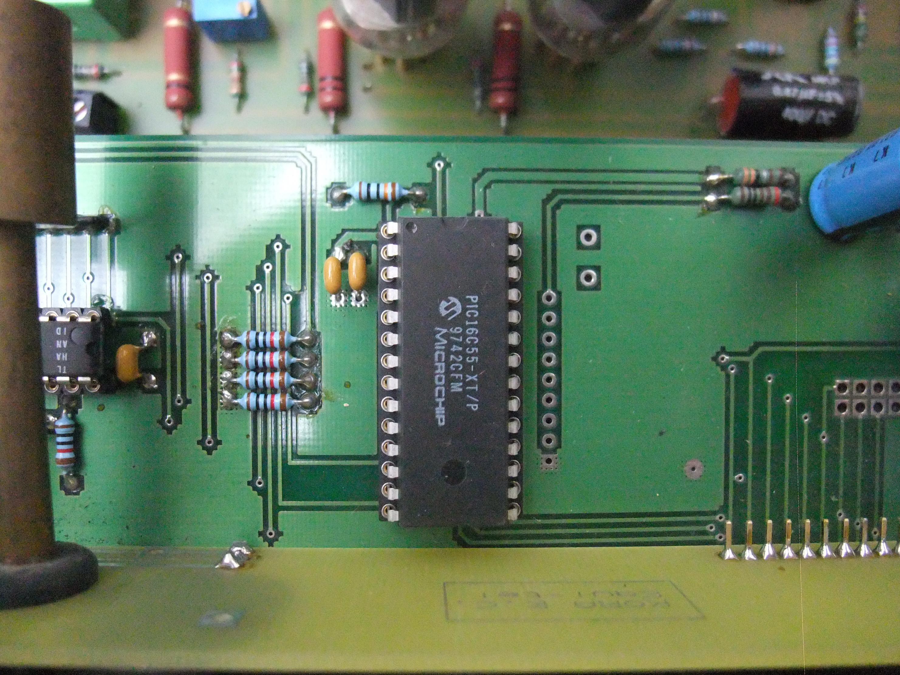

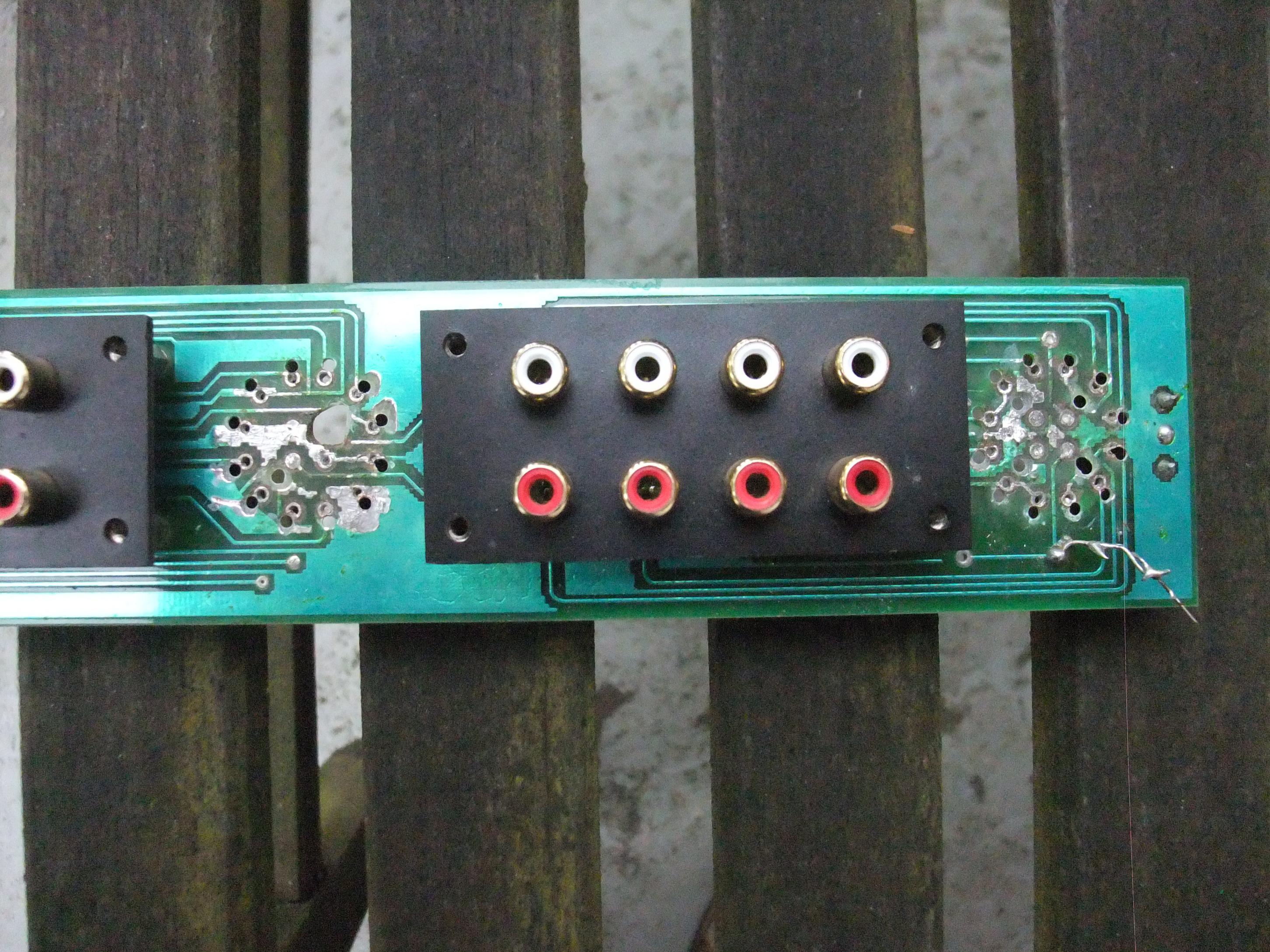

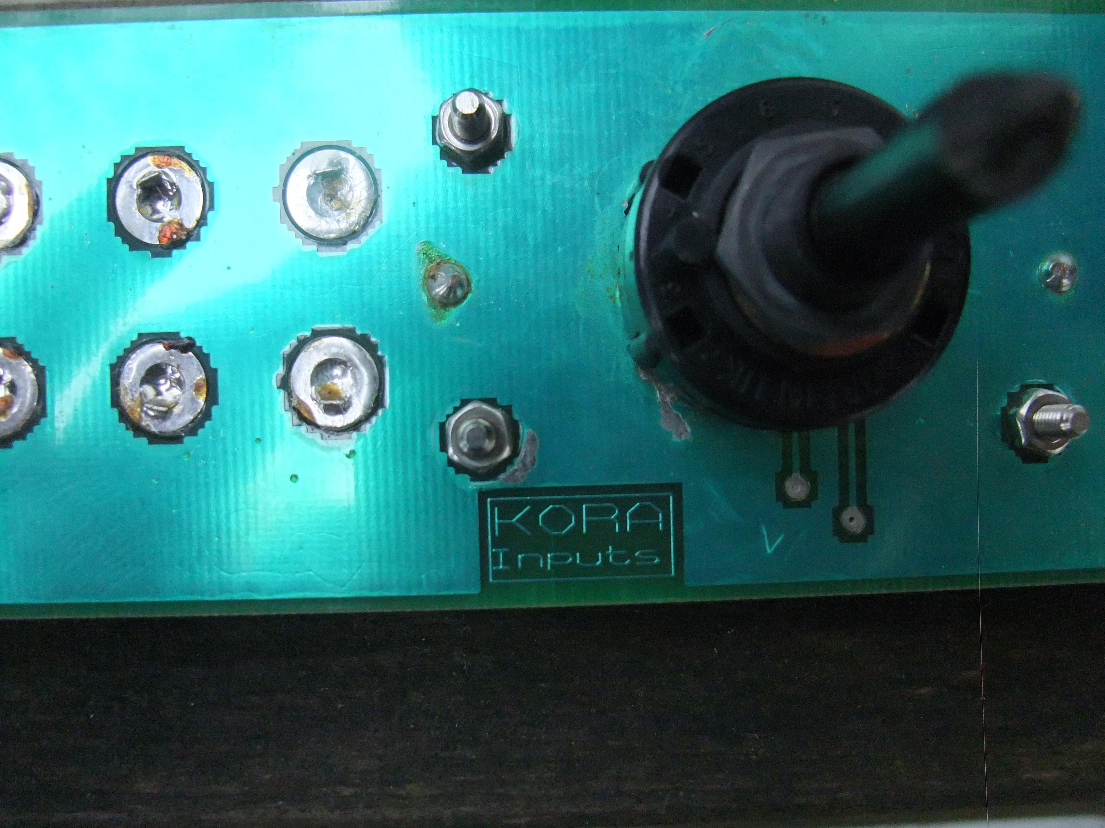

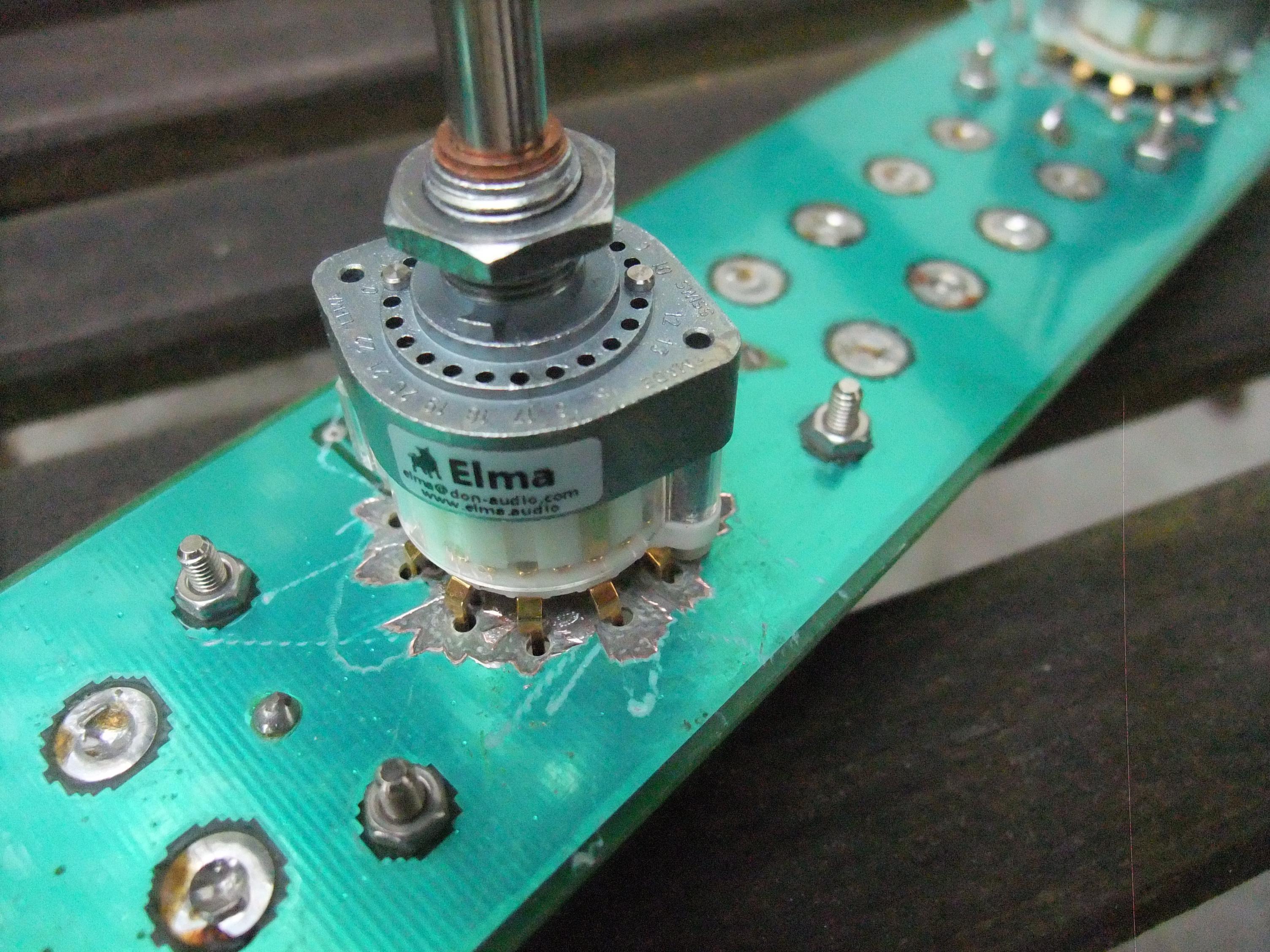

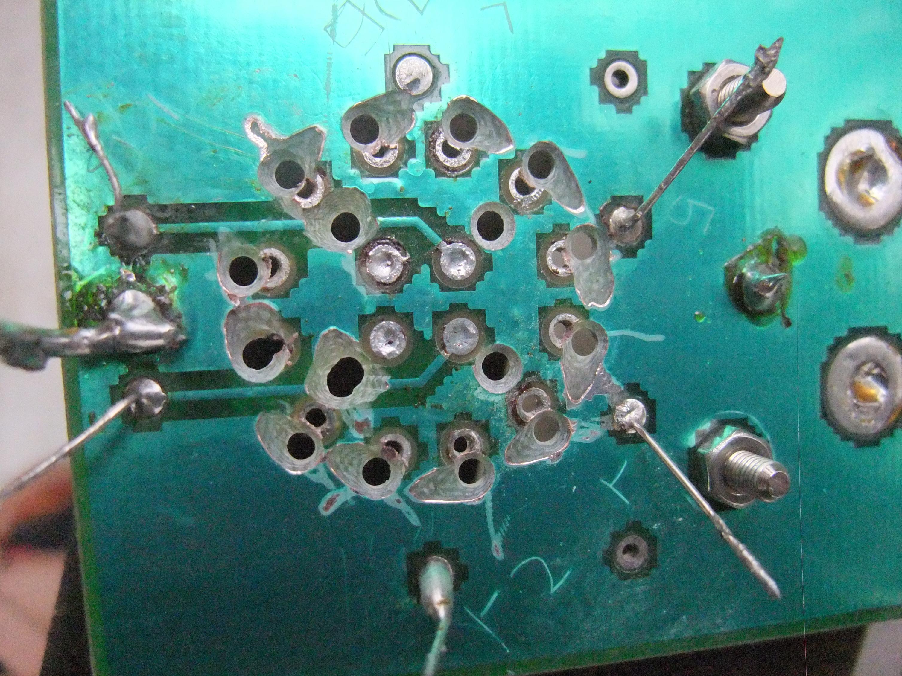

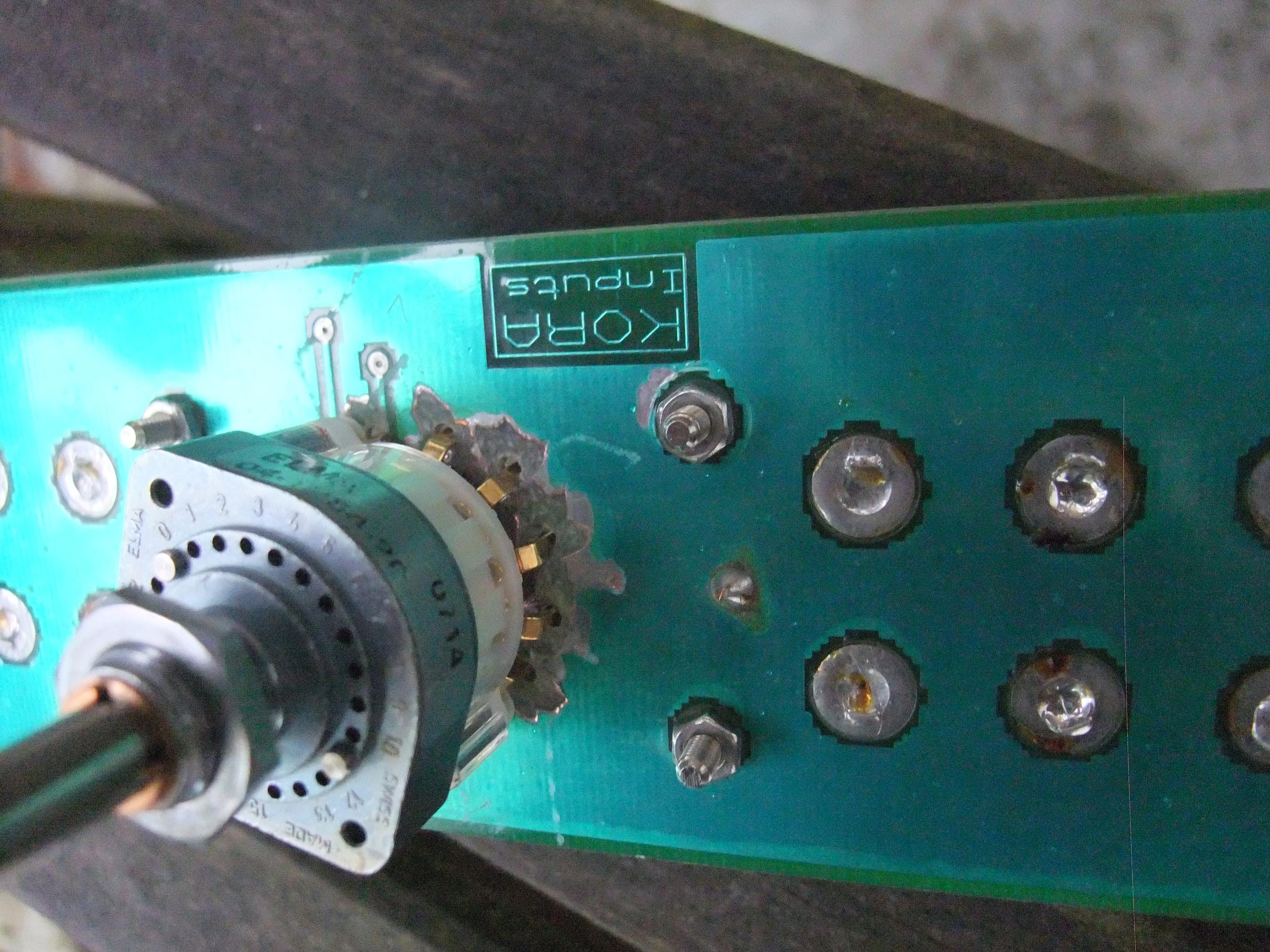

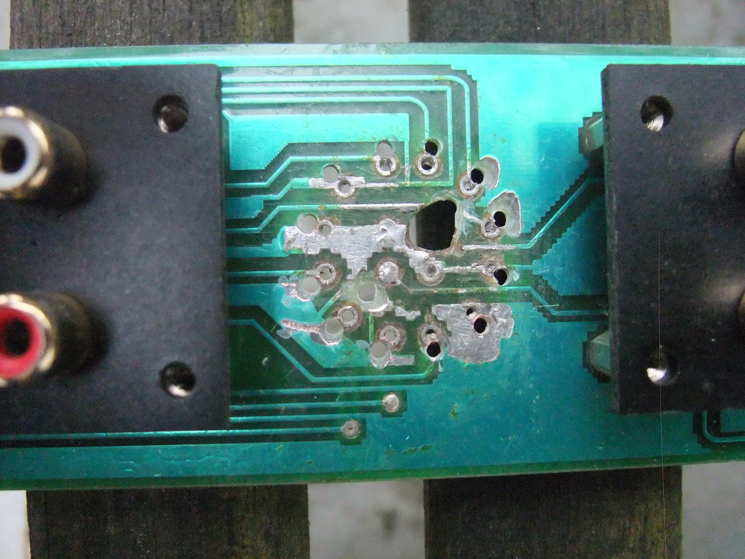

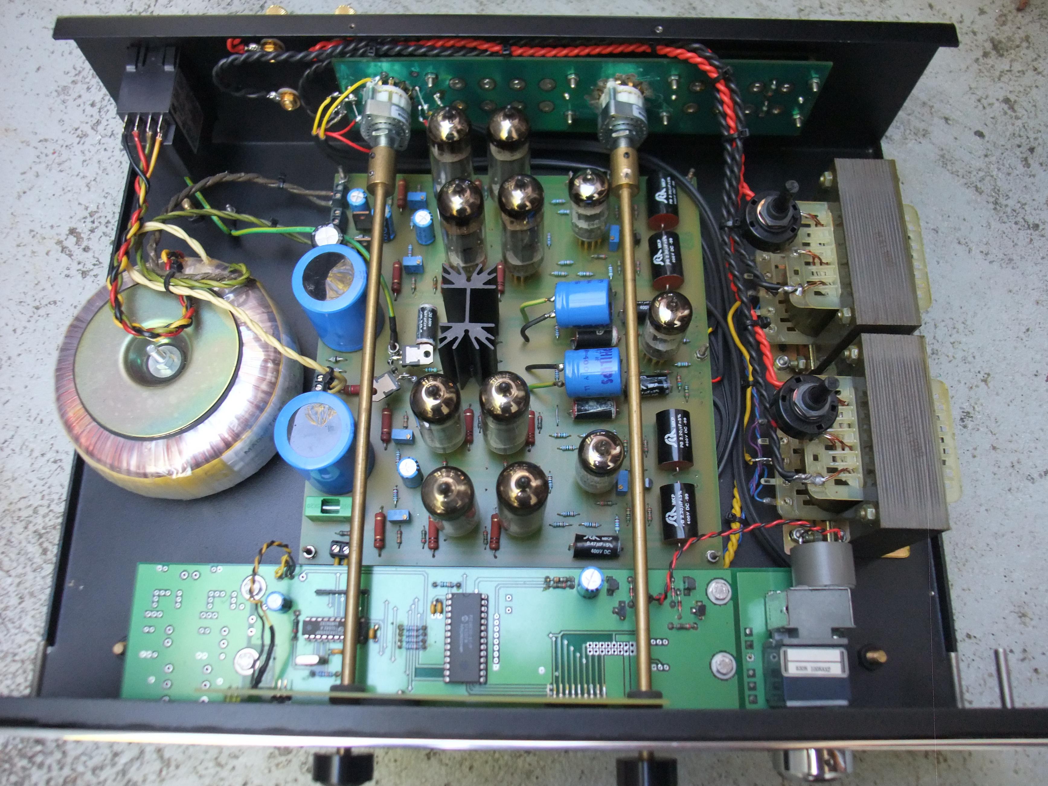

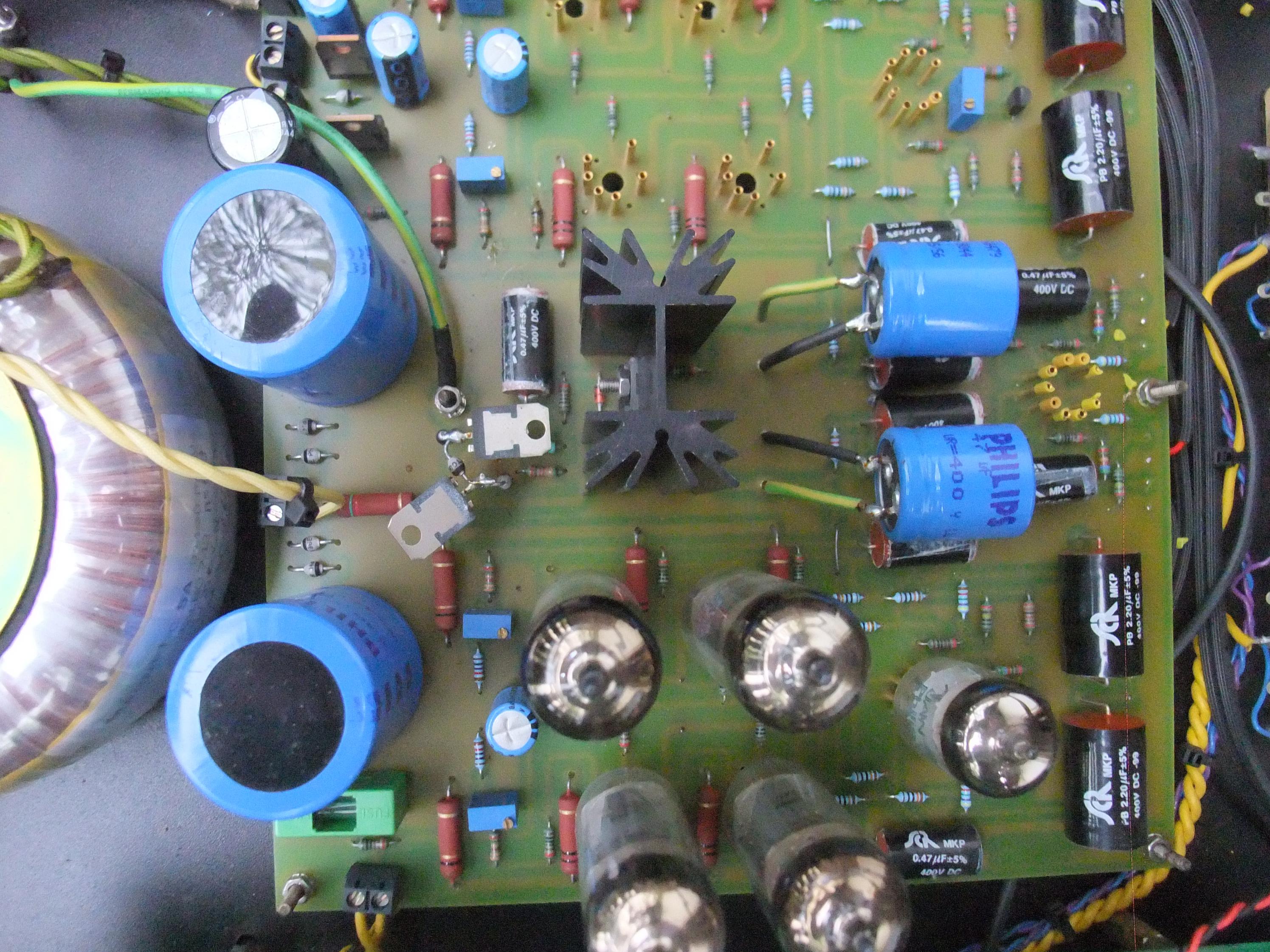

This very fine sounded integrated amp uses only very cheap plastic rotary switch from LORLIN with very bad reliabiliy.

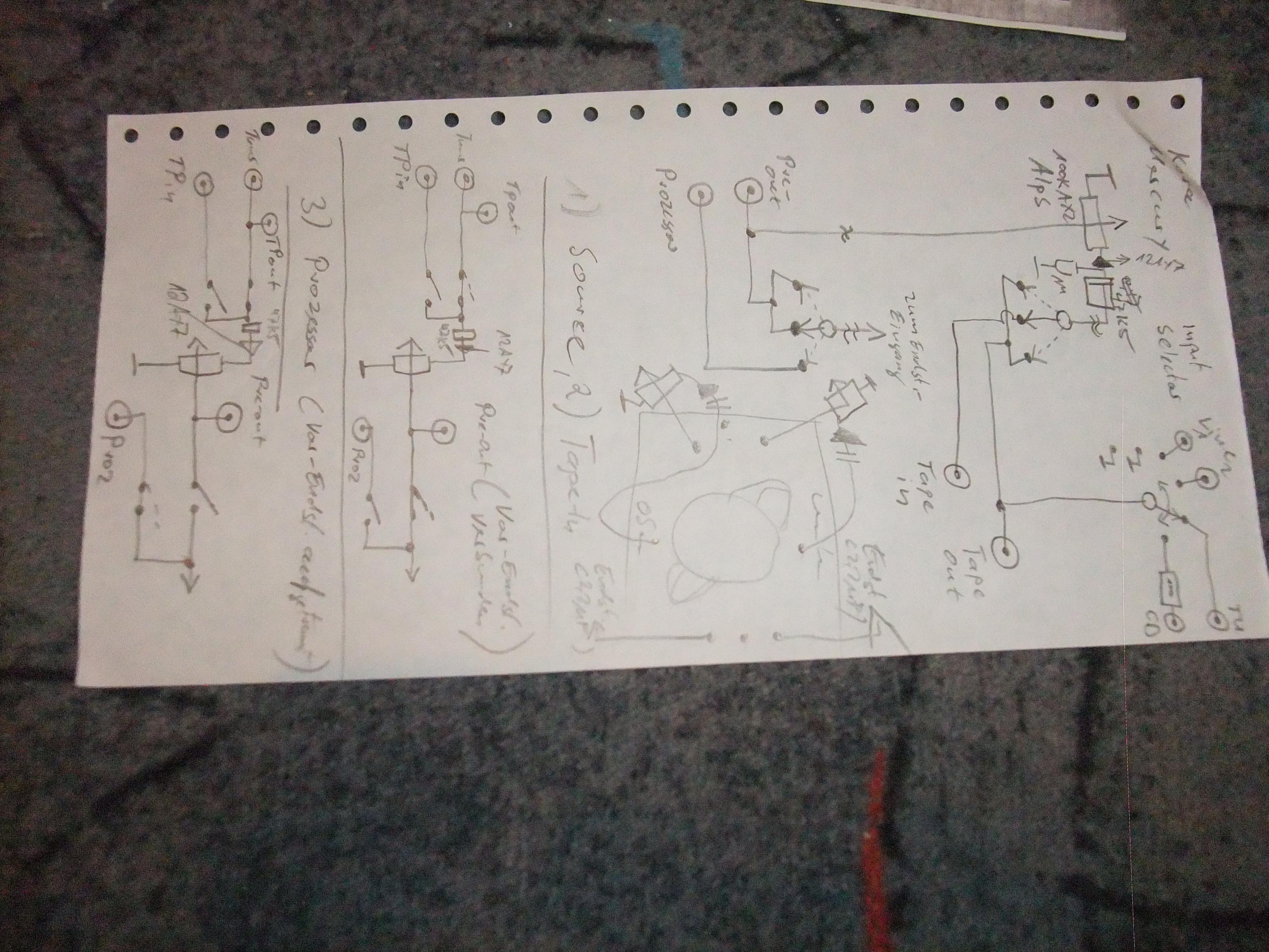

Replacing was necessary. I have made some images of this procedure. First pic is the schematic diagram, ceated already some time ago (unfortunately without the RC receiver unit - maybe an other member have create this for upload here) - until now not to find on the web - so I think.

Rotary Switches, old and new
The images therefore
