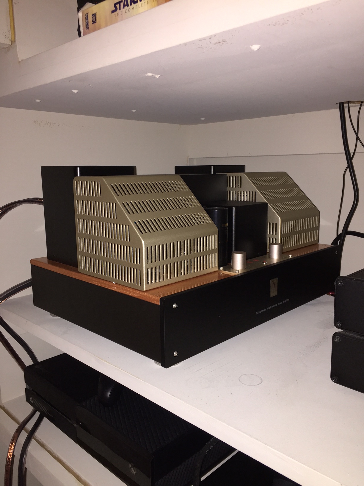

Yes, here are the photos, sorry:
Ok. Thanks for the images. I assume that amplifier has a lot of electrolytics? Their lifetime goes down with a rise in temperature. That also explains that 30 minute warm up time they give. I haven't built amplifiers with electrolytic caps in a while but I remember I had a phono stage that had some Black Gates (which I can't stand but to each their own...) and after the first side of an lp the following ones always sounded better. I did measure the caps later on but don't properly remember what came out; I believe ESR went down after them getting charged.
