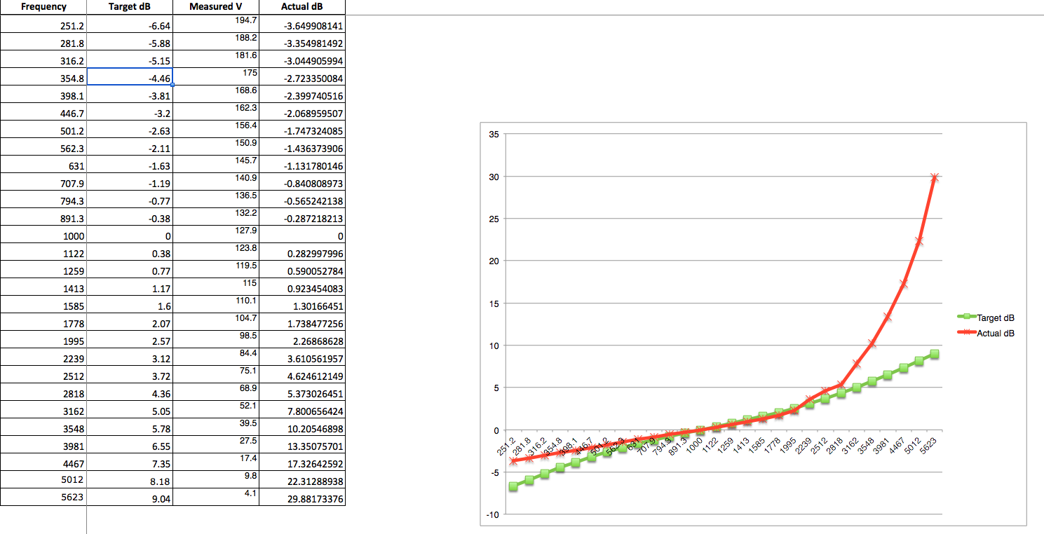

OK-- so I've noticed that I seem to be getting a lot of sibilance with the Tetra Sans (measured vinyl tracks against corresponding iPod tracks and the difference is sibilance!). I set up a little test lab with a multimeter, an Online Tone Generator and a spreadsheet containing dB gain / loss values I found from Hagerman Technologies.
I used the dB levels he provided for his inverse RIAA as the basis for the dB steps I should get with the Tetra Sans. I played a test tone through my mac and into the RIAA and recorded the change in voltage, which I converted to a dB change with the 1K voltage as the V0 reference (20*(log(v1 / v0))) and noticed that my RIAA looks jacked up.
Here's a screen grab of the dB actual vs. target and the discrete values. It seems unlikely to me that it's THIS off, so I'm guessing I'm measuring wrong somehow.
Any help would be appreciated.

An ordinary multimeter may give innacurate readings for frequencies other than 50/60Hz. Also, are you sure you're not overdriving the phono input?
For c7/c8 I have about .1uF and for c9/c10 I have something around .0340uF. R7 is about 22.1k and r8 is about 3.18k. All 12at7s.
For testing I was able to get the inputs down to about 5.4 mc. That's why I used the laptop. I was able to get the voltage lower when using my Mac for signal input.

Sibilance might be from your phono cartridge. I've noticed the same issue with some records.
The RIAA phono amp boosts the base and reduces the treble. During record cutting, the bass is reduced to minimize the swing of the cutter. The treble is boosted to increase the signal over the surface noise of the record. During playback, the bass is boosted back up, the treble back down.
Easiest way to measure is to build his reverse RIAA circuit and plug it into your phono amp. Set a signal generator to get a reasonable output for your true RMS multimeter and sweep from 20Hz to 20kHZ. The reading should stay close to constant across that range.

You know, that's exactly what I thought. So I actually bought the inverse RIAA from Hagerman with the intent of doing just that. Then I put it somewhere in the house. And now it's gone.
Kofi loses things.
Anyway, I'm working on the cartridge as well. It's a brand new Denon DL 103r. I've added some weight to the headshell and installed the Michell Technoweight to my Rega RB250 on my Thorens TD160. With the new counterweight things are much improved but I am also thinking about repotting it in a Paradox body, but the Technoweight may not have enough mass.
I'll report as I make progress. Thanks for the replies.

In principle, you can just print out the correction curve from somewhere like this: RIAA Equalization
Then plot your actual gain curve of input/output (in dB) on the same graph. The problem is that the curve covers a range of 40 dB. With digital gear, it depends on the resolution. Still, if you measure input vs output at each point along the curve, you'll see if you are close.

Thanks. That's what I thought I was doing in my earlier post. If you look at my measurements it looks like I'm way off, but I don't think I could be that far off. MerlinB suggested that my Rat Shack multimeter might be at fault since its accuracy may depend on a 60Hz frequency. If you look at my attachment above you can see how whacked out my measurements are.
