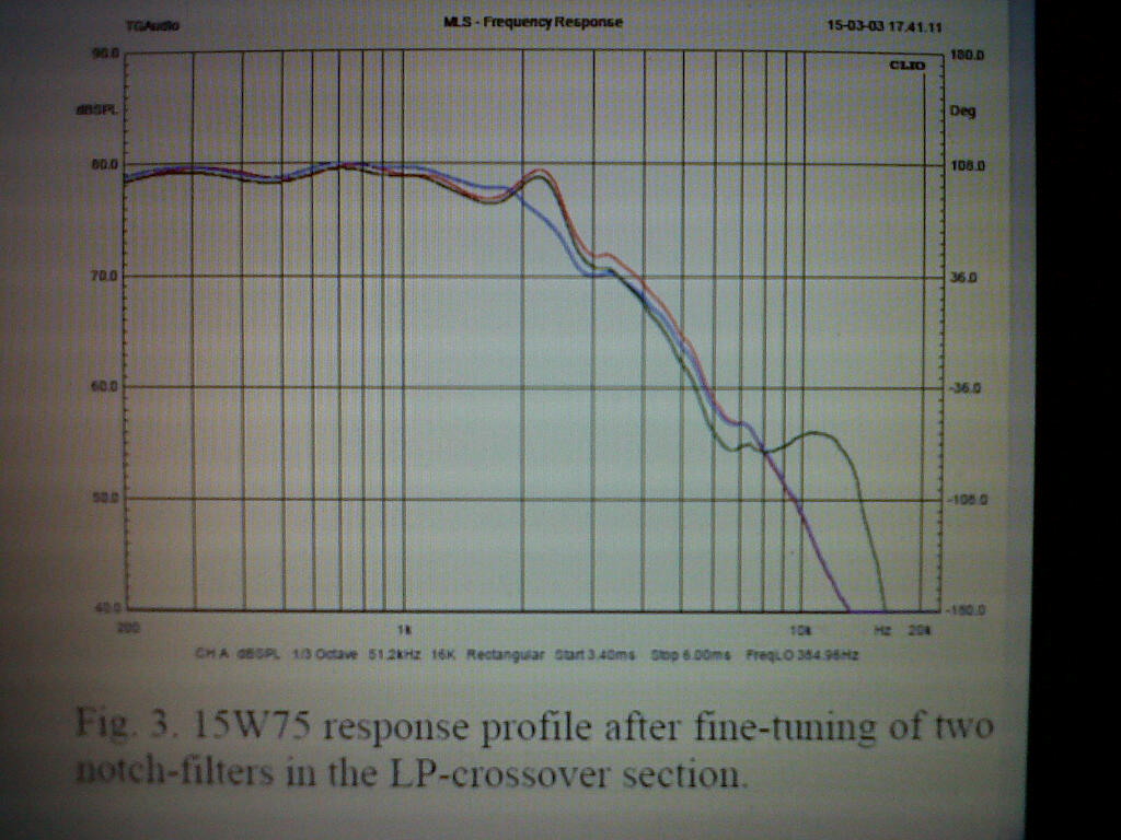

The 15W75/MW150 is a particular “troublesome” driver as it has two intrinsic resonances
that have to be taken care of in the crossover design. I have been testing the drivers in
a two-way design with the Esotar tweeter and got a very nice response profile – and a
quite complex parallel crossover.

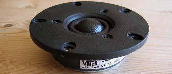

Fig. 2. Vifa DX25TG-30-04 tweeter.

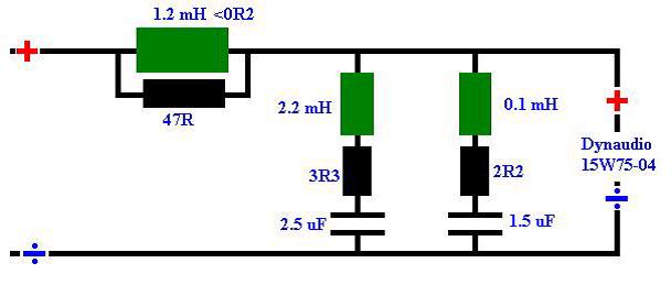

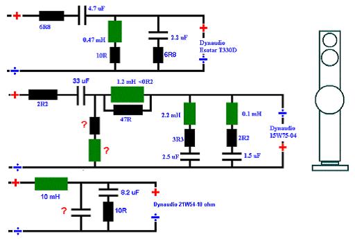

The crossover looked like this:
Fig. 4. 15W75-04, 12 dB/octave crossover design for 3-way system.
The inspiration for this design came from John Kreskovsky . Unfortunately this
two-way design (Morel tweeter) is no longer available from his website. I had
to fine-tune the crossover for my 4 ohms version where John’s were based on
8 ohms drivers.
The HP-section of the crossover shown above is without some component
values, as I never got around to implementing this 3-way design.

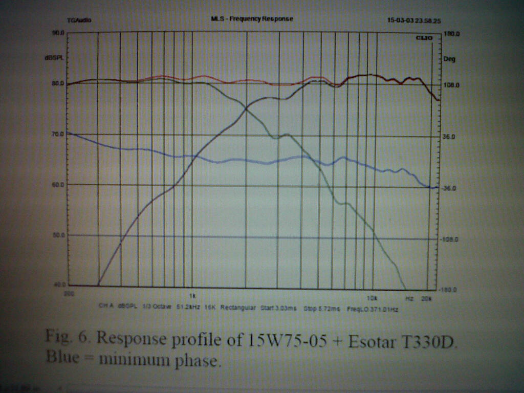

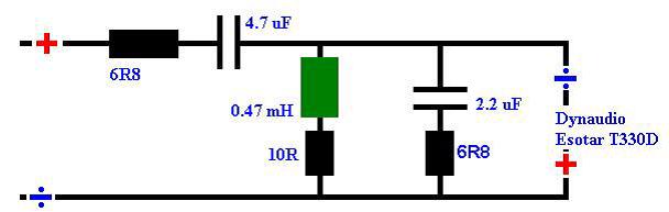

The two-way 15W75/Esotar T330D system was like this:
Fig. 5. Crossover design for 15W75-04 + Esotar T330D.
Fig. 6. Response profile of 15W75-05 + Esotar T330D.
Blue = minimum phase.
Quite a nice, almost perfect 12 dB/octave response profile. And good sounding
too I should say. Maybe a little bright-sounding due to the very flat response.

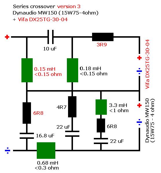

Based on the recent W11 and SP95 construction I couldn’t help trying something
completely different from the Esotar set-up and a couple of series crossovers later
I ended up with this:
Fig. 7. Dynaudio15W75-04 + Vifa DX25TG-30-04 series crossover, version 3.

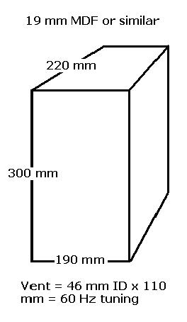

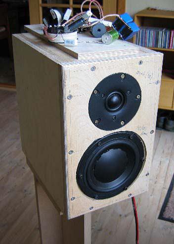

A test cabinet was available and has the following dimensions:
Fig. 8. Cabinets for the Koapong speaker. My test cabinets are made from 20 mm
Baltic birch as can be seen from the pictures. These test cabs are somewhat deeper
as they are meant for housing a wider range of drivers giving 6-10 litre volume.
Fig. 9. Koapong test cabinets, 7 litre net volume.

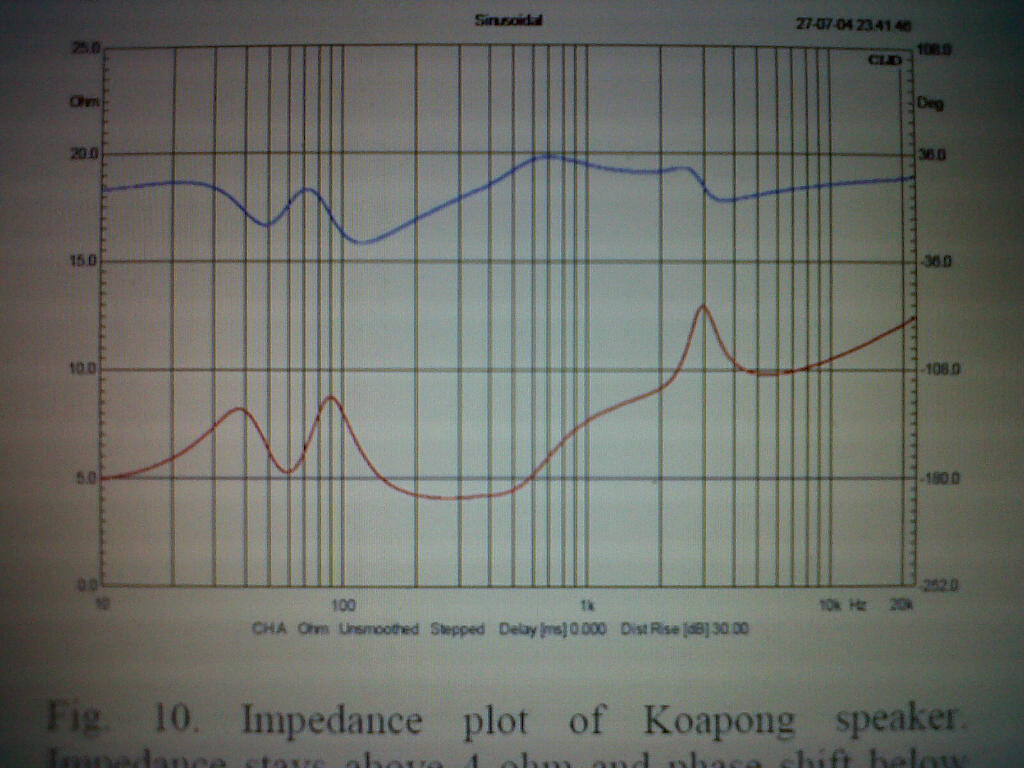

Fig. 10. Impedance plot of Koapong speaker. Impedance stays above 4 ohm and
phase shift below 100 Hz is moderate making this an easy speaker to drive. Actually
my Copland CTA505 valve power amp loves this speaker – best from the 8 ohms tabs.
As can be seen the vent tuning is around 60 Hz,

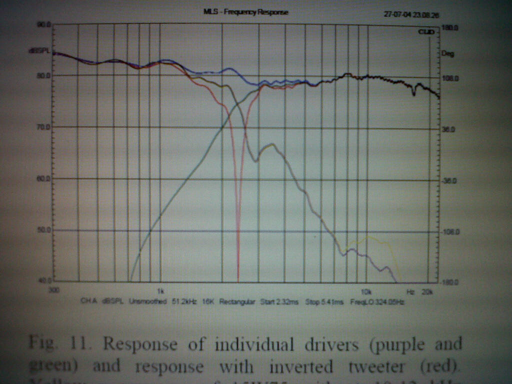

Fig. 11. Response of individual drivers (purple and green) and response with
inverted tweeter (red). Yellow = response of 15W75 without 10-12 kHz notch-filter.
Further refining of this crossover may include getting rid of the 3.5 kHz bump/dip
at 2 kHz by trying an 18 dB/octave approach. This will probably eliminate the need
for a 10 kHz notch filter. However, there does not appear to be much interference
from the 15W75 in the 3-8 kHz region on tweeter performance.
I cannot for sure say I can hear the impact of the 10 kHz notch filter.
Try for your self and see if you can hear this.

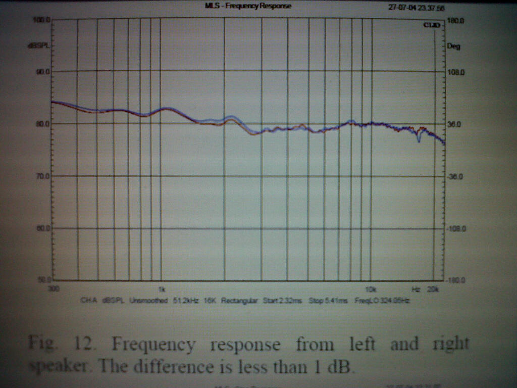

Fig. 12. Frequency response from left and right speaker.
The difference is less than 1 dB.

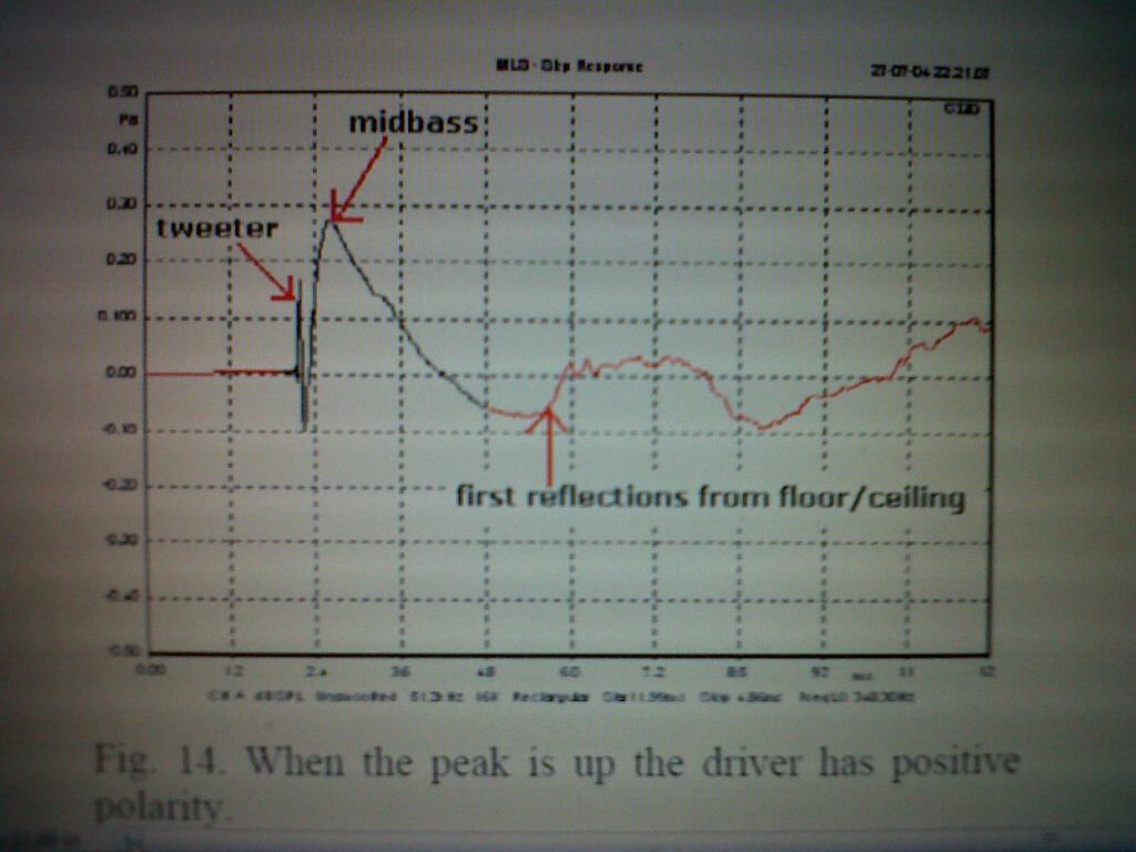

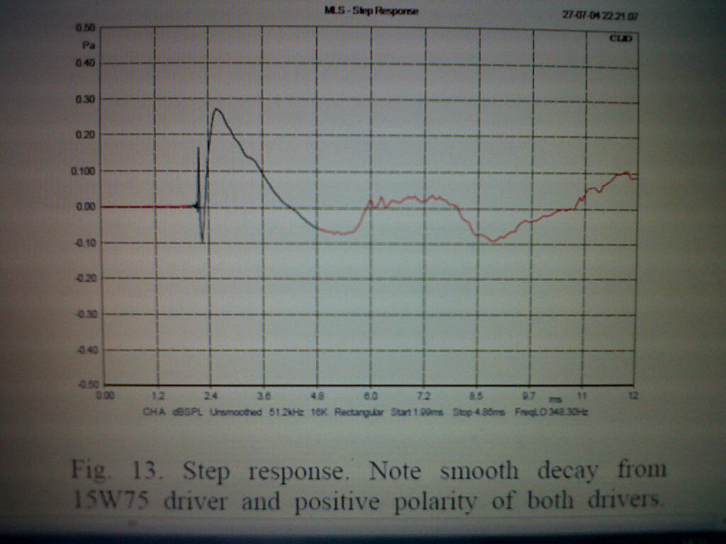

Fig. 13. Step response. Note smooth decay from 15W75 driver and positive
polarity of both drivers. The first very sharp peak is the tweeter response.
Then comes the midbass. As can be seen the tweeter peak is very short and
sharp, a fraction of a millisecond, where the midbass will last for more than 2
ms before it dies. What is important here is that the decay curve of the midbass
doesn’t display dips and bumps as a result of stored energy. Controlled break-up
that is. One of good things about polypropylene.
Fig. 14. When the peak is up the driver has positive polarity.
The black part of the graph is the reflection free time frame chosen for the
SPL response graph.
I can recommend the design already at this stage, but there may be
changes in the future.

and from introducing to designing crossover
without measurement
http://www.diyaudio.com/forums/mult...designing-crossovers-without-measurement.html

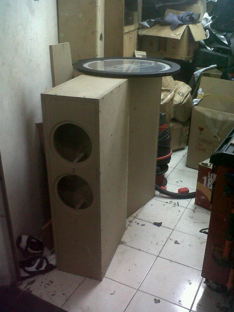

in the speakers journey i decided DTQWT style with T330D & 21W54
in a view speakers program the curve looks so simple and beautiful,
i decided to replace 15w-75 even i bought those pairs $450
all composition now will be T330D + Waveguide, 21W54 + 2x 24W100
this is the picture of the box
Will be interesting to see how these end up. The enclosures look great!
Shame the 21W54 is no longer available. Looks like I will have to get my hands dirty when (if?) I ever get around to using these T330D's.
What sort of waveguide are you using and how are you mating this to the Esotar?
