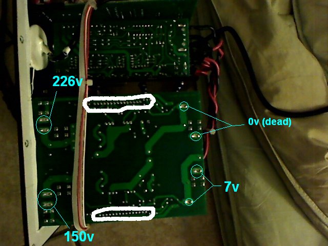

i have a picture to show you what voltages i read and from what points.
the multimeter is a Gardner Bender GMT-12A
heres the picture with the details:
my soldering iron is 30watt so i didnt try anything with 'heating up' some components. (i wasnt exactly certain which diodes you were talking about besides)

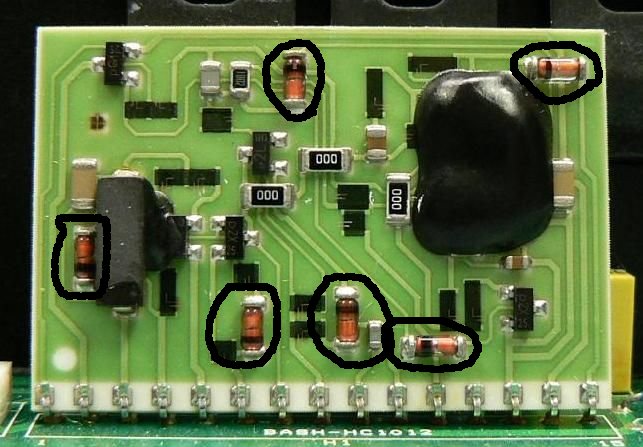

I circled the diodes on the bash image to heat up.
I also circled the pins on your picture that they are located at. The top where you are getting 0 volts is the one you want to try to heat up the diodes. I did mine with a 25 watt iron with ok results. Mine went to full on for my satelite spealers (52 volts).
Somthing that you can do to check to see if reheating the joints would help is to move the BASH board while you have a signal comming through it. If it kicks on for a moment then you know that the issue is a broken solder joing and reheating would be a good fix for you.
You can also replace the BASH board.
