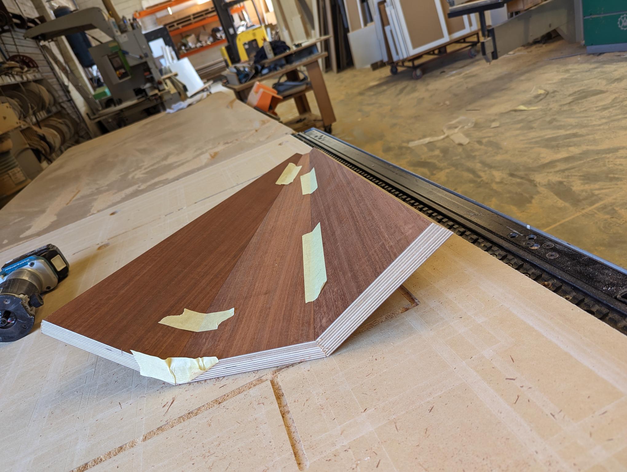

Starting a build for a Klipsch Belle, which is similar to the famous La Scala, only larger.
For this project, I'm using 25mm American Walnut on euro birch ply. The dims will be adjusted to accommodate the thicker panels (up from the original 3/4 inch).
Checking out the Crites 15-inch woofers also.
Top horn is a work in progress.....maybe a Bill Woods conical 300Hz, like that used in the Oswalds Mill range.

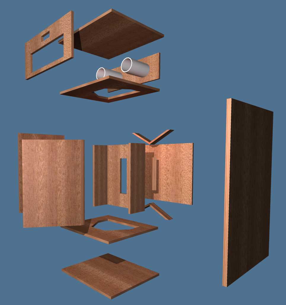

The 3D rendering pic of the La Scala below is not mine. It shows an interesting take on the original design, by porting the two cabinet sections together, then operating as a bass reflex.
