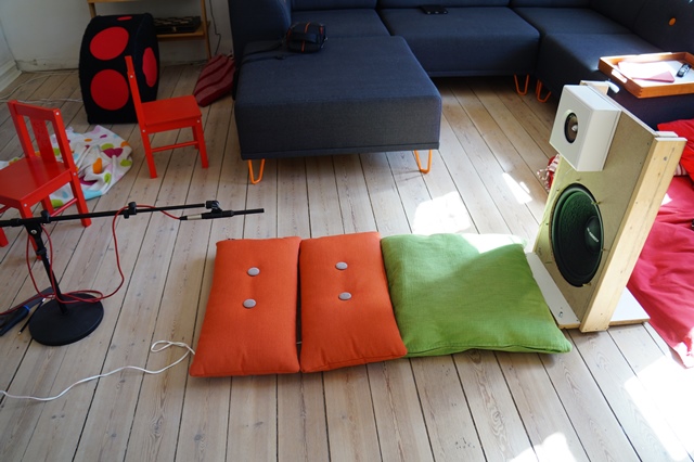

Inititally I will try some woofers. I had hoped for B2Audio 15 inch woofers, but they are sold out, so I bought one Gladen RS15FA to test in the mean time.

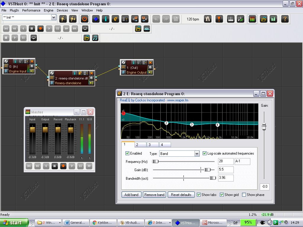

It's quite promising. This is just a mock up to feel the potential. Very simpel cross over and no eq at all. Capacitor on the Tangband full range and an inductor on the woofer. Crossed and just below 1 kHz. I can only play mono. I can add a little eq in Foobar, and get quite good results.

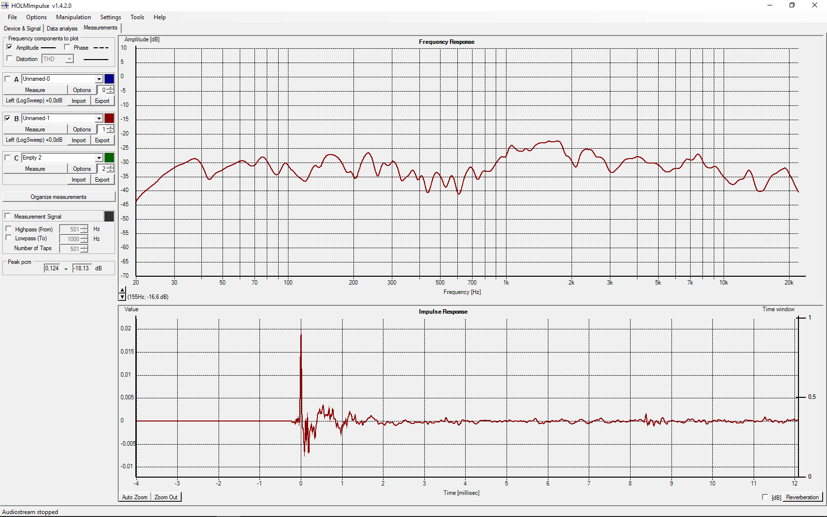

Measurement are in room as you can see. I am quite amazed that it measures so well down to 30 Hz. Subjectively I still miss some bass, but I only add 6 dB in Foobar, and som eq to linearise above 1 kHz. The result was much better than expected. I'm not sure I'll wait for B2audio to be in stock again.

I did plan to use two per side, but I am rather impressed with just one woofer, so I think it's enough. My next move is actually to try the slot loading that HIFIakademie is also using.

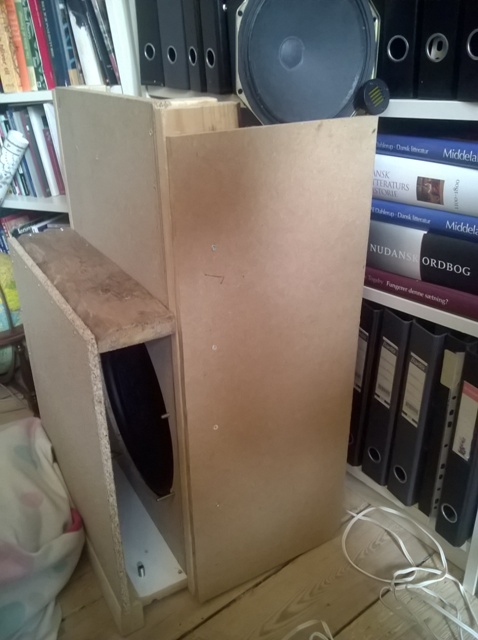

I have done some more testing. If I need real deep bass, I need two woofers per speaker.
But for 40 Hz and above I would be happy with just one. I still haven't settled for type of OB yet. I don't think the SLOB I have tested is better than plain OB. I have tried plain OB with very big baffle - that is very good - but I dont't have the room for that. A U-baffle might be the next type I will test.
