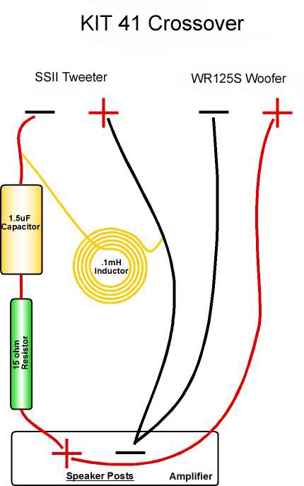

Does anyone have the schematic for the old CSS kit 41 crossover? I have a pair each of the WR and FR 125 drivers lying around and lost any information on them. Ultimately didn’t leave these in my system but these should be okay for surround and height speakers.

Thanks Paul! Yup me!
I have the FR125 and a buddy has the WR125. Crossover probably only applies to his but it’s a start. He appreciates the information.
