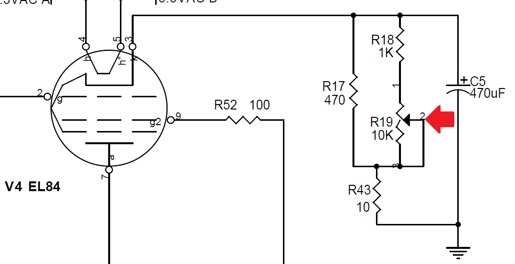

Bias Mod.
The, sadly discontinued, Dynaclone board from DIYTube offered a bias adjustment circuit that I've used on several EL84 builds. It adjusts the cathode resistance using a trimmer pot. The fairly low current of an EL84 makes this possible using a low wattage trimmer. It's easy to balance the current draw measuring across the 10 ohm resistor.
S.
S.
