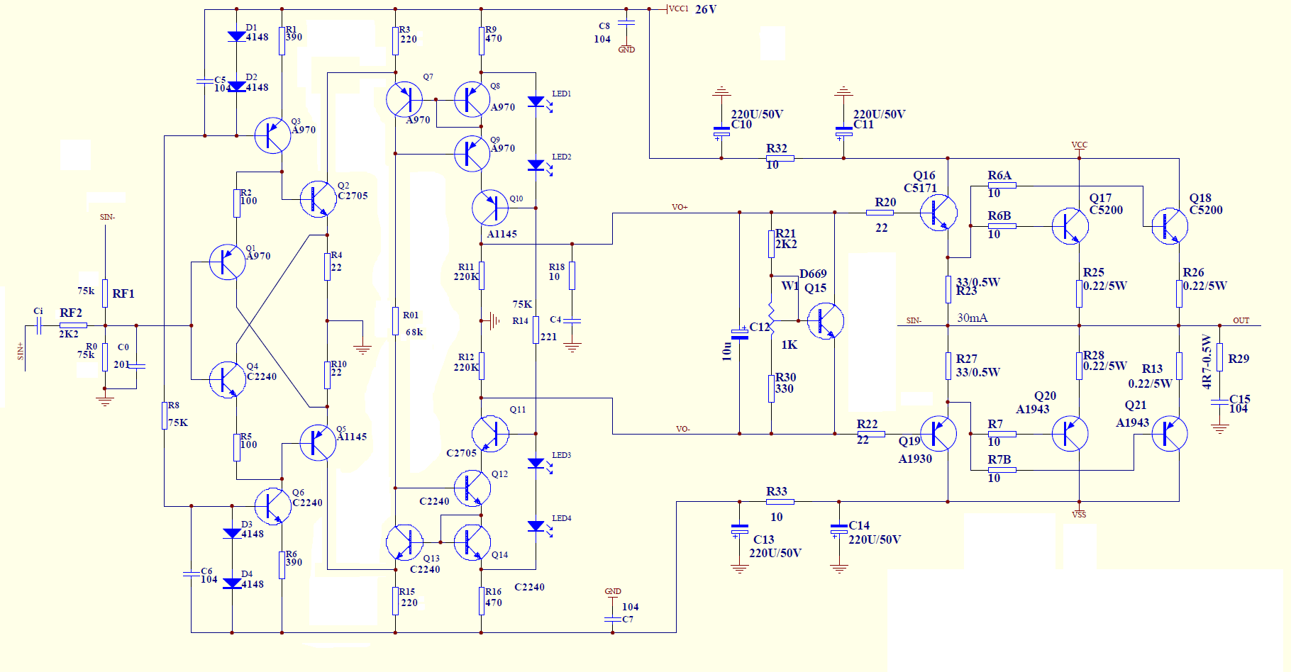

Kit Modification from EBay
This intrestin current feedback amplifier
can have a better sound with high Z input stage

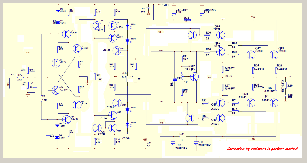

Are you REALLY suggesting that a balanced input signal should be connected between the input and output of the amplfier? Correction of what with resistors? What the hell is a 'Marantz layout'?
