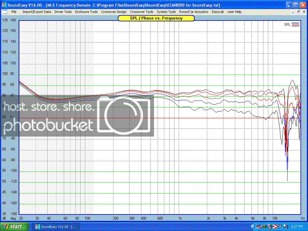

The Raptor ... a 10" MTM
Note the horizontal response (that has NO smoothing):
