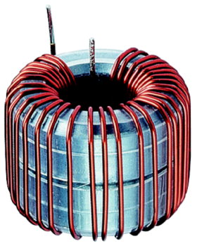

The 1% regulation makes any electronic power supply regulation totally superfluous. In addition we have a powerful PI-filter with a custom made torroidal ferrite core choke, see picture, with the windings evenly widely spaced giving very low inter-winding capacity keeping the hash further OUT. The PI-filter gives a ten-fold reduction in ripple voltage.

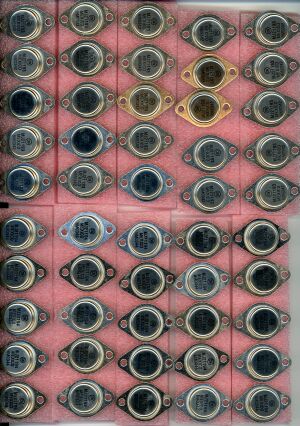

As a side note Sanken made the biggest blunder in history by eliminating the TO-3 and TO-66 metal can packages from their line. They compounded this stupidity by making the parts available with the wide plastic 2-screw package, which takes up an enormous amount of room laterally. Consequently, they lost the entire audio industry business. How moronic can a company get?

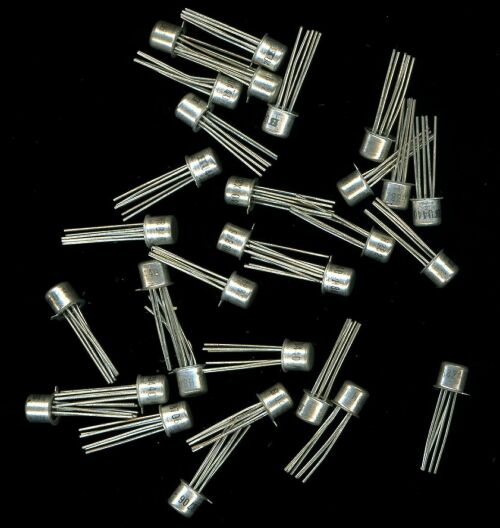

U440
Picture of U440 Dual N-channel JFETs. These are manufactured by $iliconix now part of the Vi$hay conglomerate. Datasheet here: http://www.vishay.com/docs/70251/70251.pdf

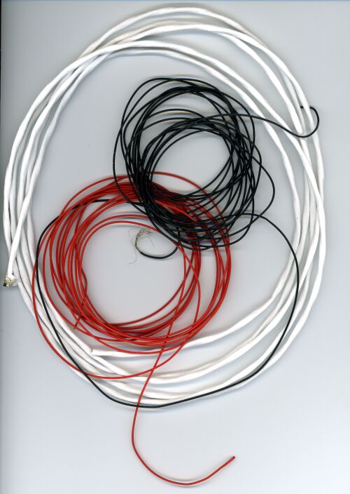

Pure Silver Wiring
Snapshot of internal wiring used. Nine nines pure solid core silver wire Teflon ® coated is used. The term nine nines used in the industry may need explanation. 99.9 pure silver has 0.1 % impurity and is called one nine. So our silver wire is 99.999999999 % pure!
Wire sample courtesy of Audiofanatic.

i always though the U4xx family had some nice dual devices. seems like teledyne crystalonics or somebody made a similar device way back when that was pretty good, too! anybody remember?

Re: Pure Silver Wiring
Hi Elso,
I'm glad you like them!
Audiofanatic 😉
Elso Kwak said:Snapshot of internal wiring used. Nine nines pure solid core silver wire Teflon ® coated is used. The term nine nines used in the industry may need explanation. 99.9 pure silver has 0.1 % impurity and is called one nine. So our silver wire is 99.999999999 % pure!
Hi Elso,
Audiofanatic 😉
