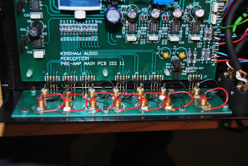

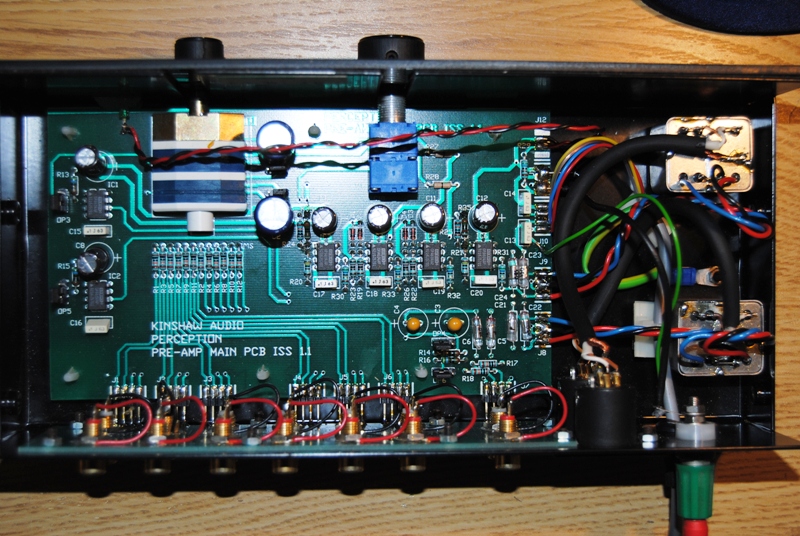

I experimented with the pre unpowered (PSU removed) and the loud hum persists... even without power and/or signal.
I then connected the earth terminal on the pre to the amp GND and the hum was greatly reduced..... It seems the problem is inside the pre and related with GND loop.
This pre is equiped with small TX to produce balanced outputs... can these be faulty ?
Here you have some pics.

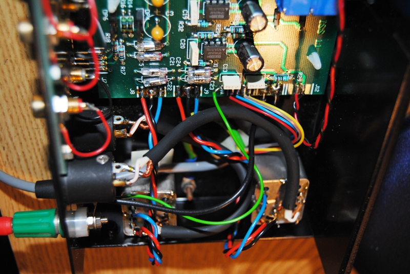

Not really. A ground connection, cold solder joint, broken wire seem more likely than anything more complicated.

From what you now say I have to agree with analog_sa and think you must look at all the grounding arrangements.
You are going to have to measure all these for continuity... I can't really make it all out from the pictures.
All this sounds a bit vague but without actually having it front of me all I can suggest is you begin by seeing if the ground of the RCA input sockets read to the ground of the RCA output sockets ?
Does the chassis earth tag read to the output sockets ? if not it may be by design so trace it and confirm.
Does the RCA ground read to the O volt line of the PSU and the OV line of the main PCB.
Where the boards join at 90 degrees, are all those connections OK... the grounds ? not cracked print or anything ?

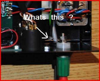

And what's this in the picture... it looks a wire unsoldered or broken of the green terminal 🙂 probably not though.
I can not see any loose wires or dry solder joints.
The one you point is correctly soldered to the output gnd socket.
