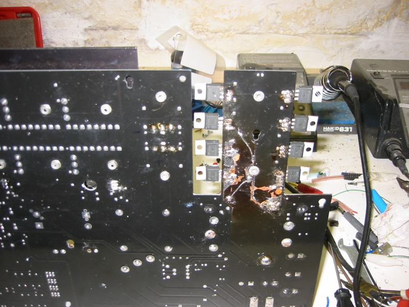

This is a PG Ti1000.2 that had a PS failure and the mosfets took out the little "peninsula" of the board when they burned. I re-drew the damaged part of the board in Eagle Cad, cut the replacement PCB on my mill, cut the bad piece off the amp and soldered the new one in place using solder braid to provide a good strong low resistance joint between the old and new. It is not the prettiest, but the amp was not really repairable otherwise.

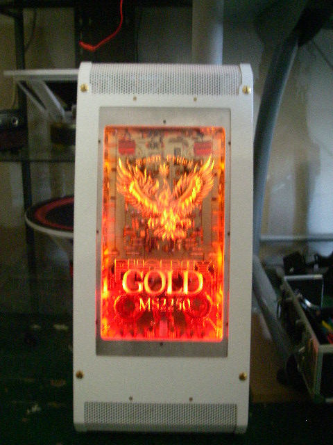

This is kind of blurry, it was a customer pic sent to me after the acrylic was installed. I did the acrylic and the aluminum surround. The amp is a factory PG MS22xx with fan shroud.

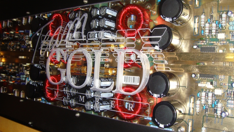

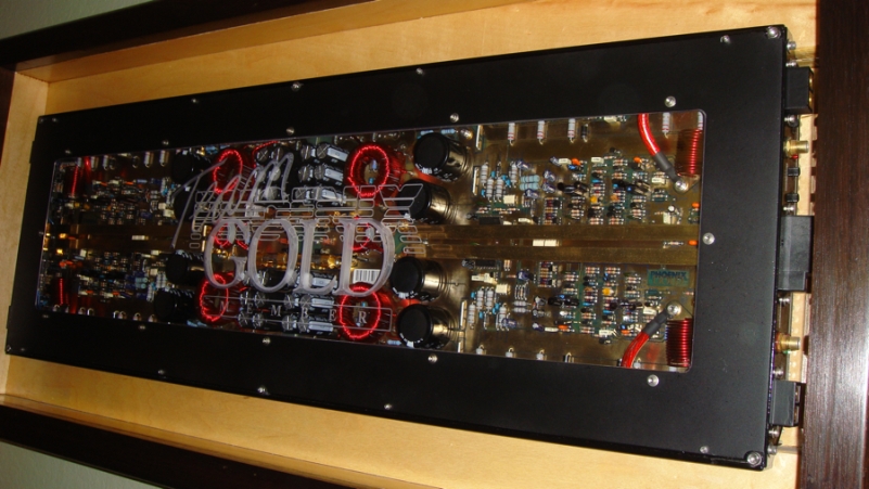

More customer pics, this is a PG MS1K, I did the aluminum and acrylic piece. He finished the aluminum and the wall art display is his alone as well.
