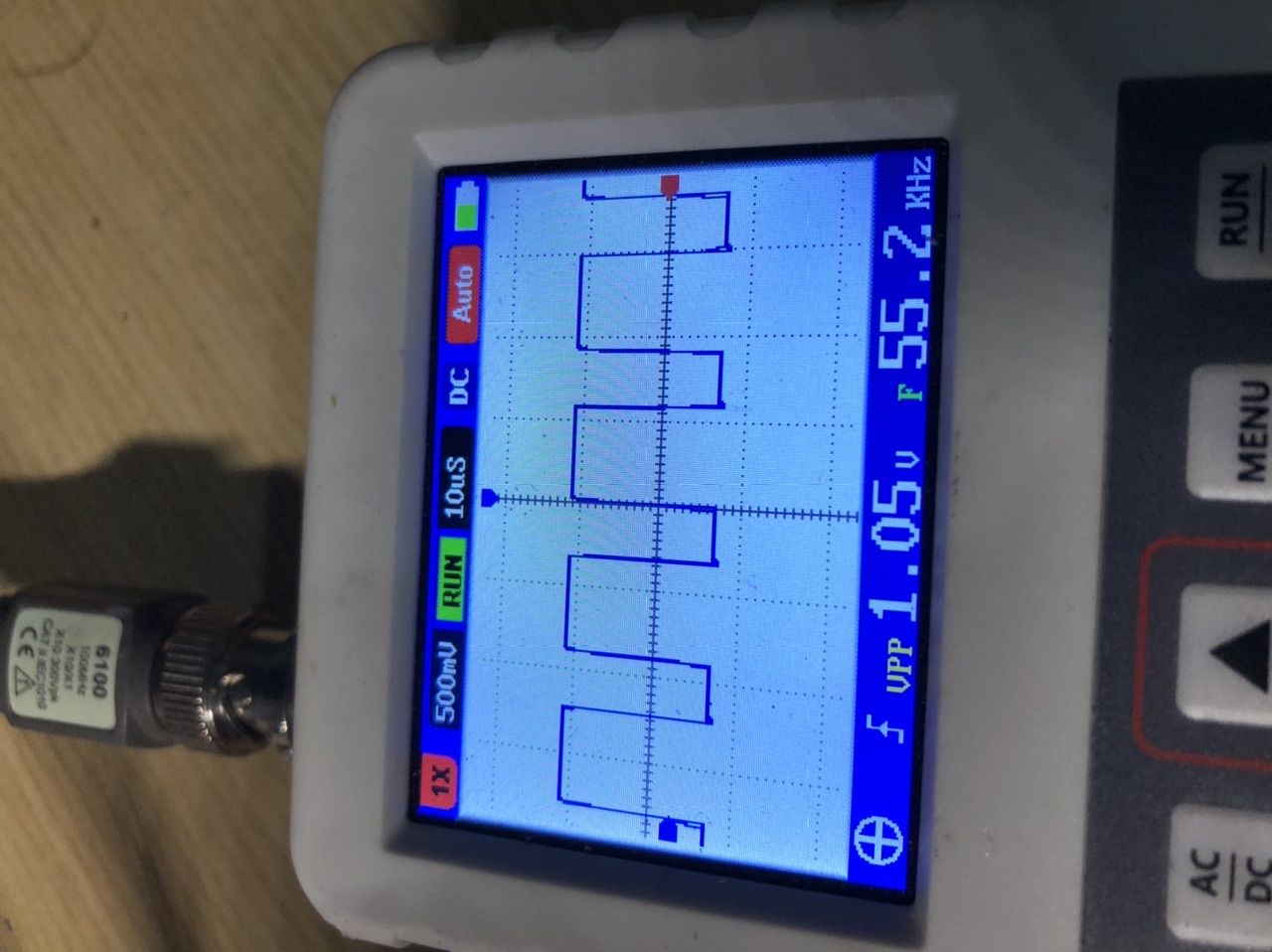

Im working on a kicker zxs1500.1 it had blown power supply. I change 3843ic, 2045 and 3 new irfb4110. The ps turns on and raise 85vdc. But it has a noise at the same time the red power led flash, only one time every 3 seconds . The dc bus voltage is stady 85 and the input the same 12.5 volts.
No shorted outputs.
If i conect a speaker it hits at the same time the red light flash.
Any ideas??
Thanks!
i remove ic10 tl072 and the red light goes off, the ps railis +85 volts, the outputs mosfets start to oscilate, but no sound at the speaker terminal. +30 volts on each output terminals measured with amp gnd. i replace the tl072 with another working one same problem.

Check the DC voltages reference power ground around IC14,IC15-IRS20957 and post results.
Check R175-27 ohm, R173//174 and 273//274-16 ohm in circuit. The 27 ohm should read 27 ohms and the 16 ohm parallel pairs should read 8 ohms. If they check good remove all five resistors and left R22-10kohm. Power up and check output oscillation.
Ok. All 5 resistor are ok.

5 resistors out of the amp. Tl072 in place. Same problem red light on and a click sound every 3 seconds with light Flickr. The oscilation is present only a fraction of second but i can see with the scope freeze.
