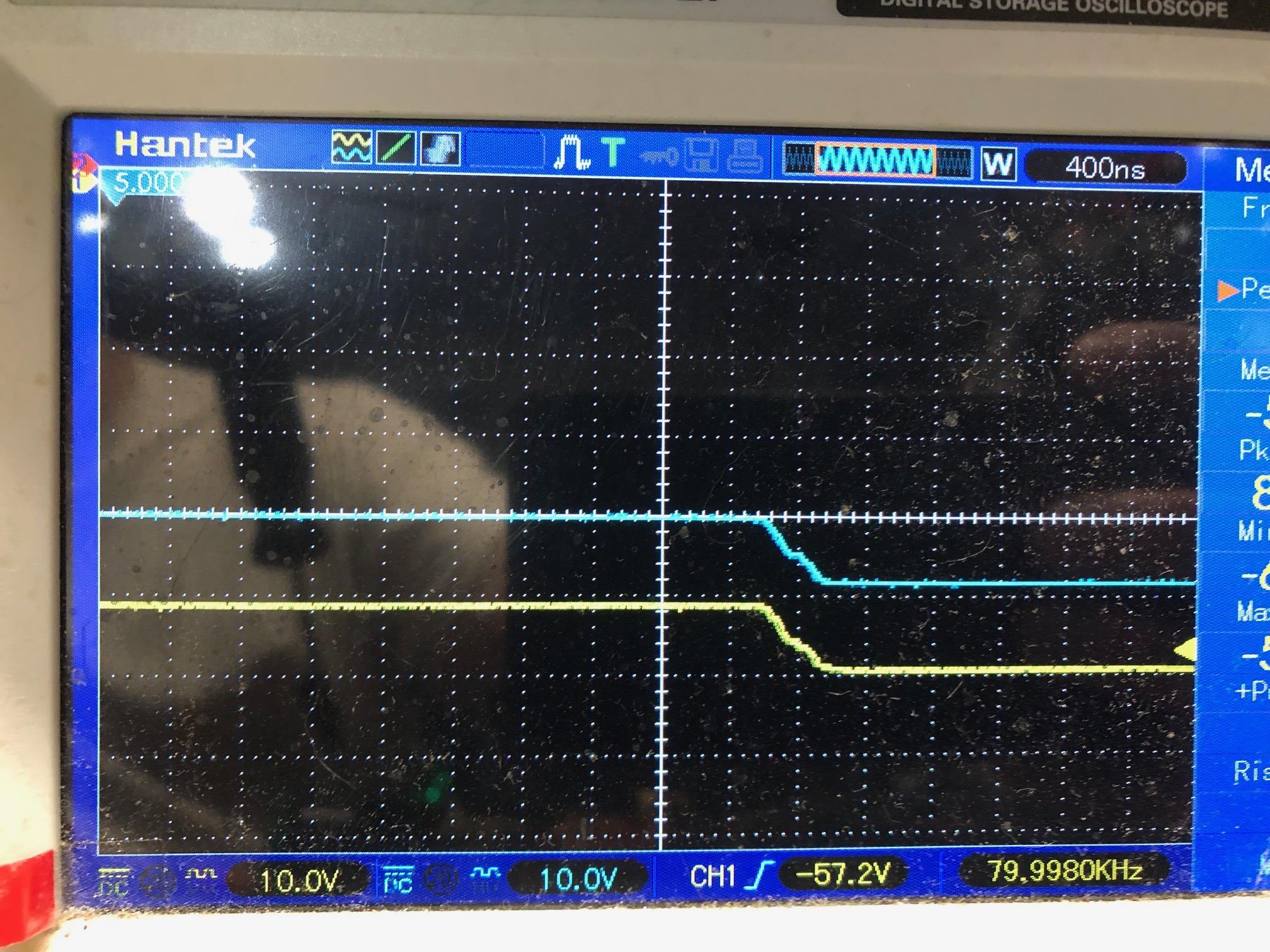

I've repaired this amplifier 3 times now. Every time it ends the same. Amp performs well. Amp dies at random. The first time is lasted a month. The second time, it lasted a week. The third time I decided to use it in my own vehicle to rule out 3rd party issues/abuse and subject it to an automotive environment. Perhaps witness it myself. It beat the brakes off my LMS 15's for nearly a month. Then one day, The moment it powered on - the PS popped. The track hadn't even loaded yet so it was signal free. The failure is always with one of the N channel devices. Never the same one really. I have used 3 different parts here. The 640, the 640n and 31n20d. I don't believe they're the cause of the problem. I've subjected this amplifier to high stress situations, lots of measurements, and every twist imaginable. I have not been able to replicate this failure mode on my bench. I was hoping someone knew something I don't to make this repair a 4th - and final - time.
Board is pictured. Thanks in advance.

Pay special attention to the DC voltage across the 12v Zeners for the drivers, when you heat/cool them.

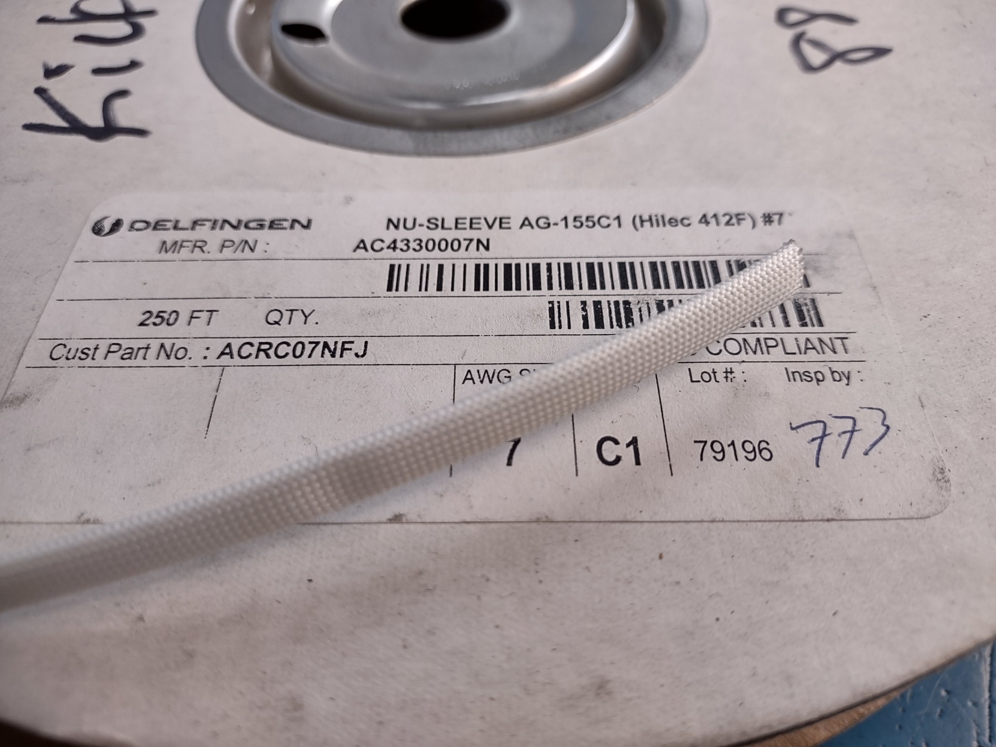

Because the output inductors look to be firmly in place, you may not be able to flex them enough to cause idle current to rise.
The sleeves on the inductor leads become perforated due to heat and vibration and may be rubbing against adjacent turns.
Whenever we get amps in with this type of sleeve, we replacing them with the sleeve pictured below.
The 12 volt Zener's in the annotated white boxes should be checked as Perry suggested.
