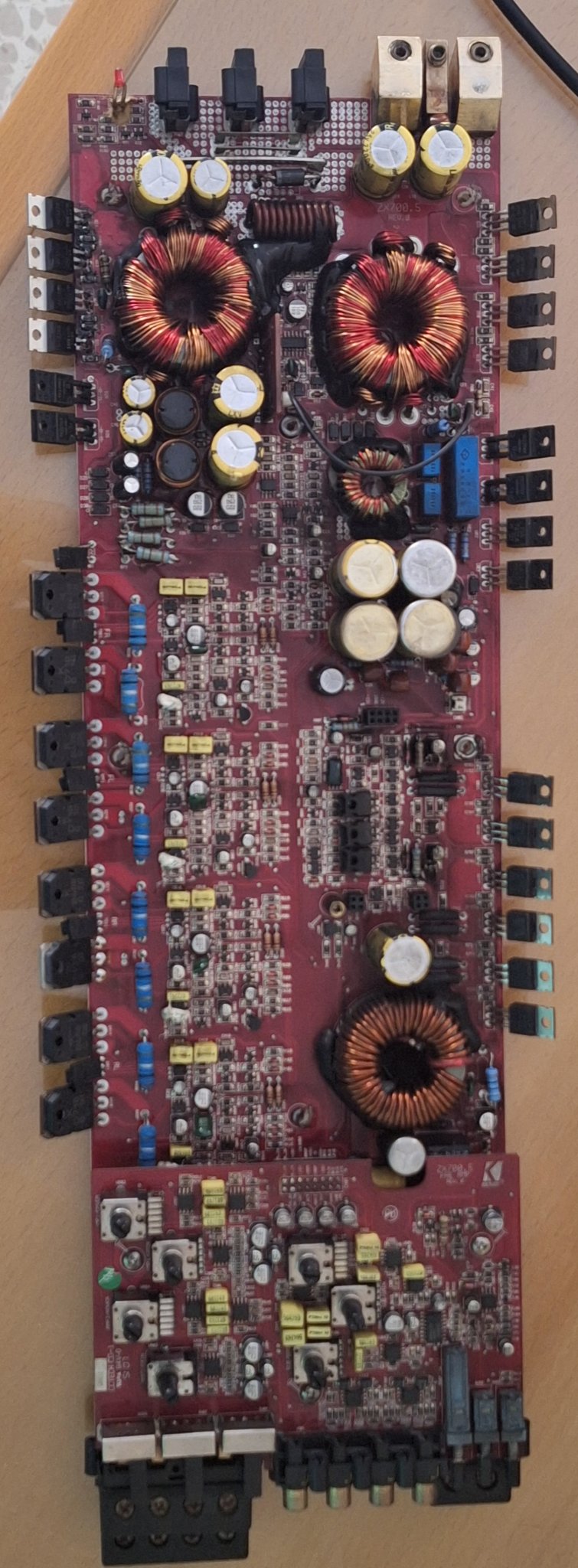

I am currently repairing a Kicker ZX700.5 REV0 amplifier board and would like to know the values of R46 - R49.
Thanks in advance!

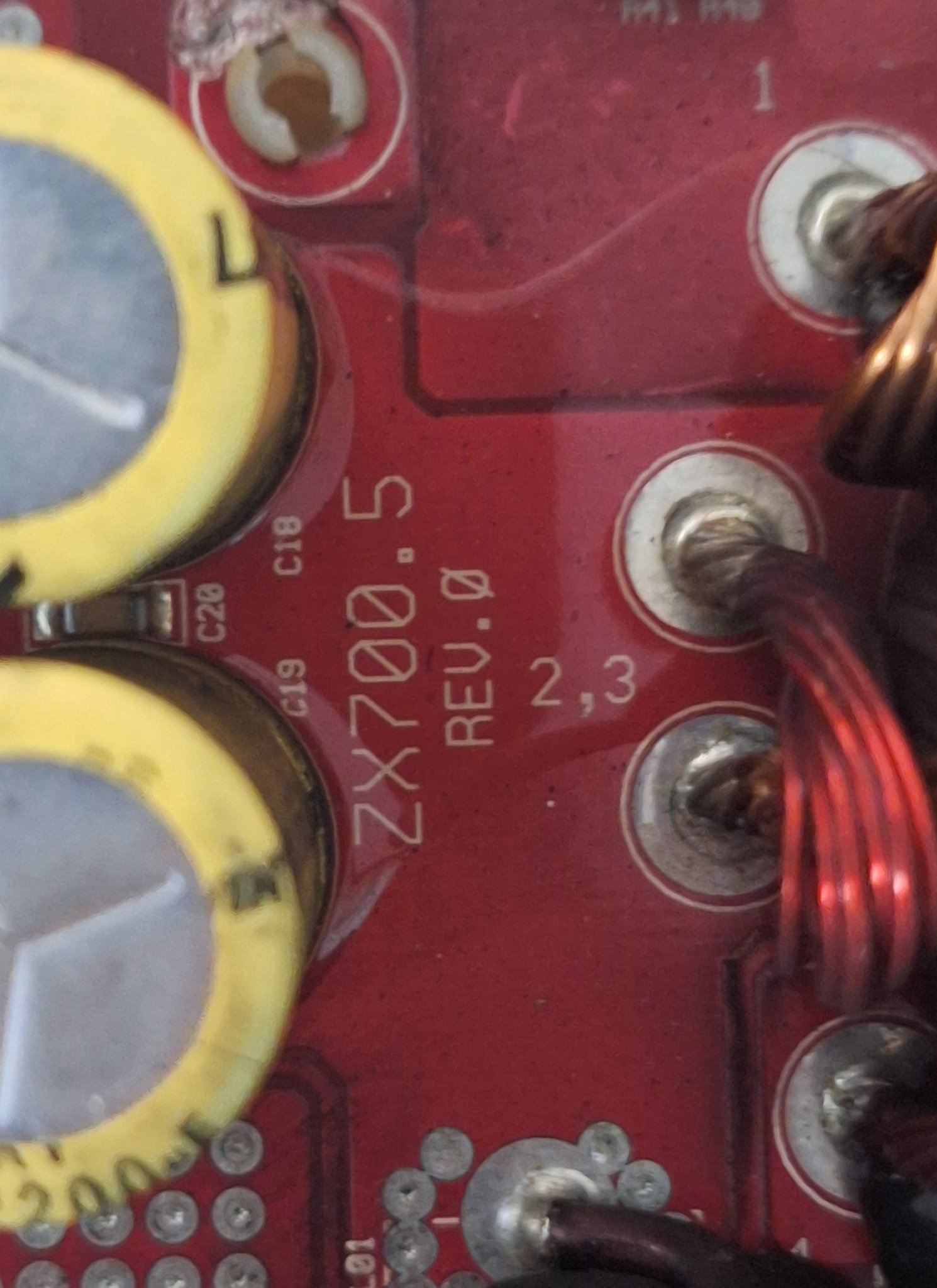

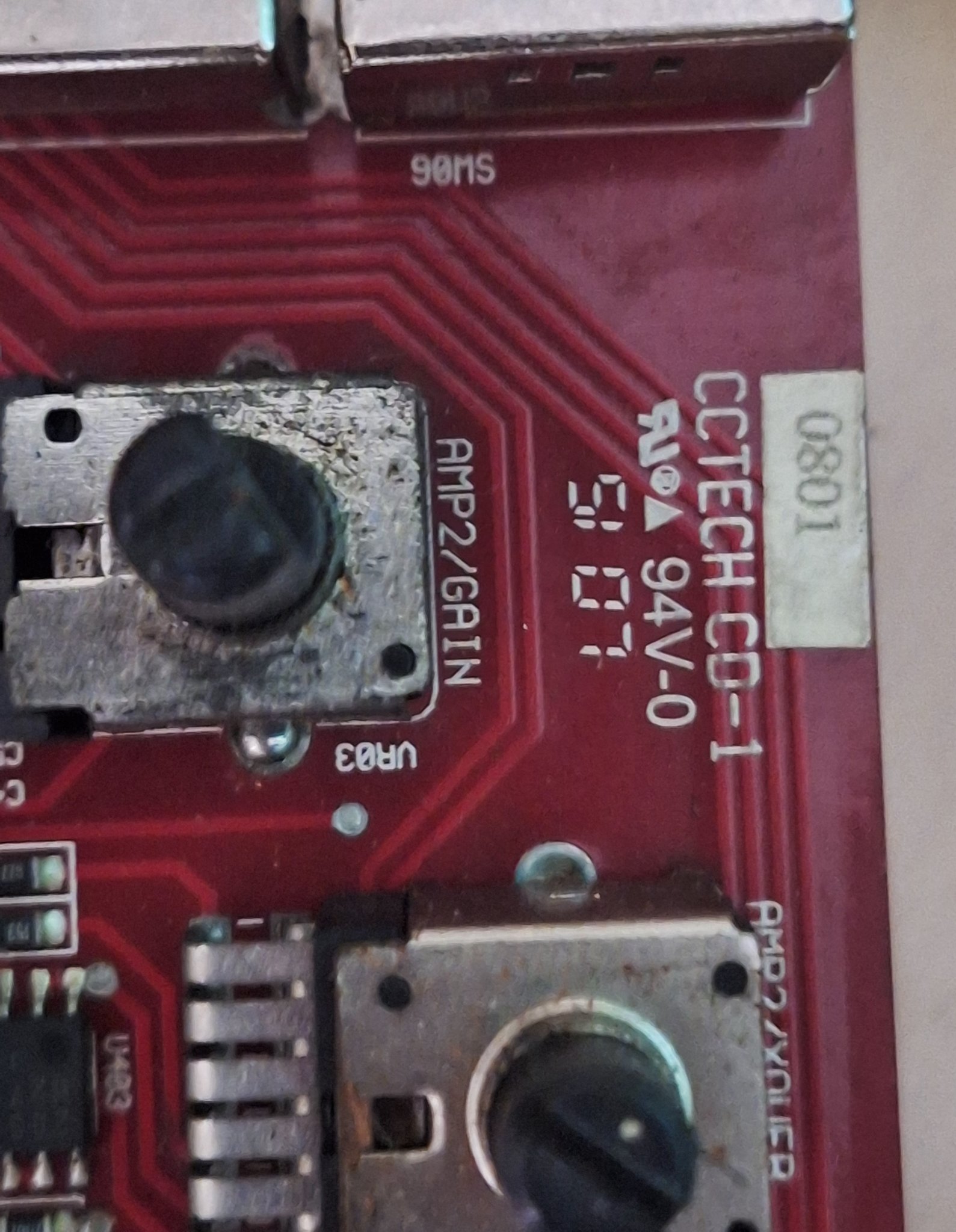

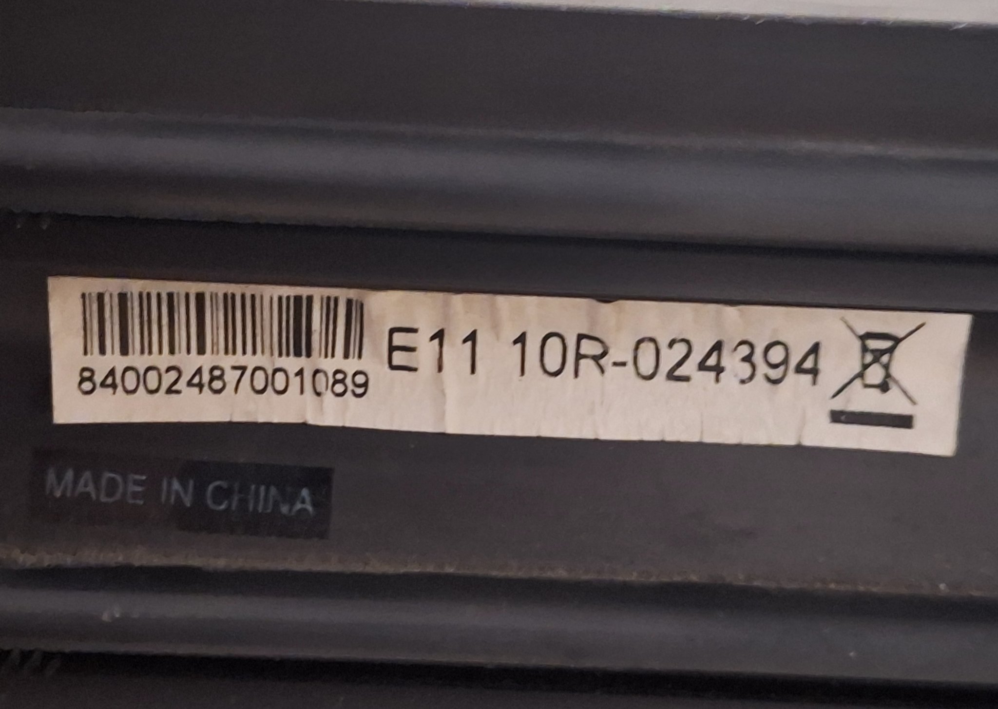

Hi Bill,
I could only find the fillowing marking on the pre amp week 51 2007. I took pictures of all the markings I found.

Hi Bill thanks for your contribution!
Amp works perfectly after replacing R45,46,49 and 50, I didnt find anything wrong with Q14 and Q15. Please note that these resistors have been replaced after having replaced the 4x IRF3205 Q20 - Q23 and one of the KTD718 BJTs
