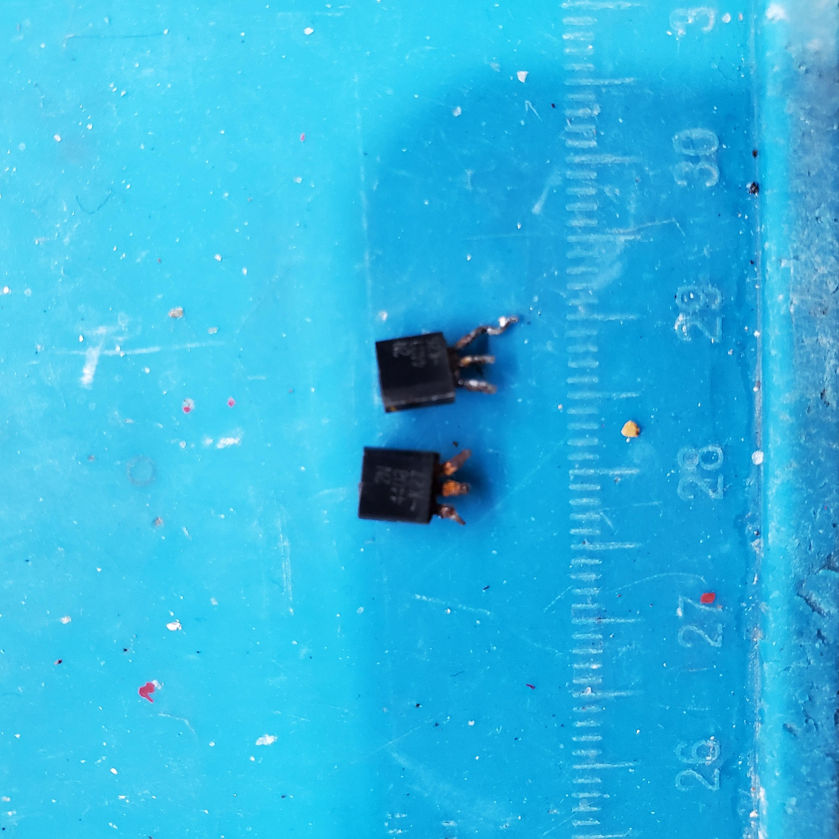

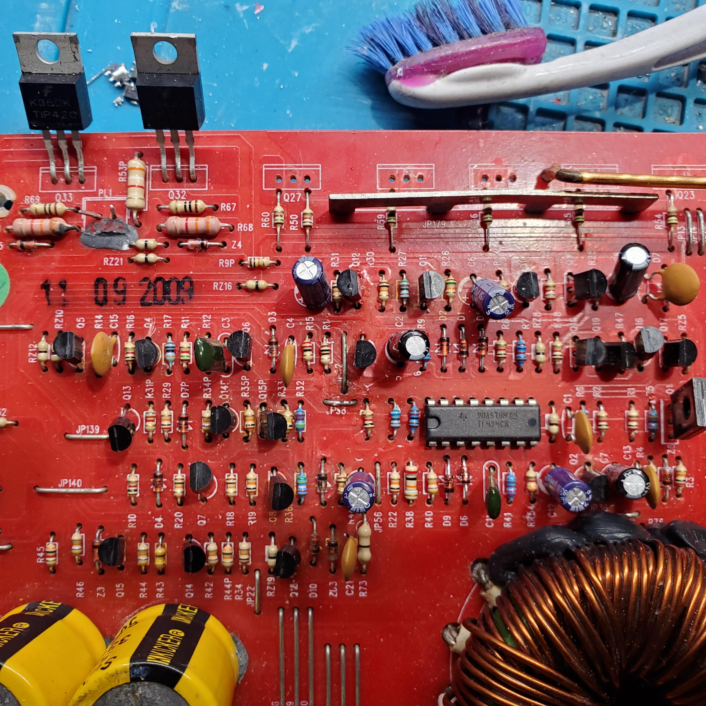

I have a Kicker zx650.4 that has no power at the ic. Several NPN, Pnp 2n4401/4403 transistors have legs have rusted or corrision where they broke the legs right off.
Q12 the silk screen is missing and was wondering which transistor is used here and in which orientation a photo would be helpful of this area.

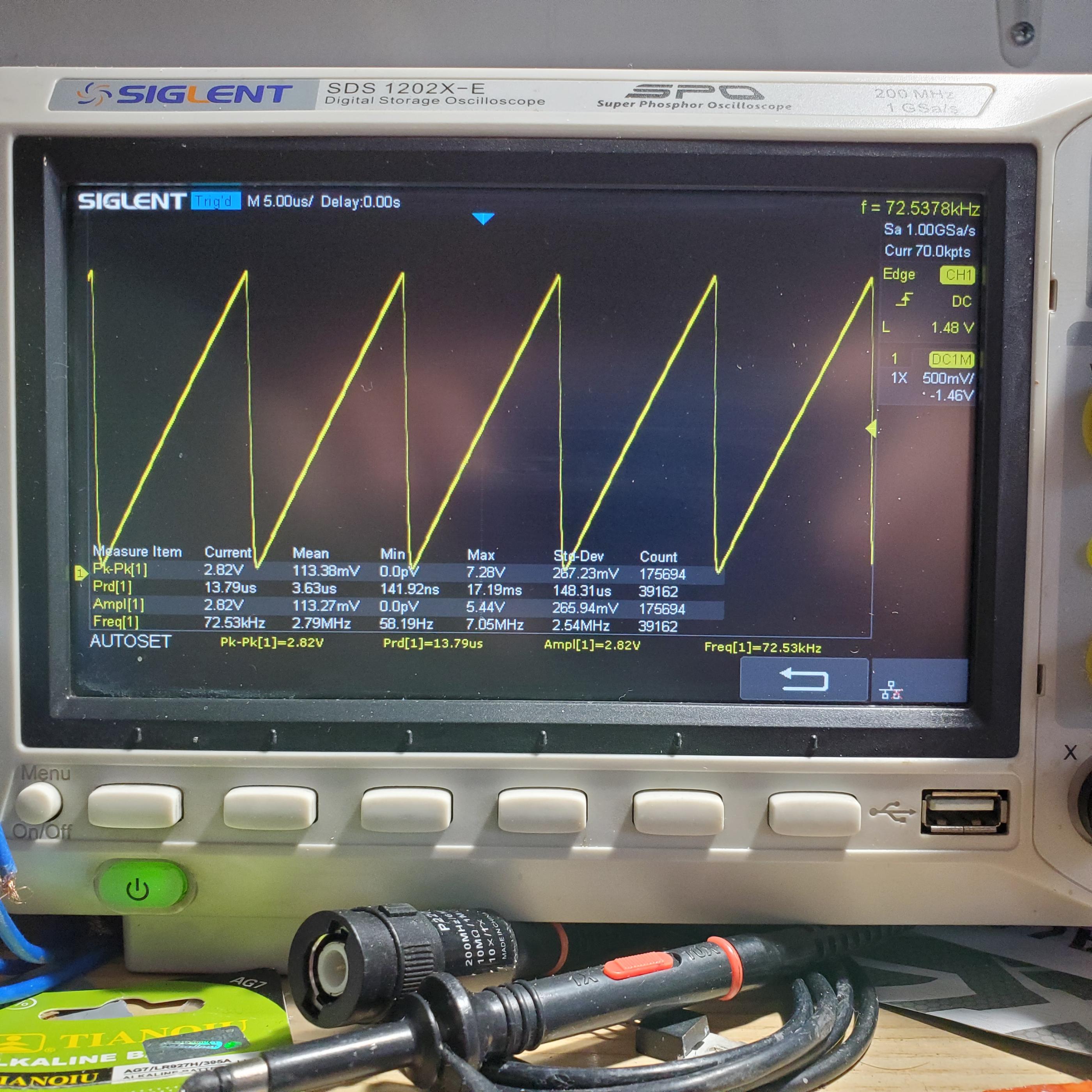

It may be a good idea to remove all power supply mosfets. To disable protection lift D6-1N4148. Check the DC voltages around IC1 and scope pins 5,9,10 for sawtooth and drive waveforms. post screenshots and DC voltages.
After 30 transistors and a ton of capacitors that look like this. Still in protection. I have every 4401-4403 on the board. All had rusty legs. I have restored pin 5.

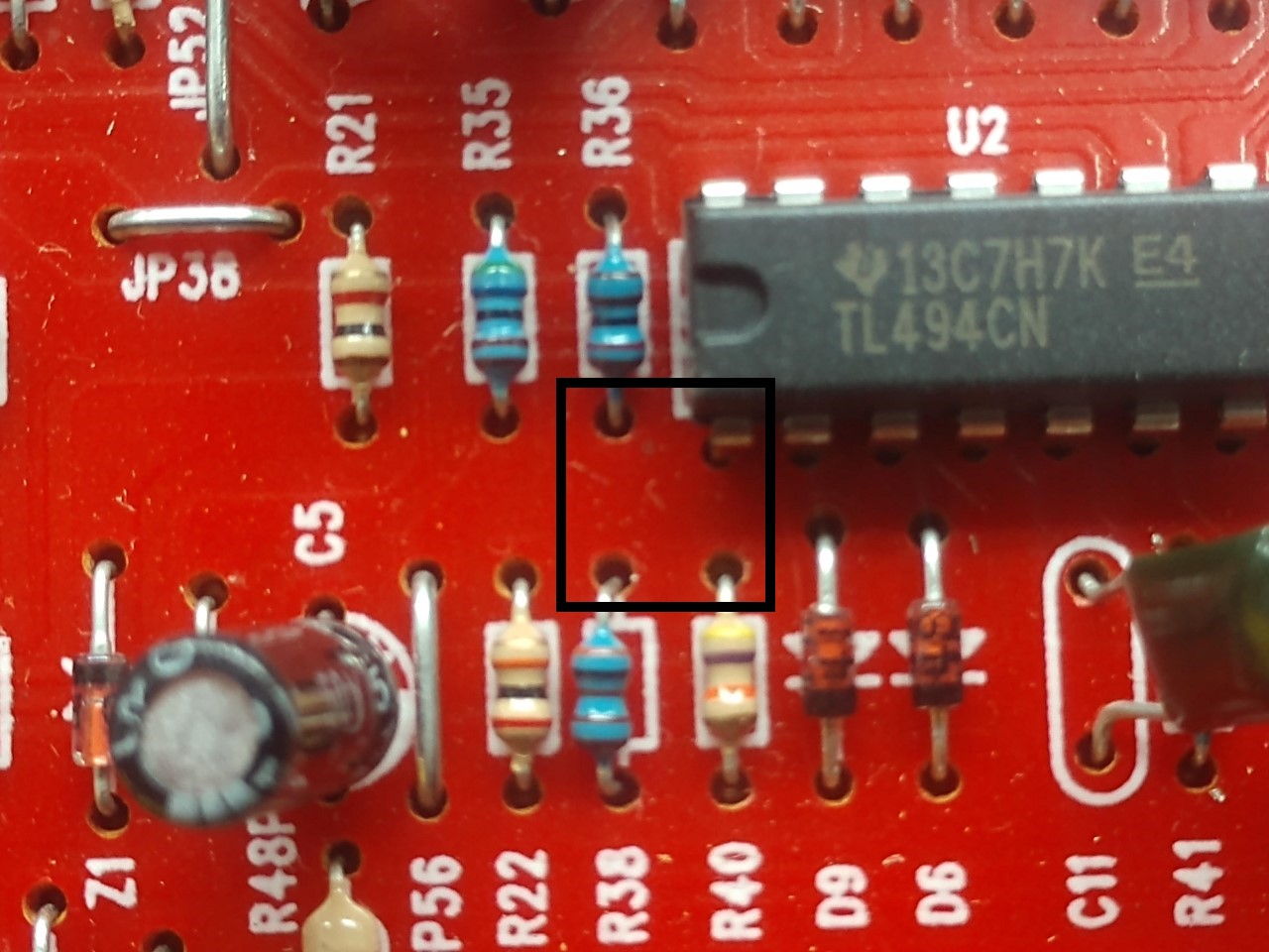

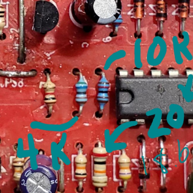

R38 is wrong resistance should be 18.2Kohm.
I attached the photo you sent. RR50 may be one of the two I pointed out.
It appears someone may have changed them out and upset the ratio, You should have ~ .7 volts on pin 1 TL494, not the 3.3 volts you posted.
Check to see if R38 is tied to one of the two resistors and pin 1. When you replace resistors, they won't need to be the exact values, but maintain the same 5 to 1 ratio.
Don't worry about R40- 47Kohm.
The resistor in location R38 pictured is a 200 Kohm based on the color code.
The two resistors you marked 10K and 4K aren't even close to the color codes. Have you removed all three and measured out of circuit?
Also, R38 ties to RR50, R40 and pin 1 TL494 only. You will have to trace Pin 1 to R38 then another resistor that is not R40. Once you've found it, it has to be RR50. RR50 needs to be 5 times smaller than R38. So, you will want to use ~20k-R38 to ~4k-RR50.
I will try to find a blank board for ZX650.4 with the silk screen intake.
For now I've attached a good board with the silk screen intact. The square shows the node of the three resistors and pin 1.
I will need to find a schematic that shows R36 and verify that it is a 3.01 Kohm resistor. My photo is a fuzzy and I not sure what the color codes are to verify.
Based on your photos R38 looks out of place and I'm fairly certain that is not the original stuffed resistor.
Bare with me, I need to examine the amp I have before I can give you a definitive answer. I'm afraid we are working in the dark, and changing parts will confuse the issue even more.
