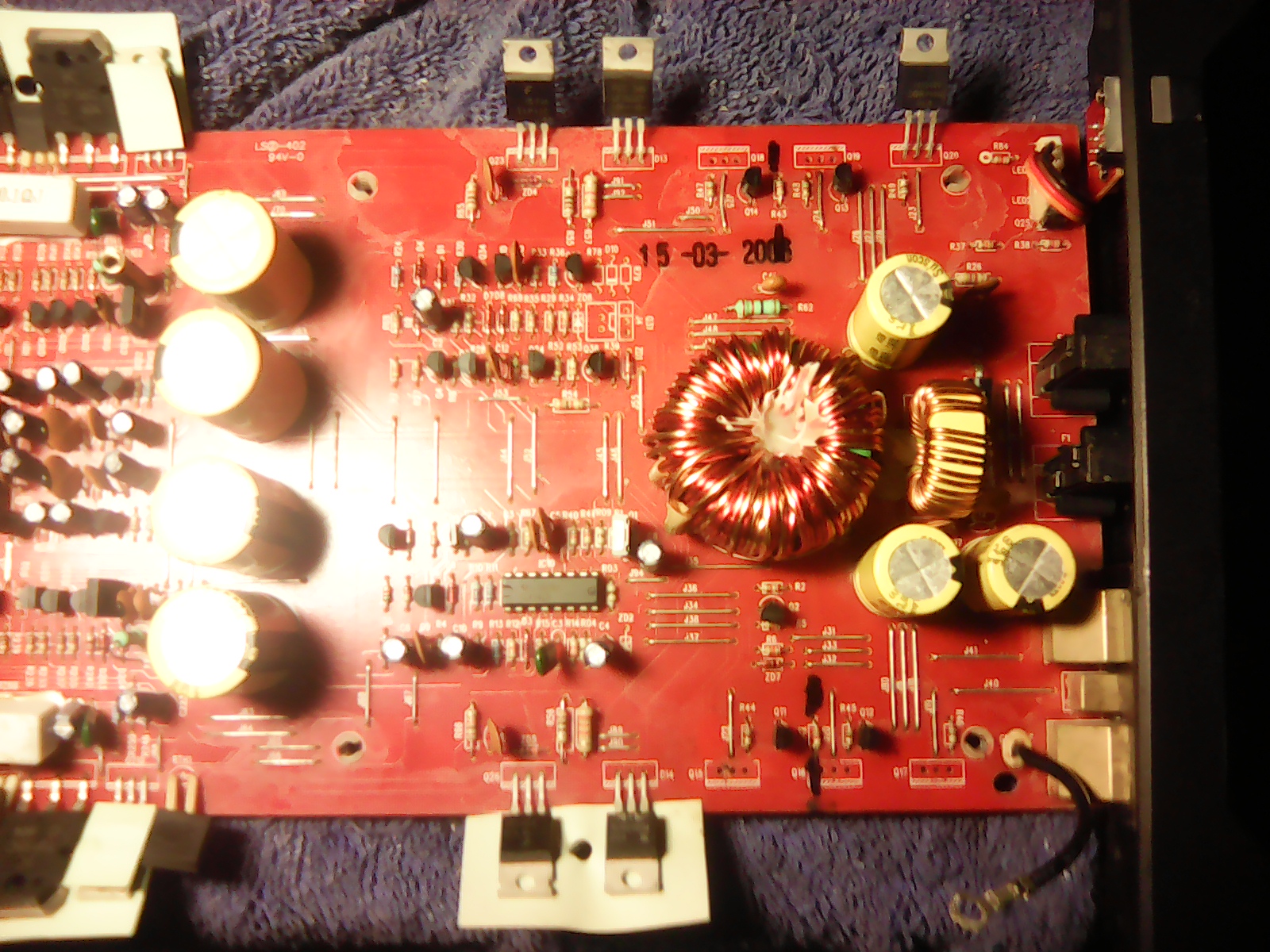

kicker board pics

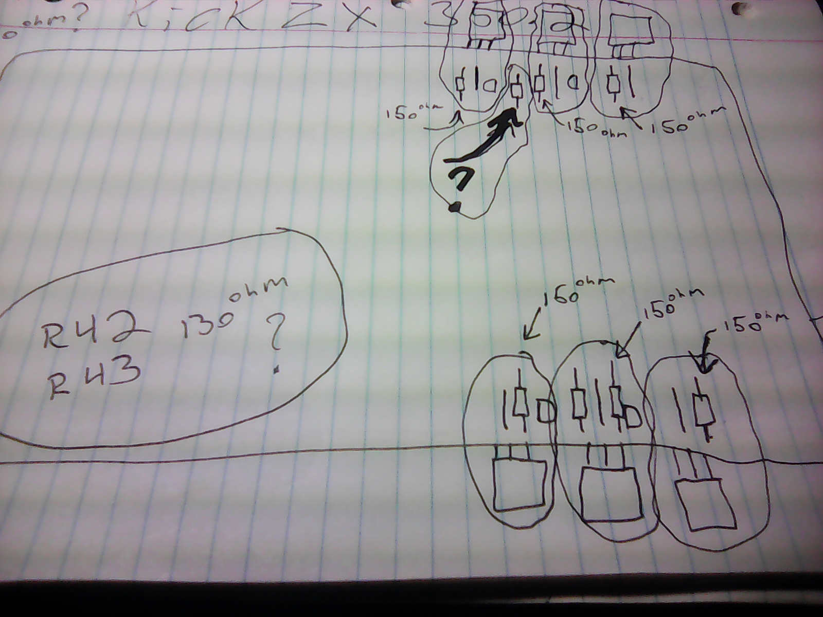

i think the resistor that im looking for is a 1k resistor thats what the color code is if im reading it right
but one comes up as 130ohm way out of toleren and the other one is open reads nothing
in the pic i marked the resistors that im talking about there is 1 on each side
and the gate resistors around them are 150ohms
i think its a 1k ???
can anyone tell me what the ps fets are suppost to be for this amp?
im not shore when i opened this amp up they were all burned up and some even cracked in half all i can make from them is IRF?
