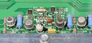

Hello together
iam Alex comming from Germany 🙂
yeah but this is not my Problem
my ex didnt like that i wanted to go awy from her,
so she demaged my amp during my working time in America 🙁
So till now i put new mosfet bias an a few caps inside,
but till now it doesnt want to work🙁
i put voltage on it, the amp isstarting and staying with the working led red.
but i here whissling voices from the preamp?
this is my Hobbys in my freetime and i dont wanna lose this great amp.
please help me to find this issue
thanks together

With no RCAs plugged in, what's the resistance from the input RCA shield to either of the non-bridging speaker terminals?
Perry please, please give me an advice how the cenw92 + cenw42 are assembled ?
i mean the direction, i dont find any Picture and i dont have any Sheets of this amp
There's a shield ground fuse that sometimes blows.
What parts failed in the amp? Use the circuit board designations for the parts that needed to be replaced.
Are you sure that the shield ground for your signal source is intact?
the following parts has been replaced
cenw92 all
cenw42 all but for that i dont have a possebility to find the assembly directin
C36
C37
C203
C204
C103
C104
R244 was broken leg, is solved 🙂

Leg 1 of the MPSW transistor is nearest the tab on the transistor outline on the board. The following is from a 600 but the installation is the same for the w42 and w92 drivers.
R122? The potentiometer? Did you reset the bias?
Are both channels noisy?
Connect your meter between the B+ terminal and a non-bridging speaker terminal. Meter set to ohms. Nothing else connected to the amp. Twist/push/pull on the power transformer. Does the meter ever go to near 0 ohms?

do you have a Foto from the installed CENW42+ CENW92 ?
For mesure this type of amp, what do you think is a good idea of power supply specs?
please say to me the rowThe best I have was shown in post #7.
this mps92 is the secound Transistor, if you start on the power side
please say me the positions of the other threes.
I don't have any photos of a 1000 with the MPSW transistors. The attached show the alternate parts. The 2N3501 is equal to the W42.

so i found one fault
this parts have been placed on a wrong place
the row is now
q213 w92
q211 w42
q209 w92
q212 w42
on the other side
q113 w92
q111 w42
q109 w92
q112 w42
is this correct?
