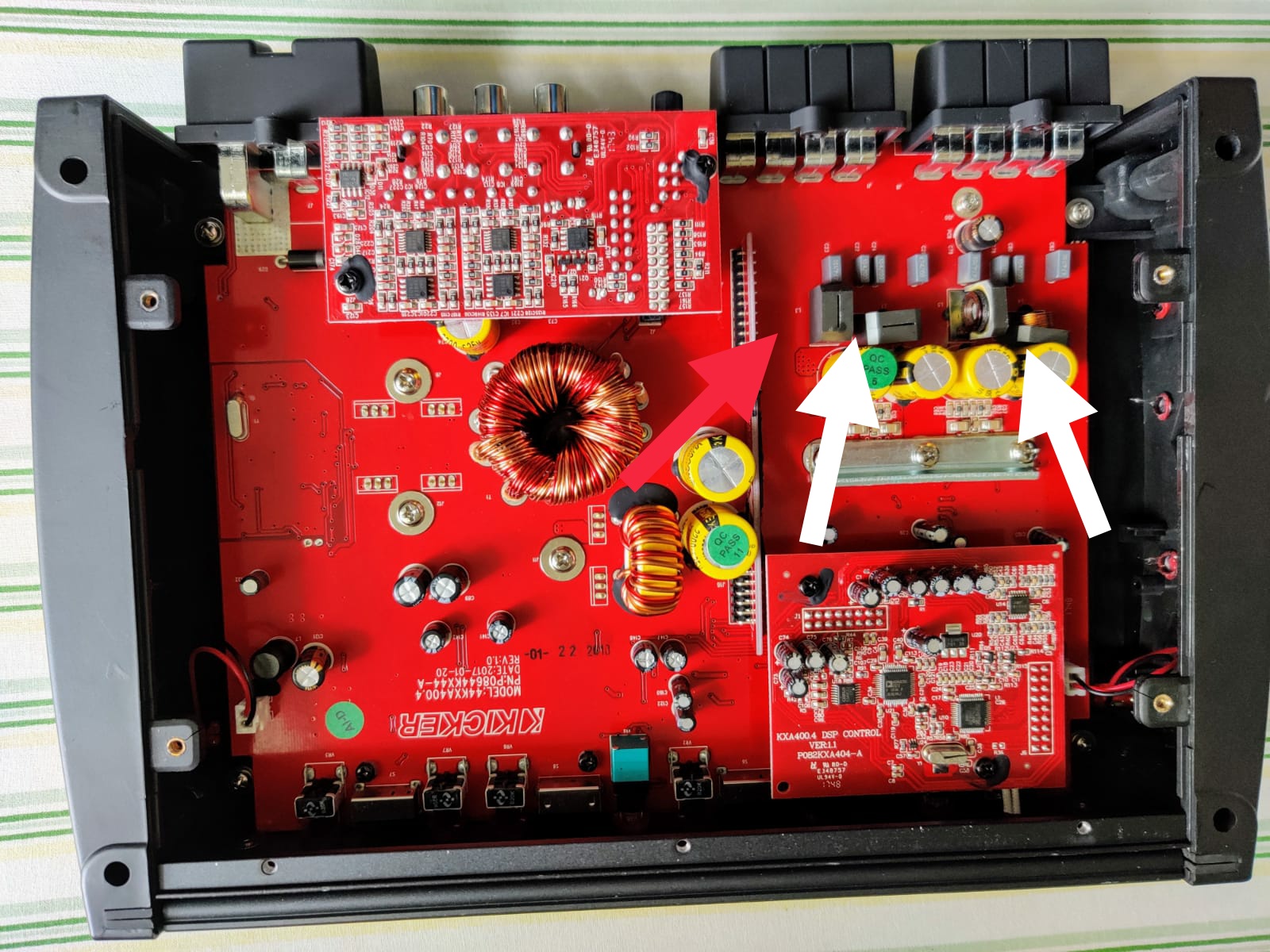

Hello, can someone identify these parts in a Kicker KXA400.4? They look like inductors but I don't know for sure, and I don't know the value. I haven't gotten the amp yet but I would like to add some of these to an order I will be placing tomorrow. Also, if anyone can tell me what this amp uses for PS FETs and output transistors along with any know commonly replaced parts for this model. Thanks.
Below is the from the BOM. The part number is Sagami 7G14C 10uH
P172T7G14C Inductor 7G14C 10UH 4 L1 L3-5
Below is a link for one source. They are out of stock. There may be other sources.
7G14C-100M | SAGAMI ELEC 10 μH +-20% Leaded Inductor, 13.5A Idc, 12.3mΩ Rdc 7G14C | RS Components
