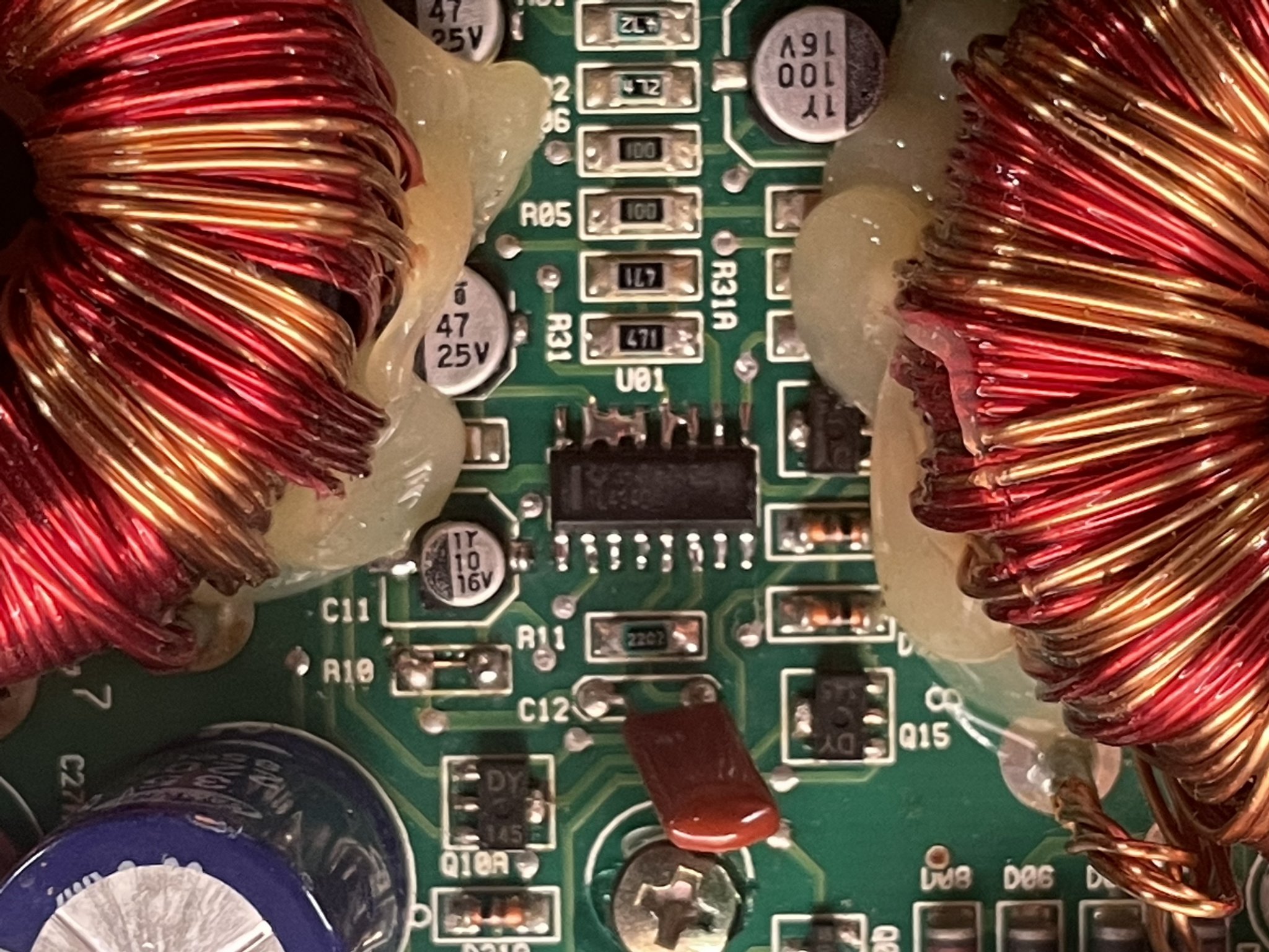

Back on this amp, if I power it up through a limiter, or setting my bench PS to 10vDC, it powers up just fine. As soon as I try to power it up at 14.4v, the PS in the amp freaks and draws excessively.
I thought I disabled both soft-on and soft-off, but now Im not so sure. What do I have to remove to disable soft-on exactly?
I did replace the TL494 and yes those pins are tied at the PCB.
Photo attached
Photo attached
R10 I jumped the other day. I just now removed Q04 and the amp quick-starts and stops just fine. The only issue I see if it even is any kind of issue; amp is running full tilt. No regulation. Is this OK to run like this? Seems fine to me. Amp briefly draws 6A at start and then idles at 2A. Plays.

Ok Q704 removed doesn’t solve the issue. I followed PROT on the schematic and removed one part at a time, mostly 4148 diodes all testing well, disconnecting PROT from each area of the amp, and the amp continued to draw excessively.
The furthest component I can pull, which allows the amp to power on cleanly is actually C704 which is a 4.7u cap tied to ground. If I pull that part, amp powers up fine. I replaced it and tried different values and no help. I'm tempted to leave C704 out of circuit. Thoughts?
