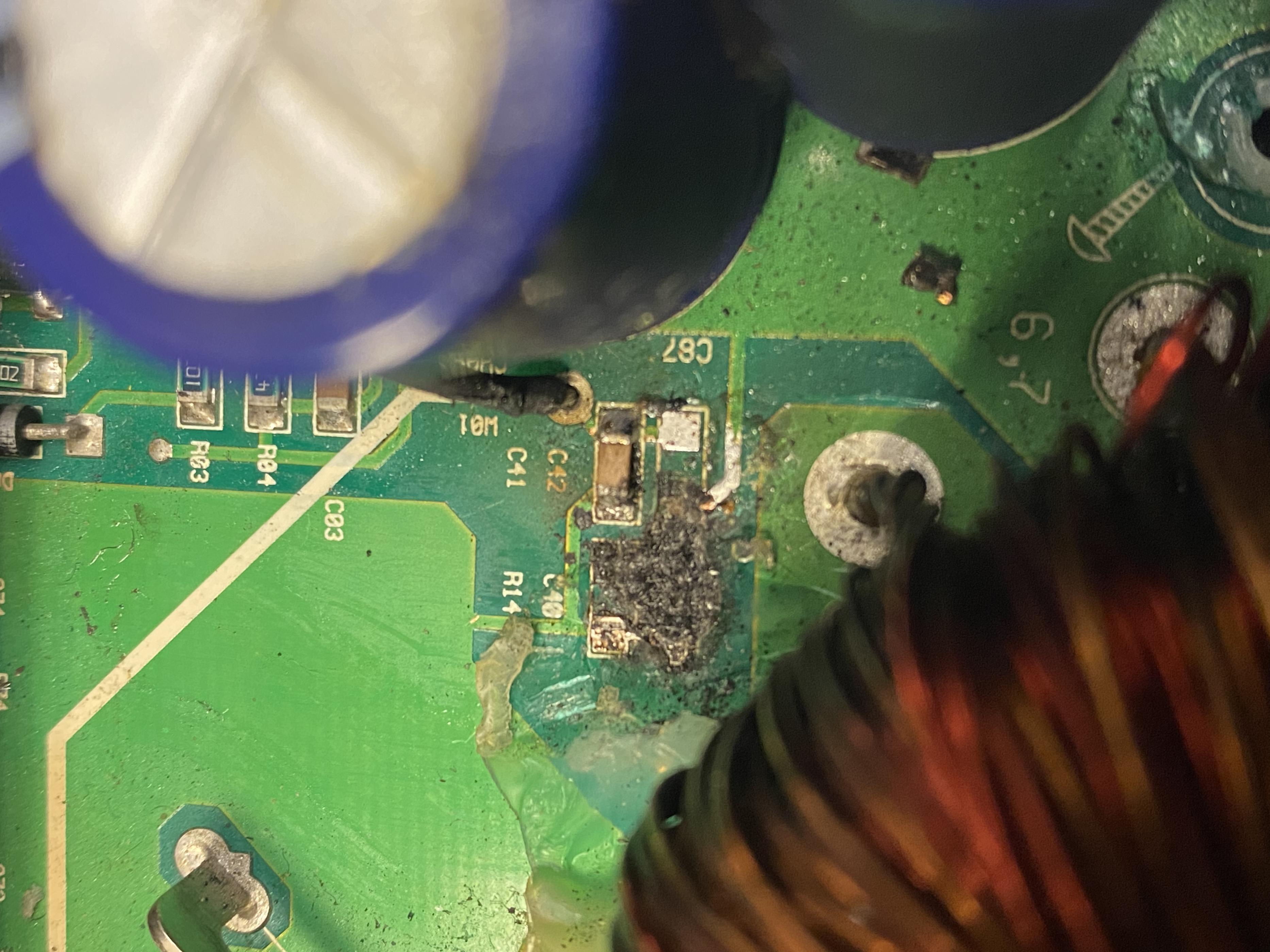

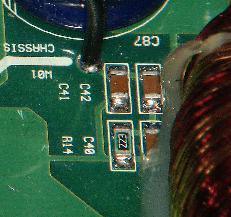

C87 is the electrolytic. 1000uF@100v.
C42 is the damaged cap. 0.1uF.
See attached.

Mine is 1022pf. I don't have the schematic but do have the amp.
I de-soldered what i thought was C87 and measured it at 1022pf.
I have since downloaded the manual and it is supposed be 100n.
Maybe it was replaced, I bought it used?
Do you know the value of C40 ?

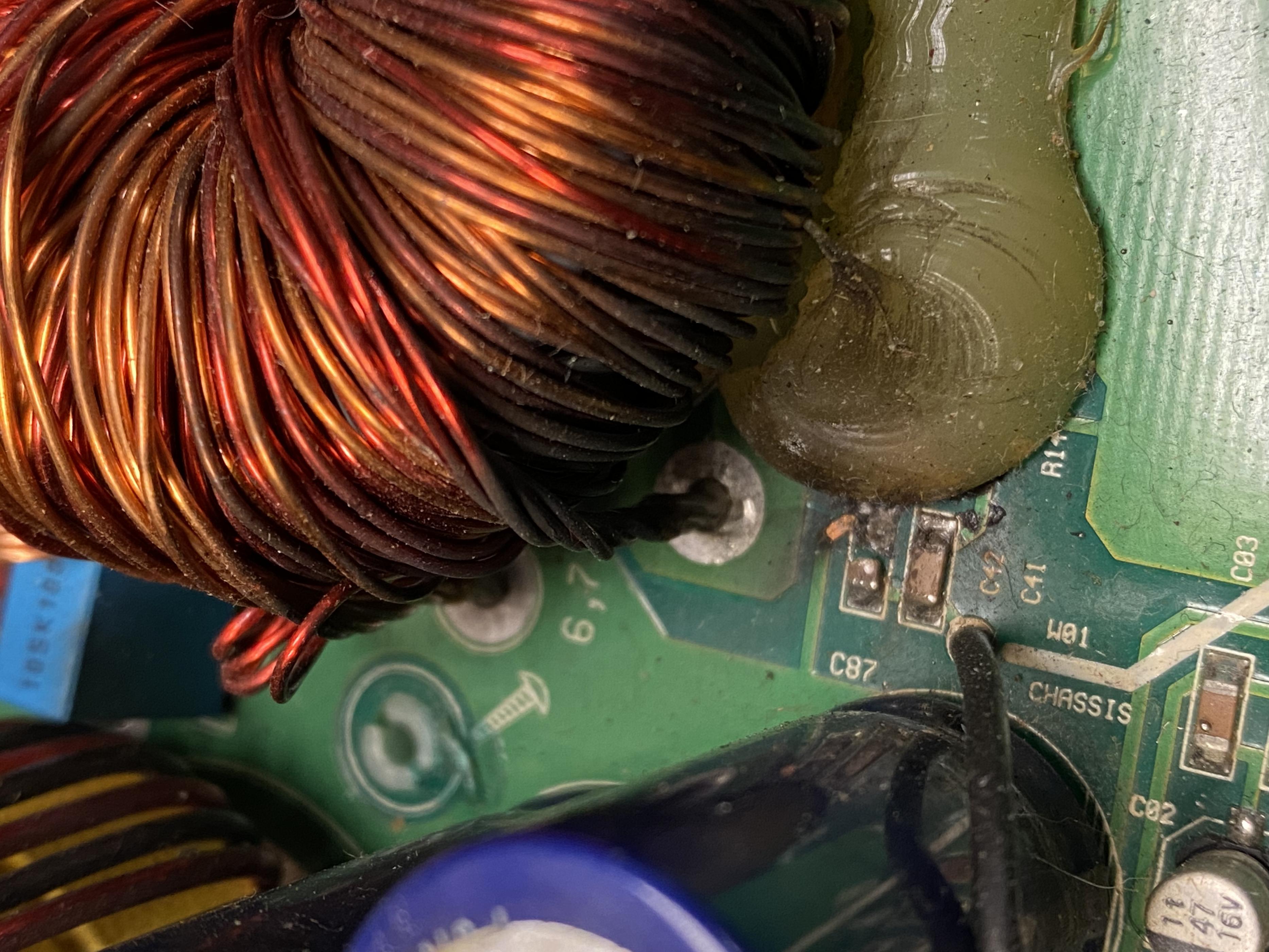

Replaced the caps and resistor .
Next problem I have is I get 13 volts of dc on the rca shield ground .
If I try plugging rca jacks into the amp it will start drawing excessive current

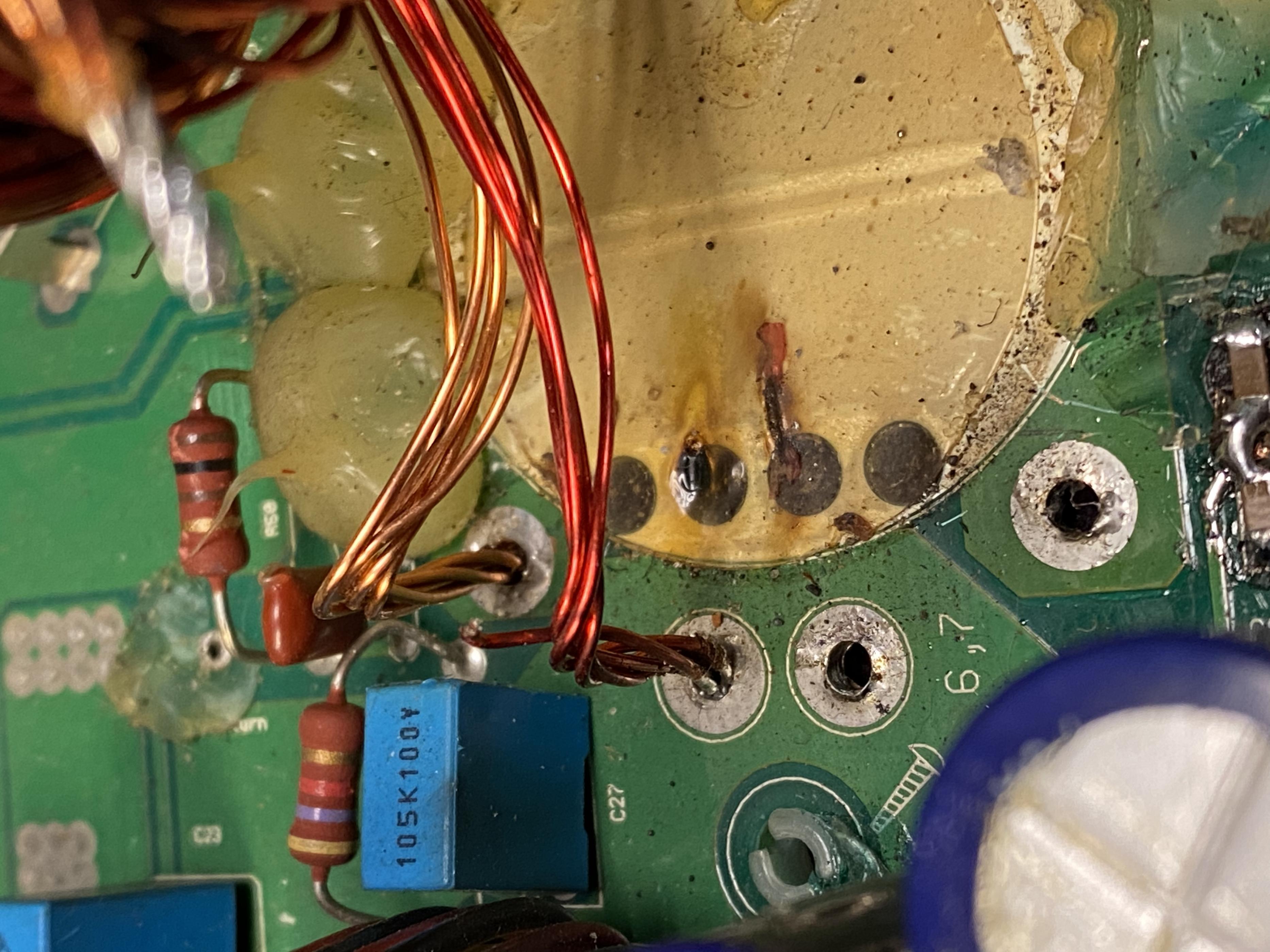

Twisting the transformer has no effect still have 14 volts on rca shield ground
I read a direct short between the rca shield ground and positive battery terminal 0.3 ohms
I will have to remove the transformer and find the shirt since I can see it sparking when I twist it more but can’t break the shorted winding I think the shirt is underneath
