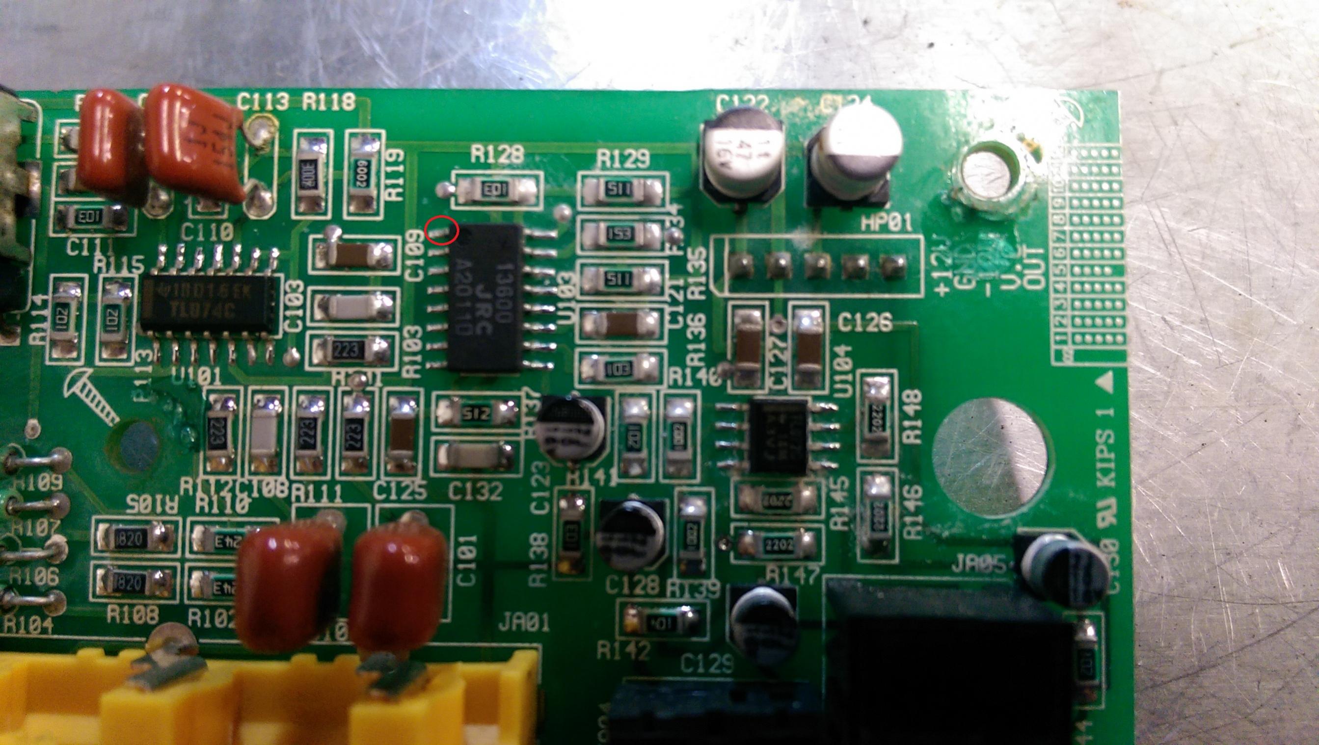

Do you have audio on pin 9 of U103?
See attached, if the red circle indicates Pin 9 of U103, then yes I do have audio there. I wasn't to sure how the pin orientation is Left to Right, Up and Down etc.
Ok, I double checked that, and I do not have audio at pin 1. I checked the one diagonally across and no audio. I got a .055v (AC) reading.

Perry, I made a mistake. I rechecked the TL074s (all the corner pins) and I DO NOT have audio there, I was not checking it correctly. I also have the same voltage on both terminals of C123. The corners of the TL074's are reading the same as pin 9 of U103 & C123 (all reading roughly .050~.055v AC)

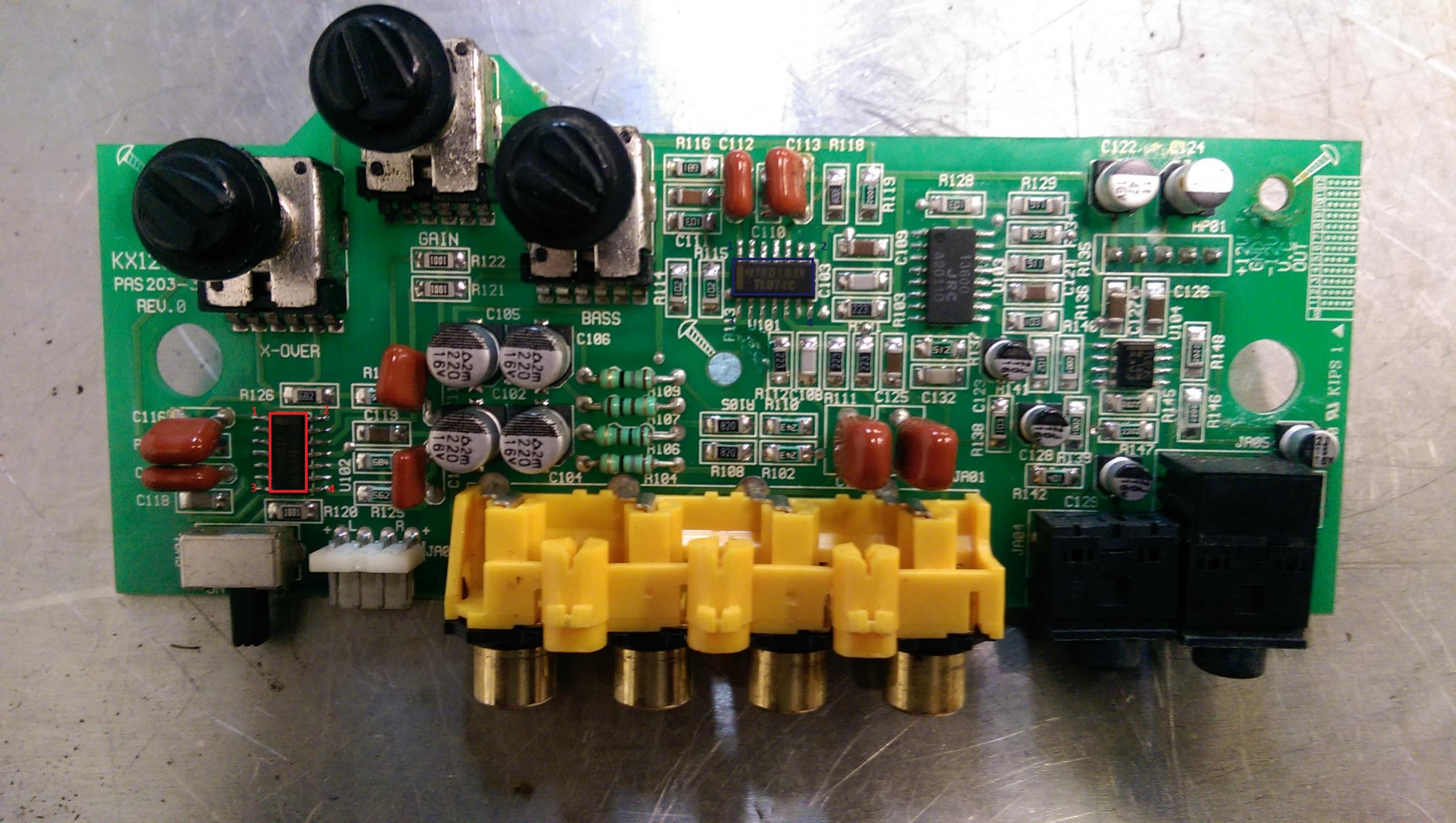

Ok, I downloaded the file, and was getting .580v @ the back of the RCA jacks. Also adjusted everything. I didn't know how to determine the difference between the TL074's so see attached.
red TL074
1 .065
2 .065
3 .065
4 .065
blue TL074
1 .065
2 .065
3 .290
4 .290
The only inputs that changed were pins 3 & 4 of the blue TL074
c123 both pins read .054
Pin 9 of U103 is .065
(Not sure what a 13600 is?)
The op-amps have circuit board designations silk-screened near them. They are U101 and U102. U103 us the 13600.
I'm assuming that you know that you have to have the board in the amp and the amp powered up.
Confirm that you have at least 0.5v on the back of the RCA jack. Then measure the AC voltage on pins 3 and 5 of U101.
