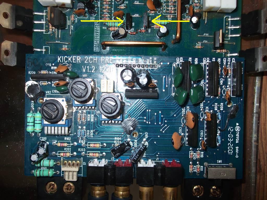

I took the picture of the preamp board as requested, i hope it will work.Im not really good taking photos.

Obviously i dont believe that the amplifier "repaired itself", and when i had like a minute or so with the amplifier playing, i feeled that to transistors (The ones indicated with the yellow lines, Q15 and Q16) started to feel real hot, so i turned off the amp. I waited a little, and turned the amp on again, and the amp worked normal, but these two parts still were getting hot, in like a minute or so. So i hope that this information i got will help. Thank you very much.
Q15 is labeled 2SD669
Q16 is labeled
2SB649

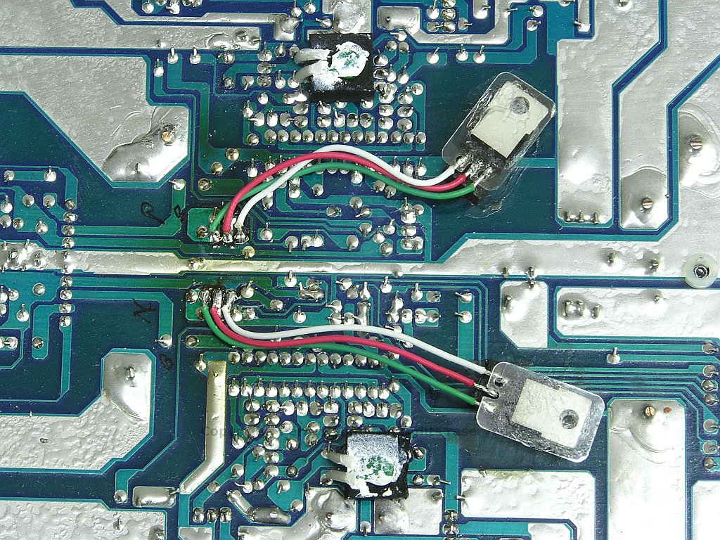

They often fail because they operate at such high temperatures. The intermittent -15v is likely caused by oxidation of the solder connections for the B649. The attached shows one solution that holds up well. The transistors are 2N6488 and 2N6491 (B649).

If you are going to re-use those transistors, add new solder, desolder them and resolder them. You must get rid of the old solder.
You can use a different type of heatsink but it must not have its weight supported by the transistors unless it's very lightweight.
If the backs of the transistors have an exposed metal area, you need to use an insulator between the sink and the transistor unless you can be absolutely sure that the heatsink cannot come in contact with anything else (not even the other heatsink).

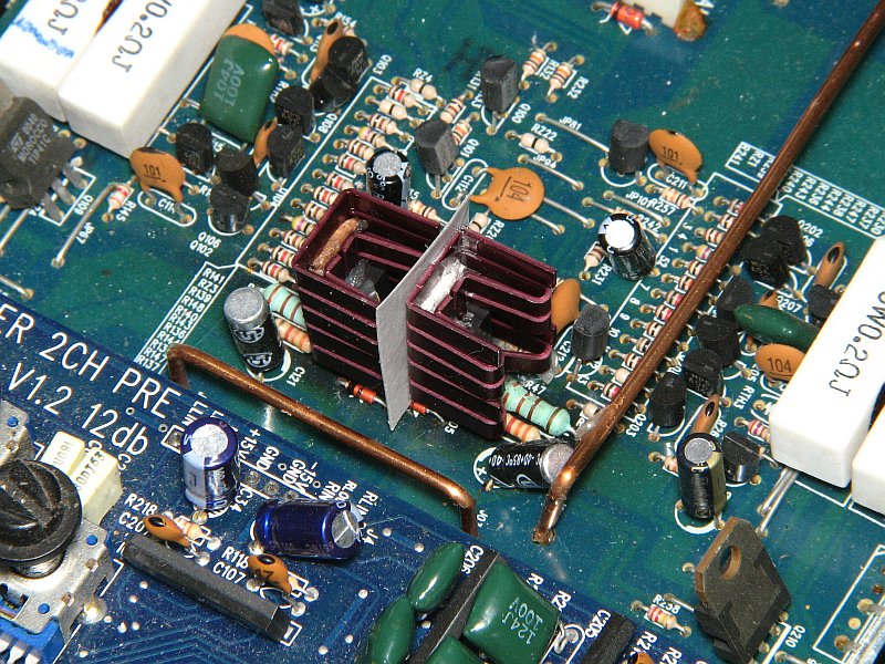

Regulator transistors get hot. That's normal. If you have a capacitor that's leaking (electrically) on the output of the regulator or have a defective op-amp, that could make them heat up more than normal but those problems are relatively rare.

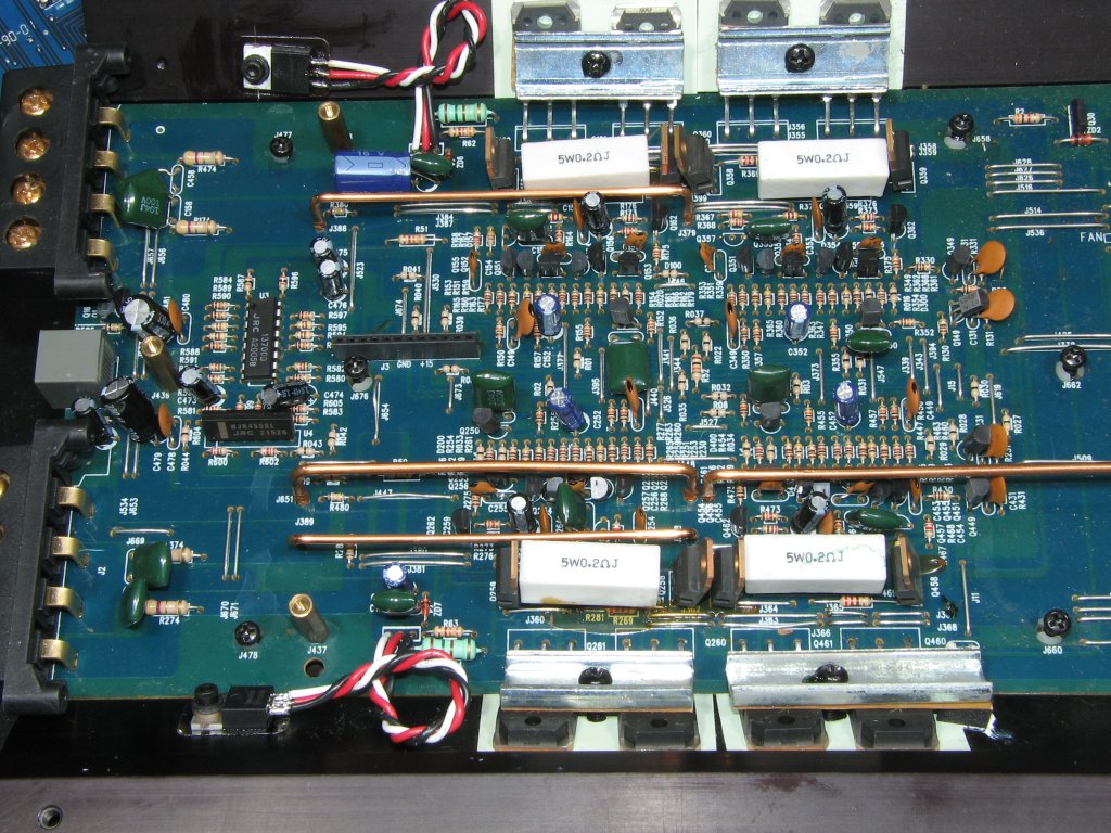

In some amps, I move the regulator transistors to allow them to contact the heatsink. In the first image there is a piece of closed cell foam between the transistor and the board. This keeps the transistor tightly against the heatsink. If you do anything like this, you must make sure that the transistor is insulated from the heatsink.

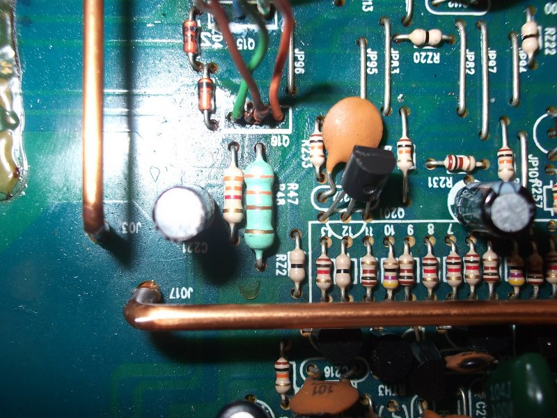

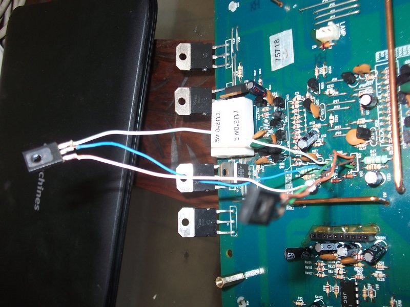

I decided to put both transistors in the heatsink of the amplifier. I have some sil-pads laying around, so i drilled a bit and they are ready to install. I have checked again the amp before assembling and i noticed that the blue resistor besides B649 gets very warm to the touch, in like 20 seconds is enough hot so i checked i made a bad solder conection or bridged something. Needless to say, the amp works as before, im just not trust about that part getting hot. I will have to ask, is this normal too? im afraid to burn something else.

Both R47 and R45 should be the same temperature. It's normal for them to get hot.
With no power applied, confirm that both are within tolerance (±5%).
With power applied, confirm that the voltage across ZD4 and ZD5 is the same.
Deburr the holes you drilled so that the transistor can lay flat against the heatsink.
