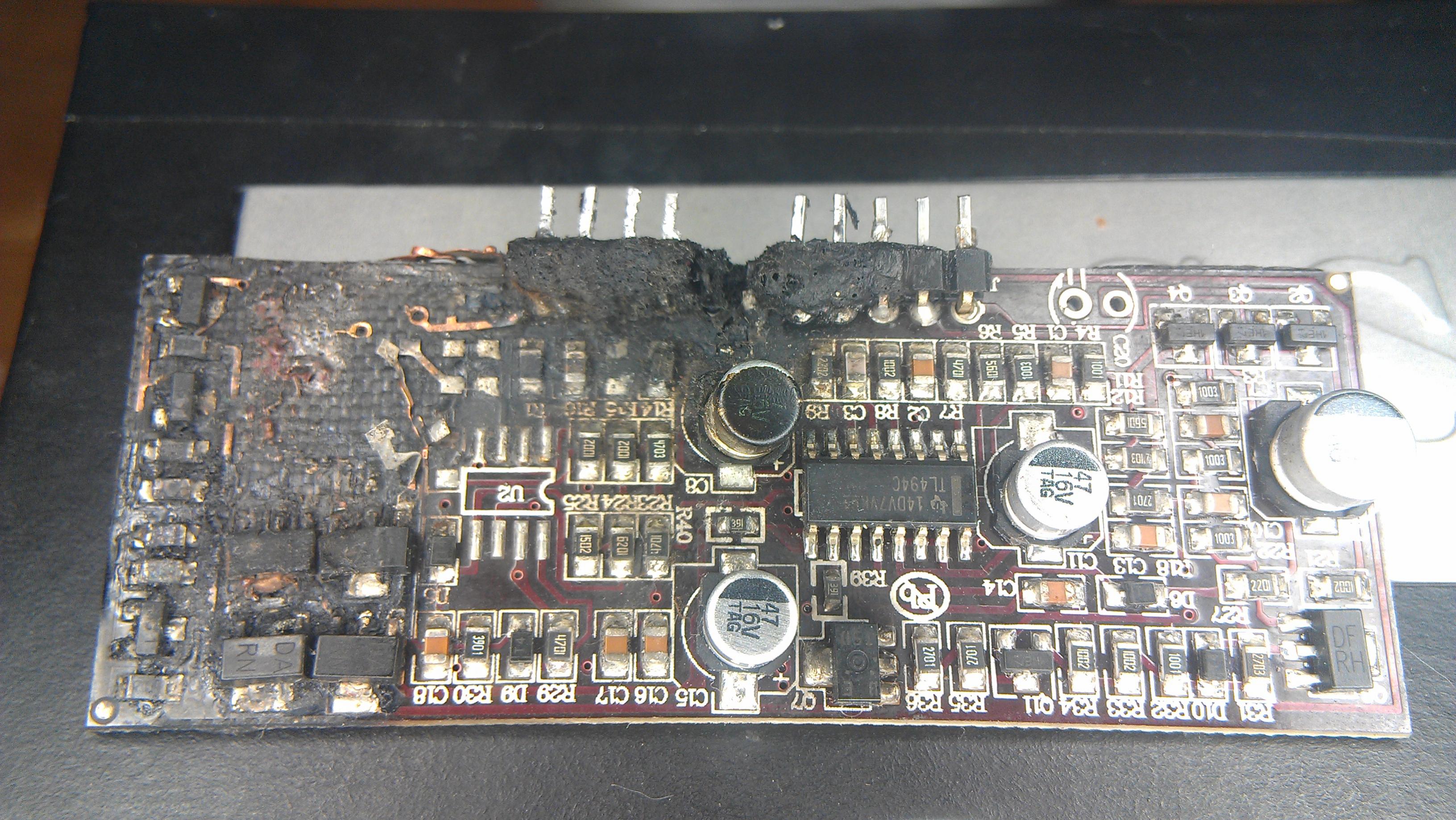

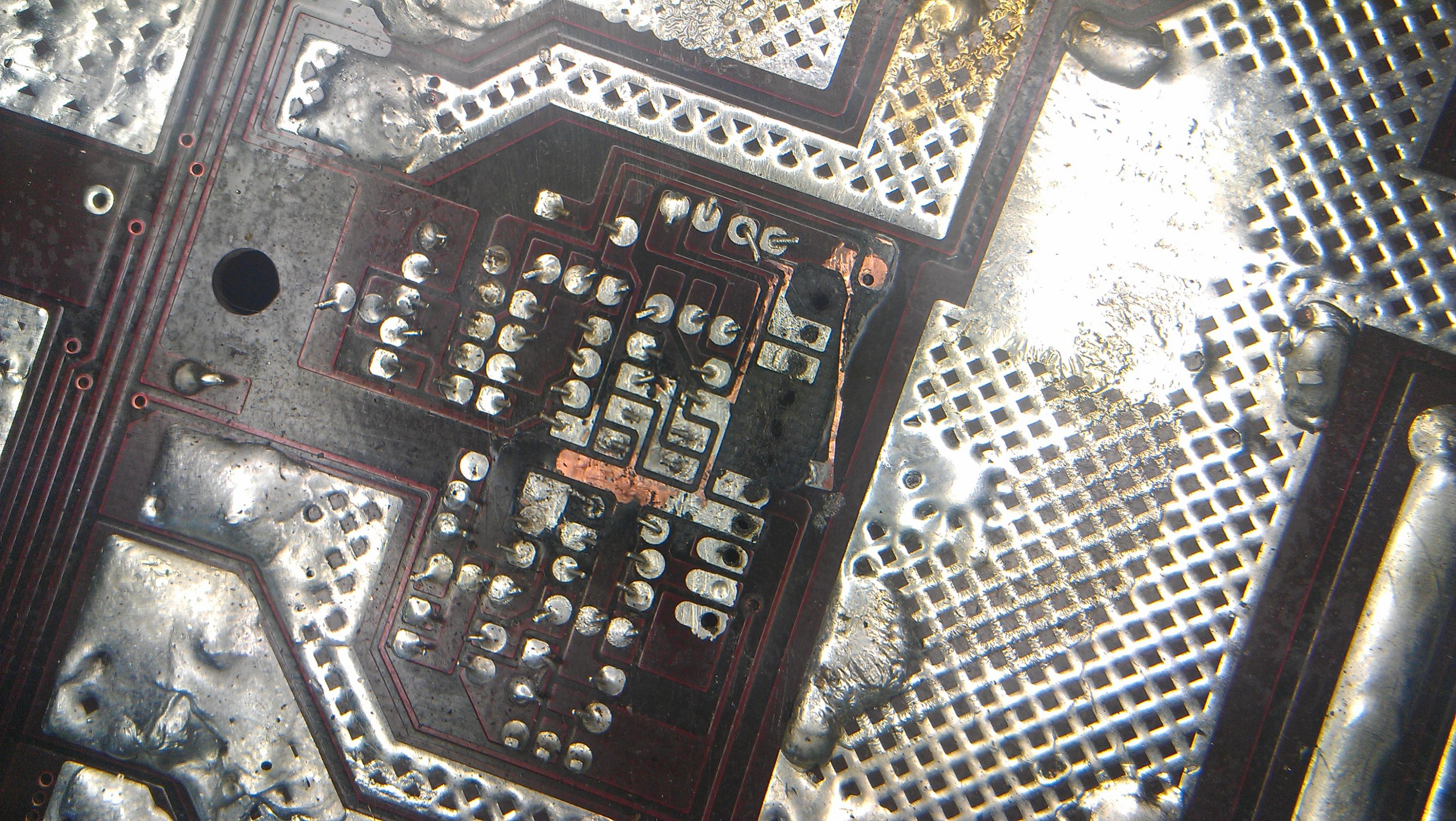

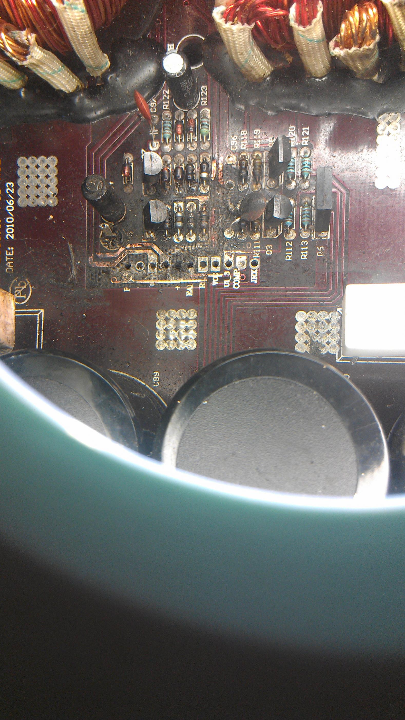

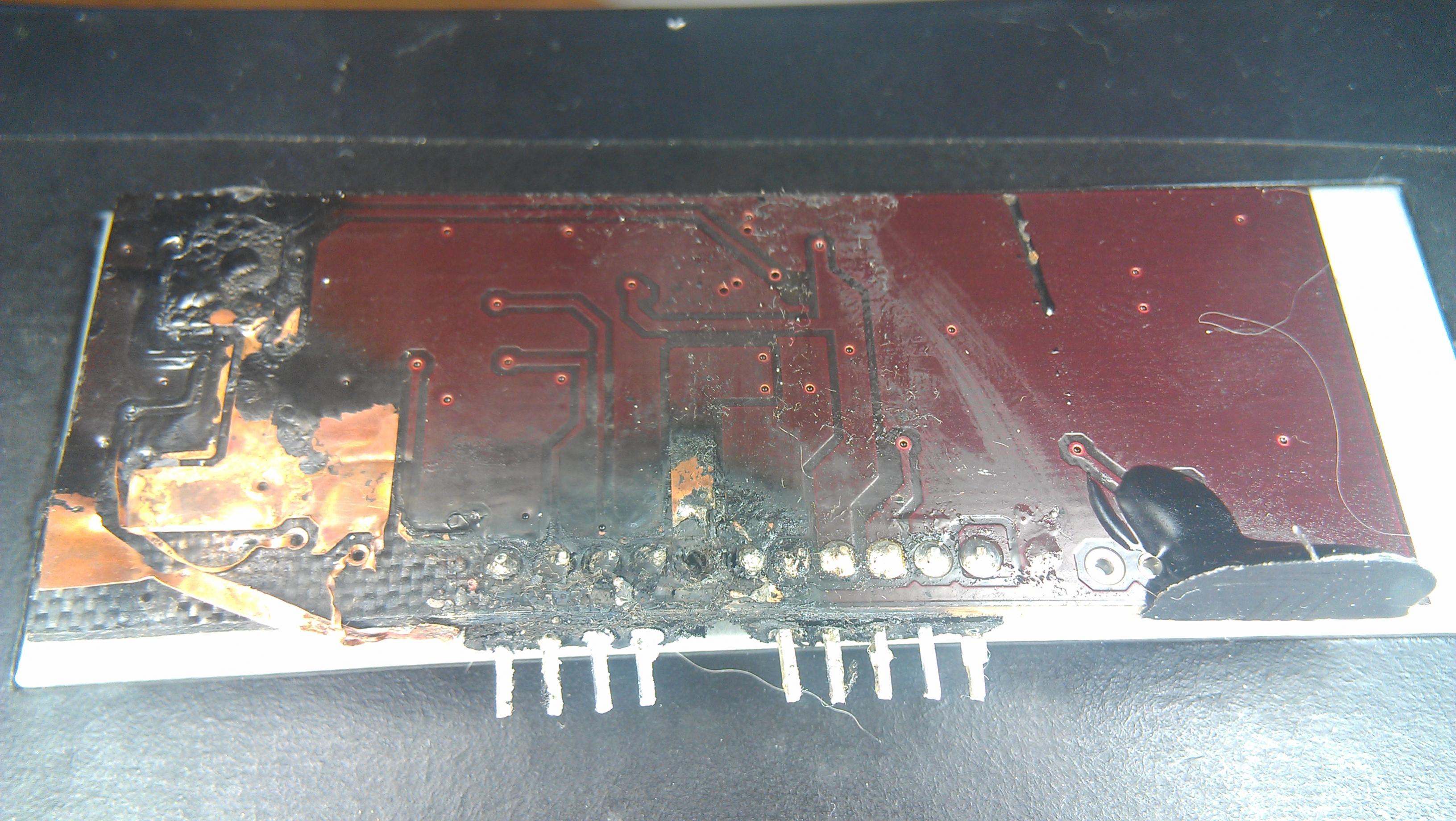

I need the driver board and a parts list of the driver section with a picture or schematic of an unburned board (the driver board smoked and destroyed all indentification of the surrounding components on the main board)
Pics of driver board and main board

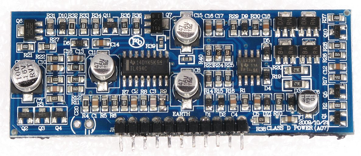

Ok I took some pics I also noticed the board was dated 6/23/2010. but the amp is described 2012. It looks like a typical Class D power supply. Useing a TL494.

It also uses IRFP064N FETS, FMU32U rectifiers and F1B30CA outputs.

New info
Ok new info the driver board in the EX2000 is the same as one from a Lightning Audio LA1000MD maybe other models. So if anyone has any other these amps laying around working or not with good driver boards Im interested
Well no luck with Rockford they stopped repairing the Lightning products, so Im back to rebuilding this or a new driver board.
Anyone know the value or the gate resistor of a IRFP064N? The one on the board are pretty brown, and when I measure them off the board the read anywhere from 11-18 ohms.

I would write that thing off as a total loss. It really is a total loss....
Only option at this point is finding a donor unit.
Your gonna need a parts amp.
You mentioned you already contacted kicker? they had sold me parts in the past. If they dont carry this PCB then your SOL unless you find a donor, or someone that had already parted one out.
But then, there is reverse engineering and making your own PCB.
I may end up with a schematic from Rockford then that is what im gonna do, its alot of work but ireally dont have much to do with my freetime.
Well what I would do, is see if you can get more detailed photo shots of that driver board. Then you can clone it, and make a new one. I had to do this only 1 time ever. it was a maxxsonics based amp, I had to make a whole new driver as the old one was dipped in epoxy.
