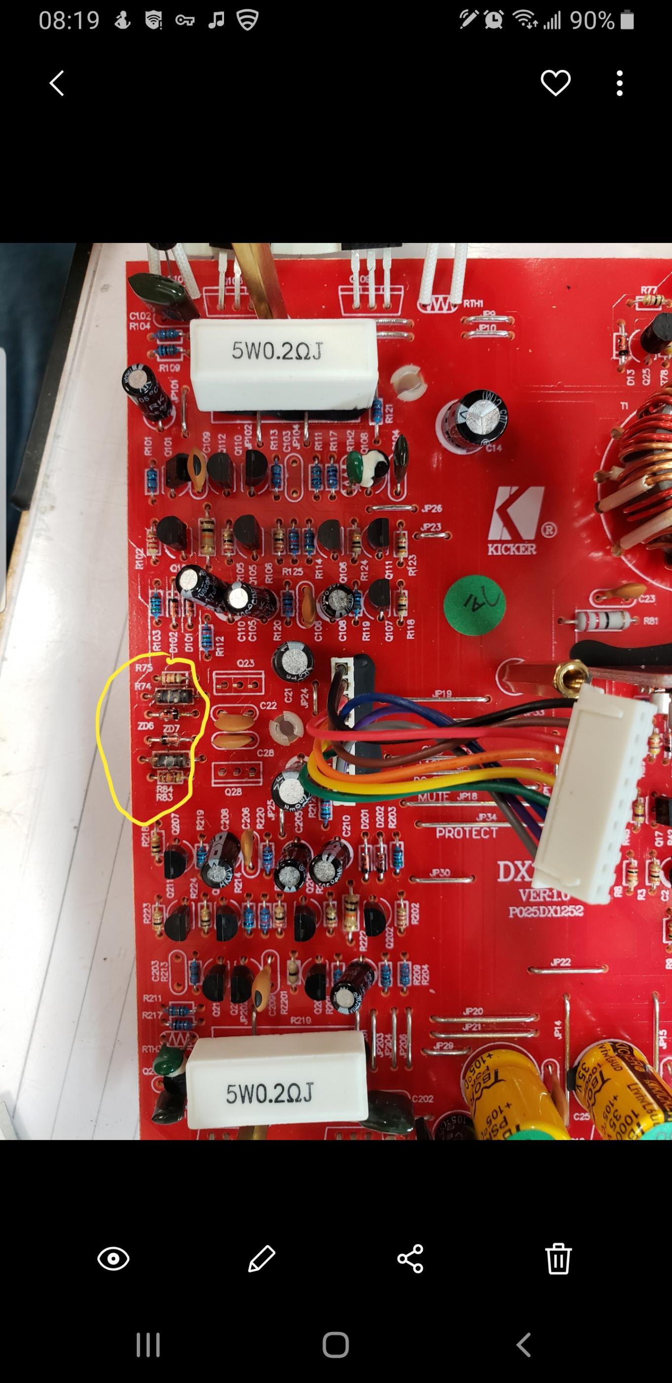

I am looking for the resistance value for R74 and R84 for this Kicker DX125.2. Maybe someone has a picture of the guts. Thanks

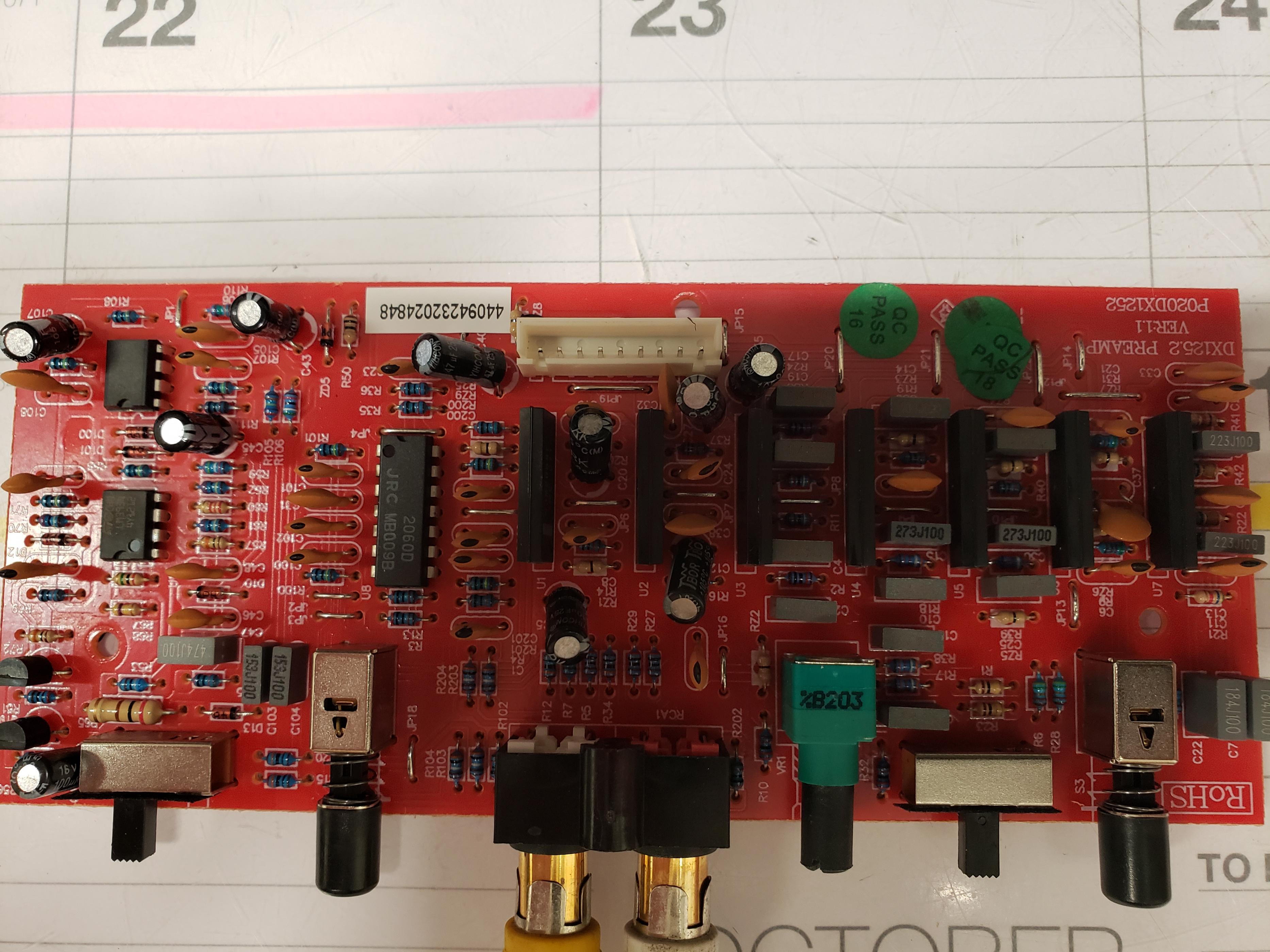

There is a shorted opamp. Desolder Pins 4 and 8 of each opamp, starting with U8. After each opamp recheck with an ohmmeter to see if the resistance returns to normal,should be megohms. There will must likely be several failed opamps.
