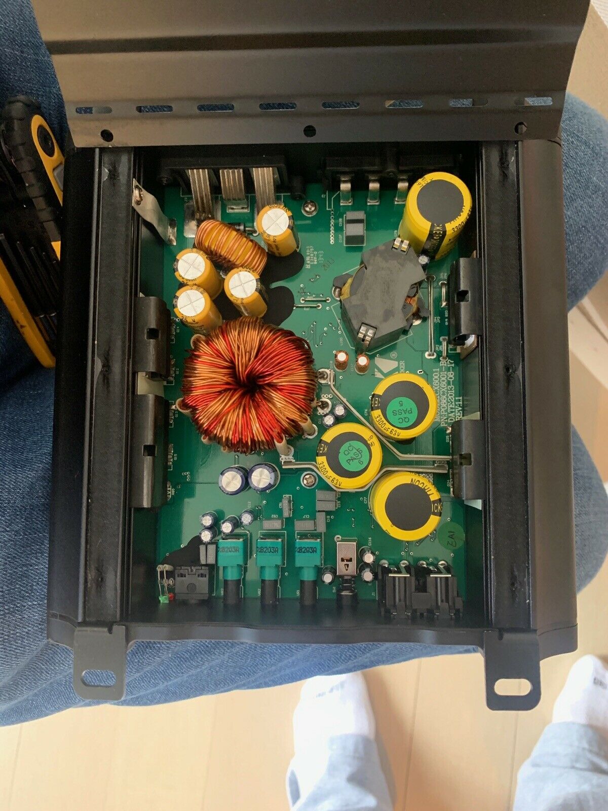

Anyone know what power supply fets this amp takes or that I can use ?

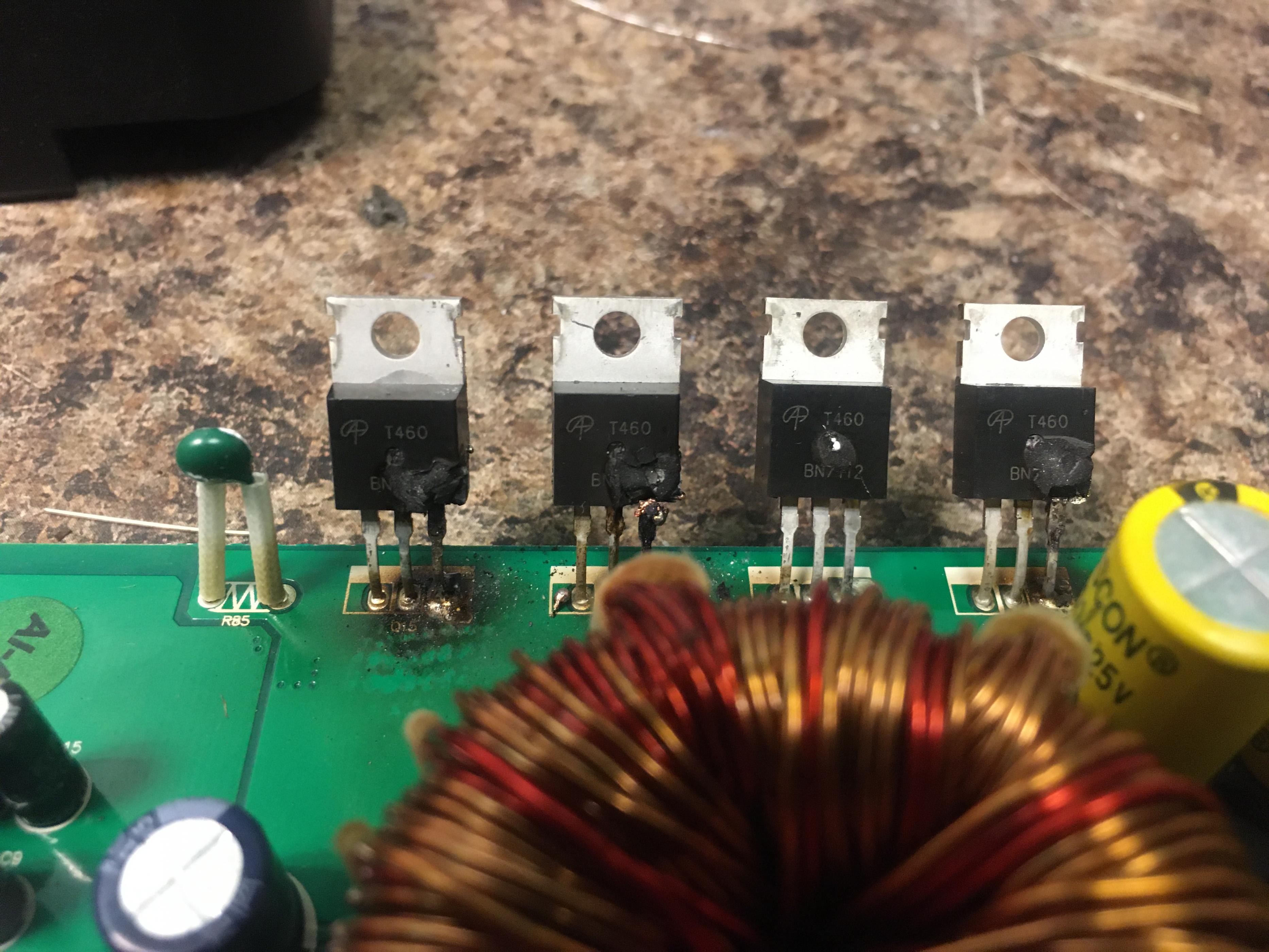

The original ones are burnt and the only numbers I can see appear to be BN7112
Also does anyone know what outputs belong in this amp ?
https://datasheet.octopart.com/IPP200N15N3GXKSA1-Infineon-datasheet-41473792.pdf
https://datasheet.octopart.com/AOT460-Alpha-&-Omega-Semiconductor-datasheet-17018142.pdf
These should be the part numbers. Someone will correct me if I'm wrong. The AOT is obsolete so wait for a confirmed substitute.

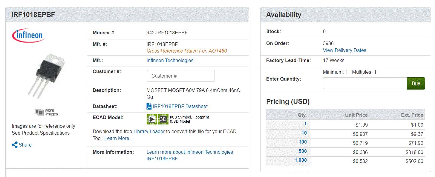

I’m just waiting to see if anyone knows a good replacement for the AOT parts .
