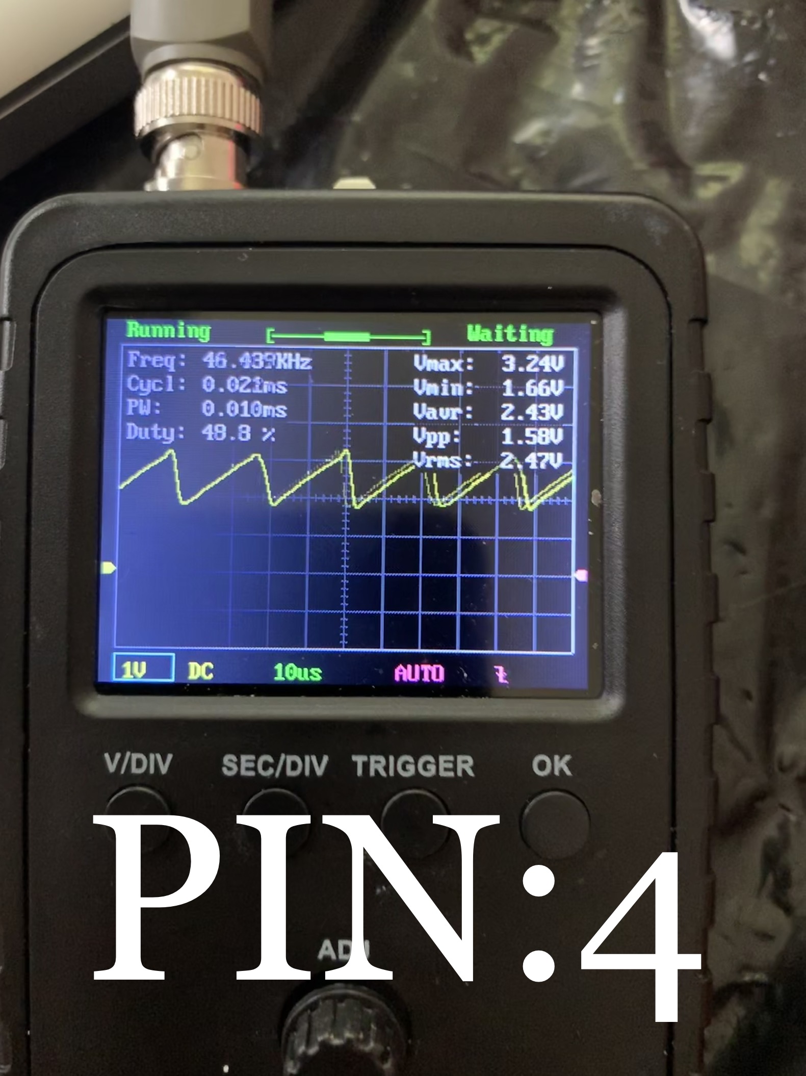

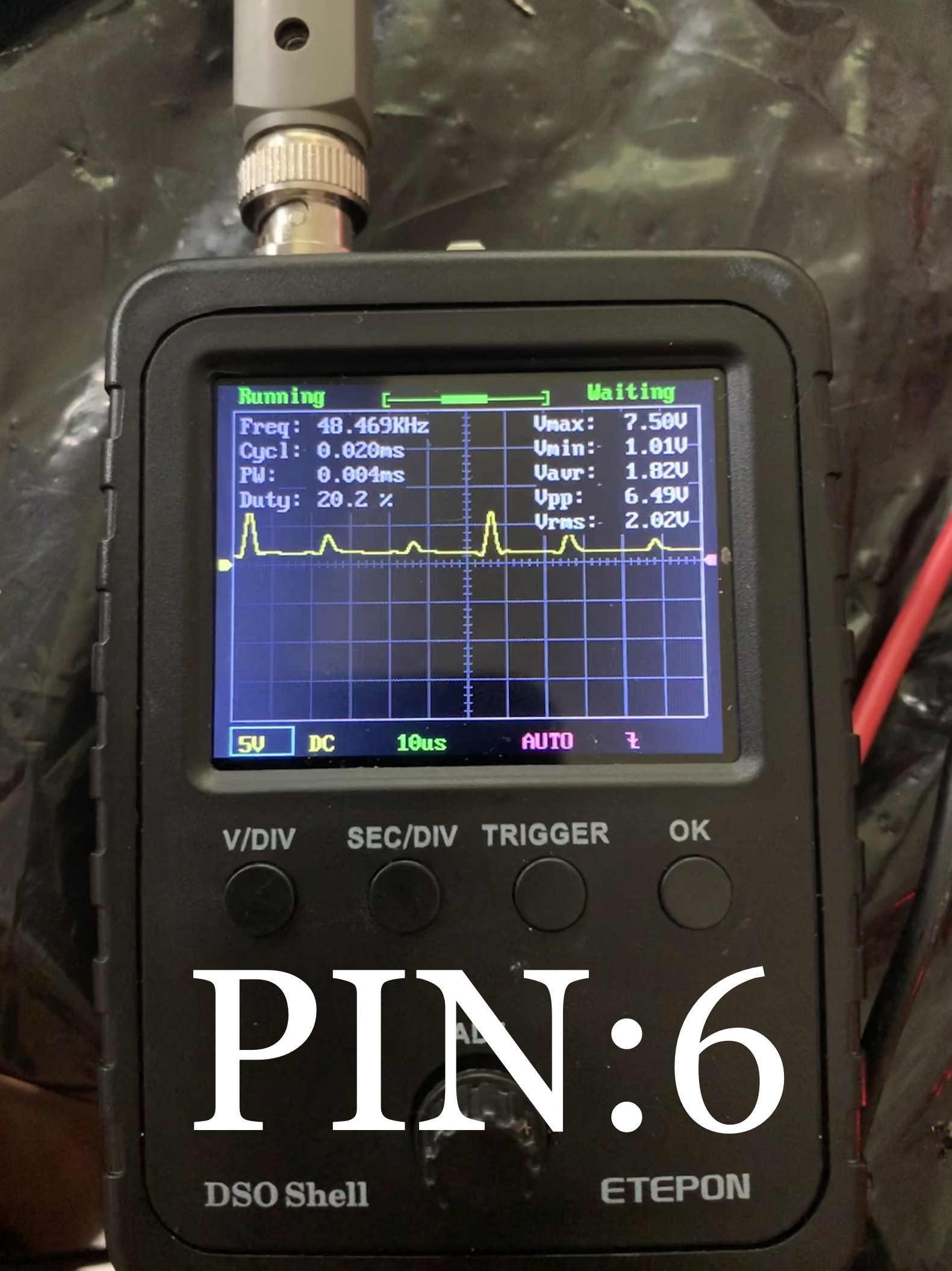

Bought this amp hooked it up and instantly went in and out of protection while making a ticking noise. I took it apart in my lab and realized one power supply fet was hot. The fet tested bad so bought 3 new Fets for power supply. Checked the UC3843B and found the following on the pins with Fets out:
pin 6 and had the same pulses on gate pad of mosfet
pin 4 sawtooth

The Drive pulse on Pin 6 is wrong. Are the screenshots taken before or after you replaced the PSMN3R5-80PS Mosfets?

The screenshots are with the PSMN3R5-80PS out.

The triangle wave looks nominal but the drive from Pin 6- UC3843 should be a short duration squarewave.

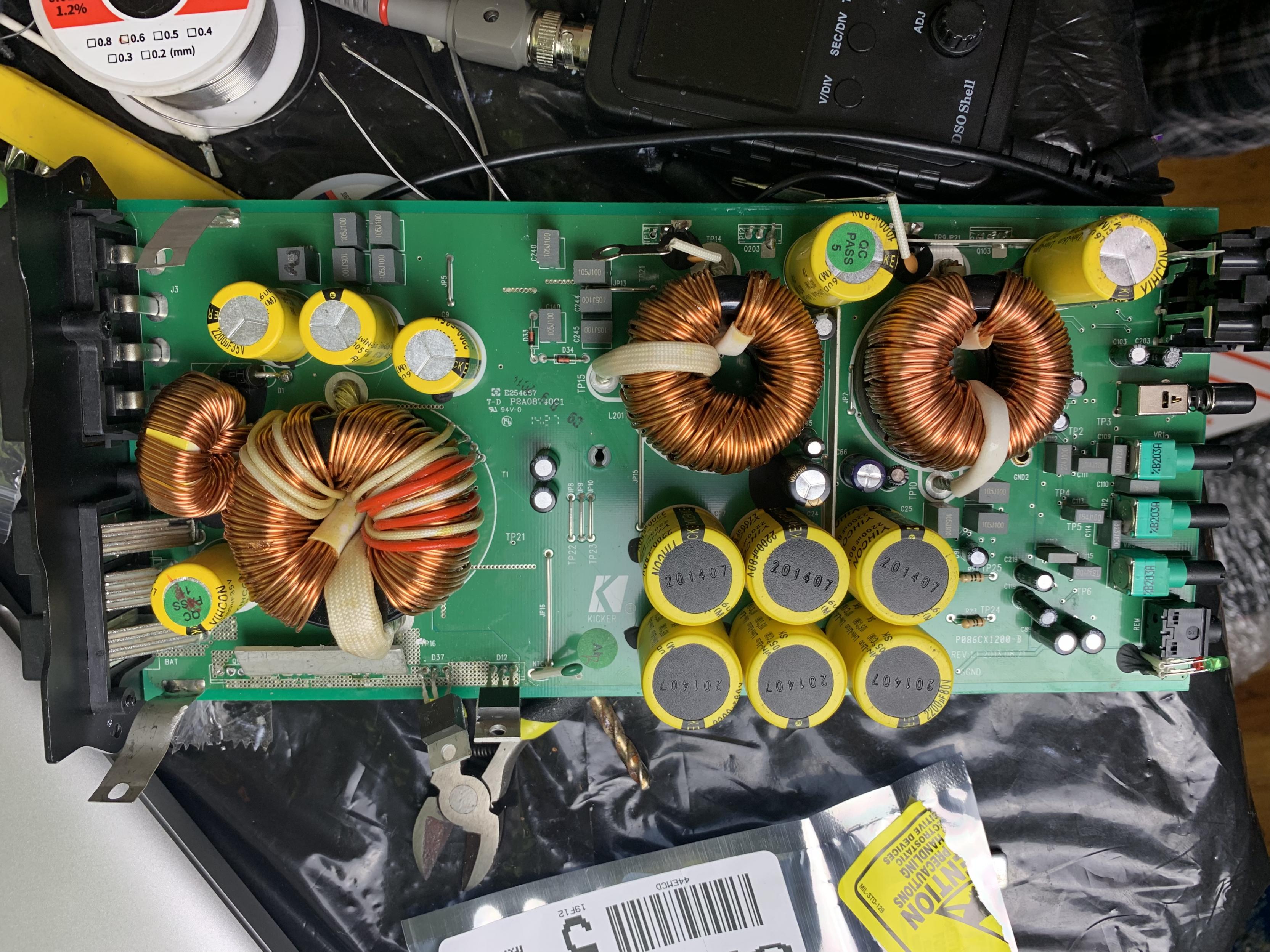

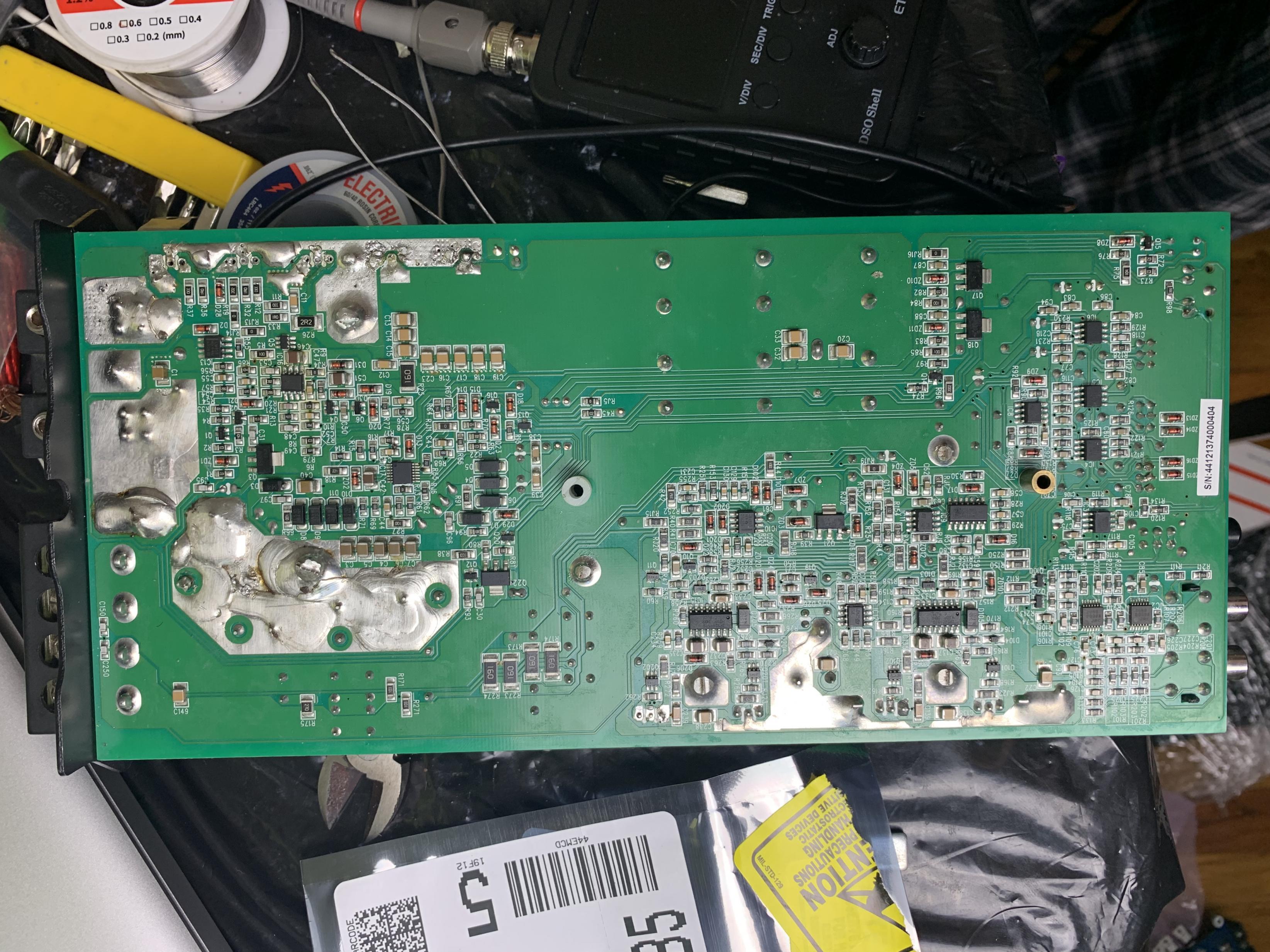

Post a good quality pic of the board.
The problem is most probably in the output . Once I have a pic I can more readily guide you through troubleshooting.

Posting a pic will allow me to edit and point out testpoints etc. Also,I will be able to determine which of the Revs you have. Newer versions use a Microcontroller for the protection circuitry, older versions use an LM339.
