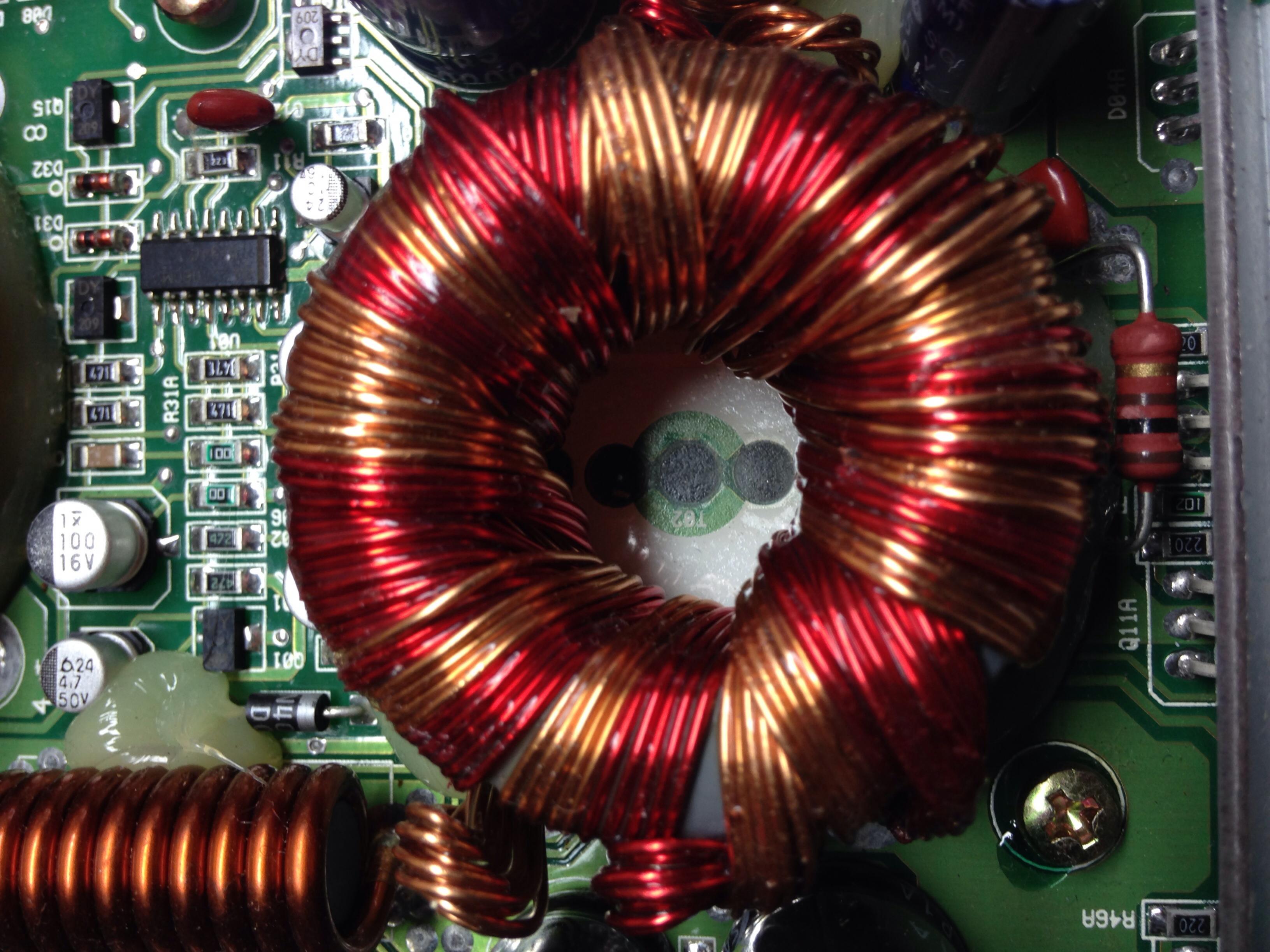

The noise isn't likely significant. Loose windings will make noise.

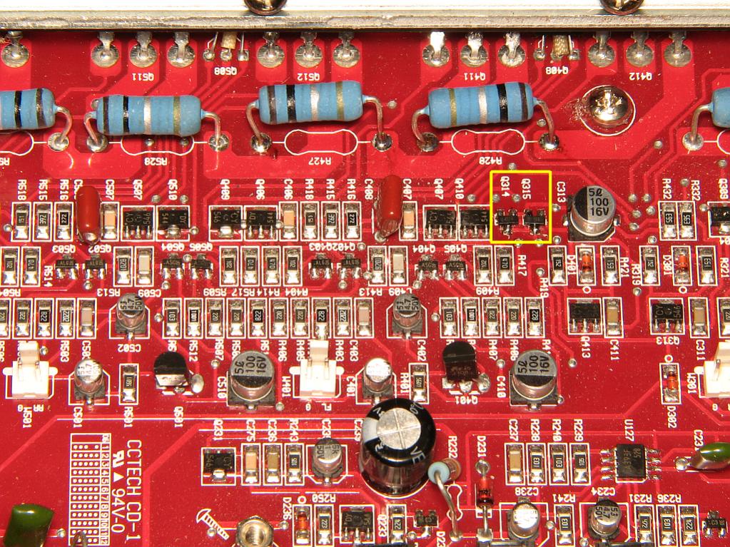

In a similar amp, Q314 and Q315 can leak (electrically) and cause the amp to go into protect for no reason.

I didn't look to see what q314 or q315 are but can I replace those to make it stop going into protect?
There are no guarantees that this will solve the problem. IF there are no legitimate reasons for the amp to go into protect, there is a good chance that replacing these will solve the problem.

The originals are KTC3875GRs but they're difficult to find. I use the MMBTA06 to replace them.
