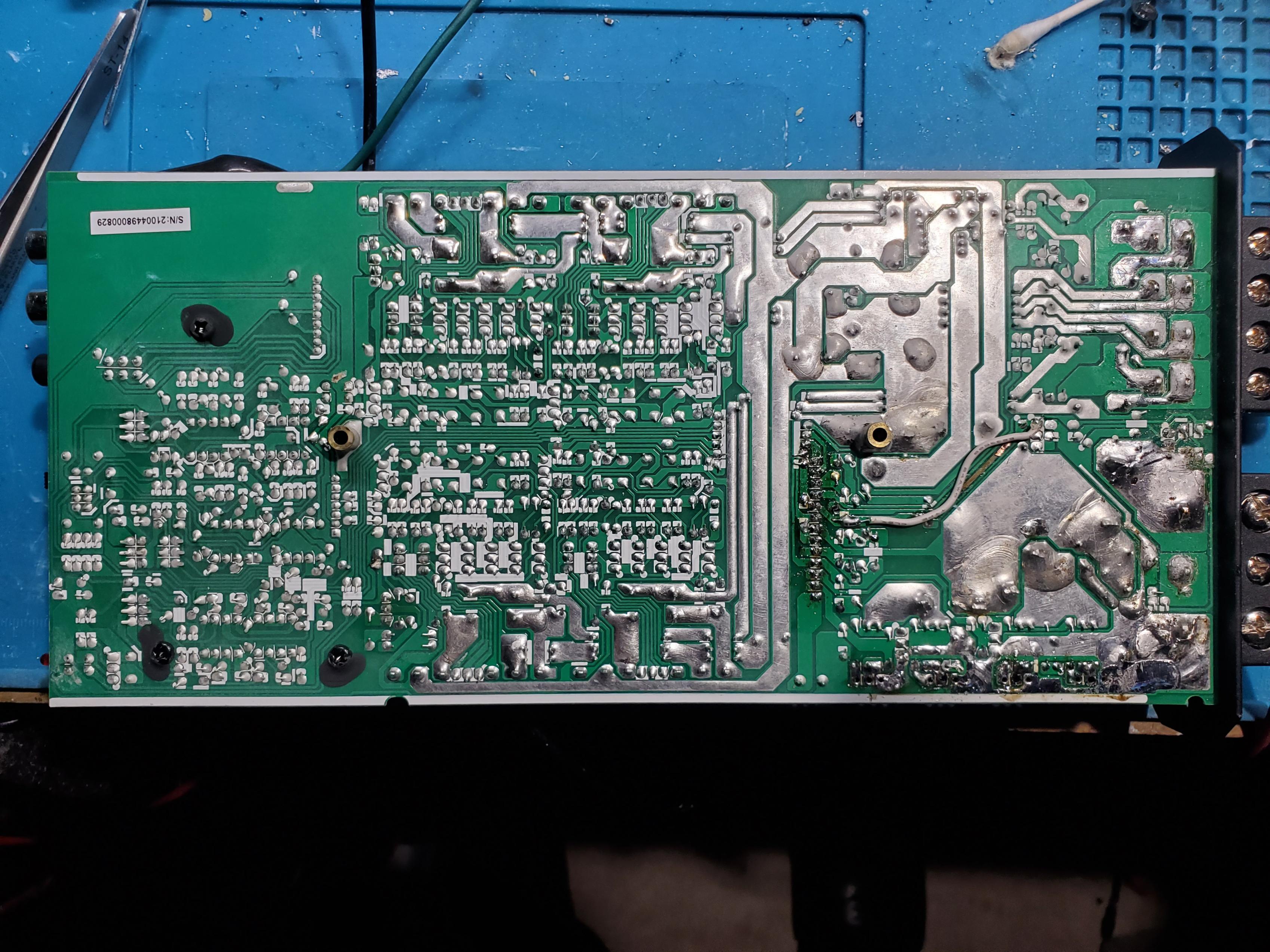

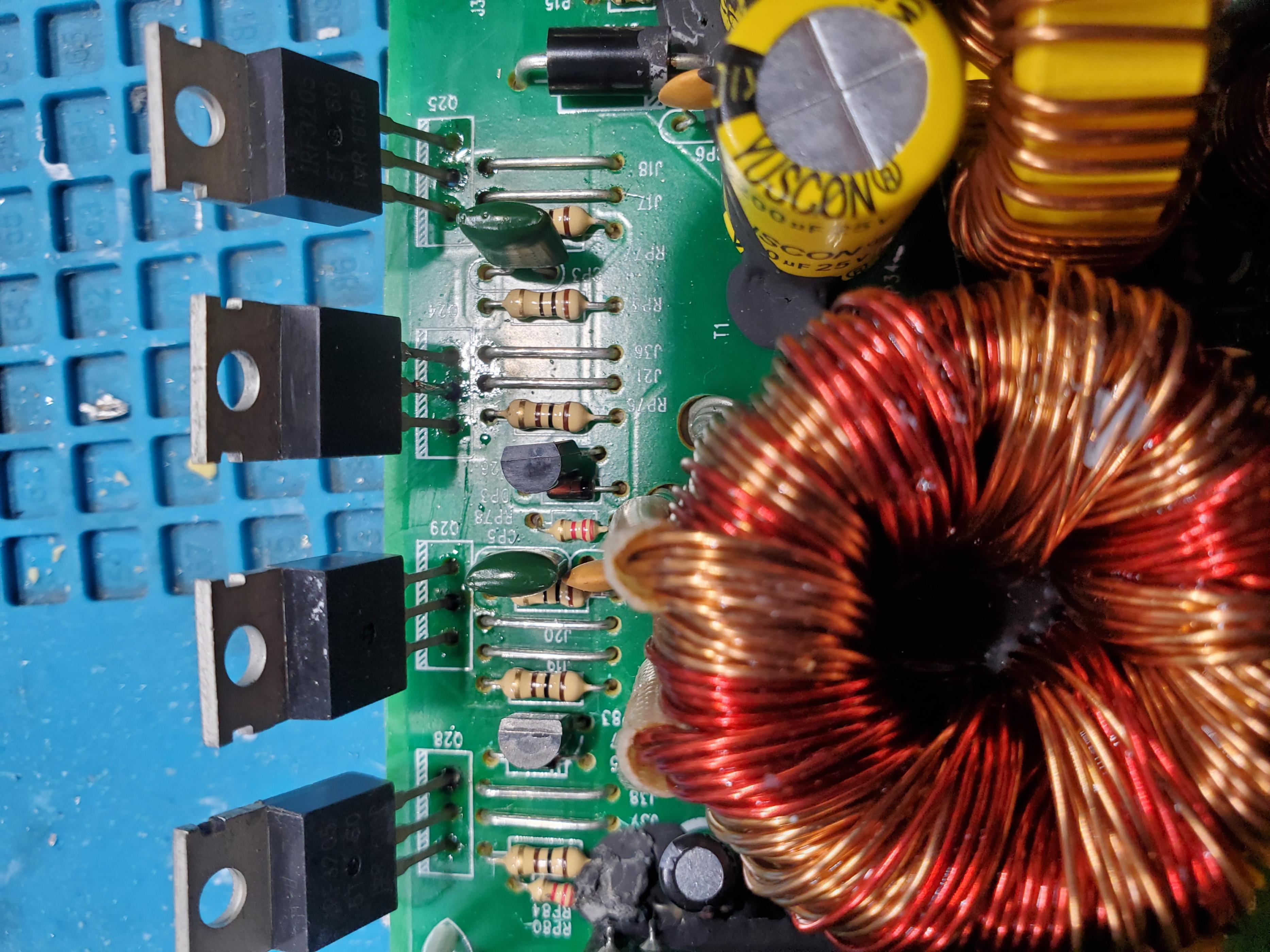

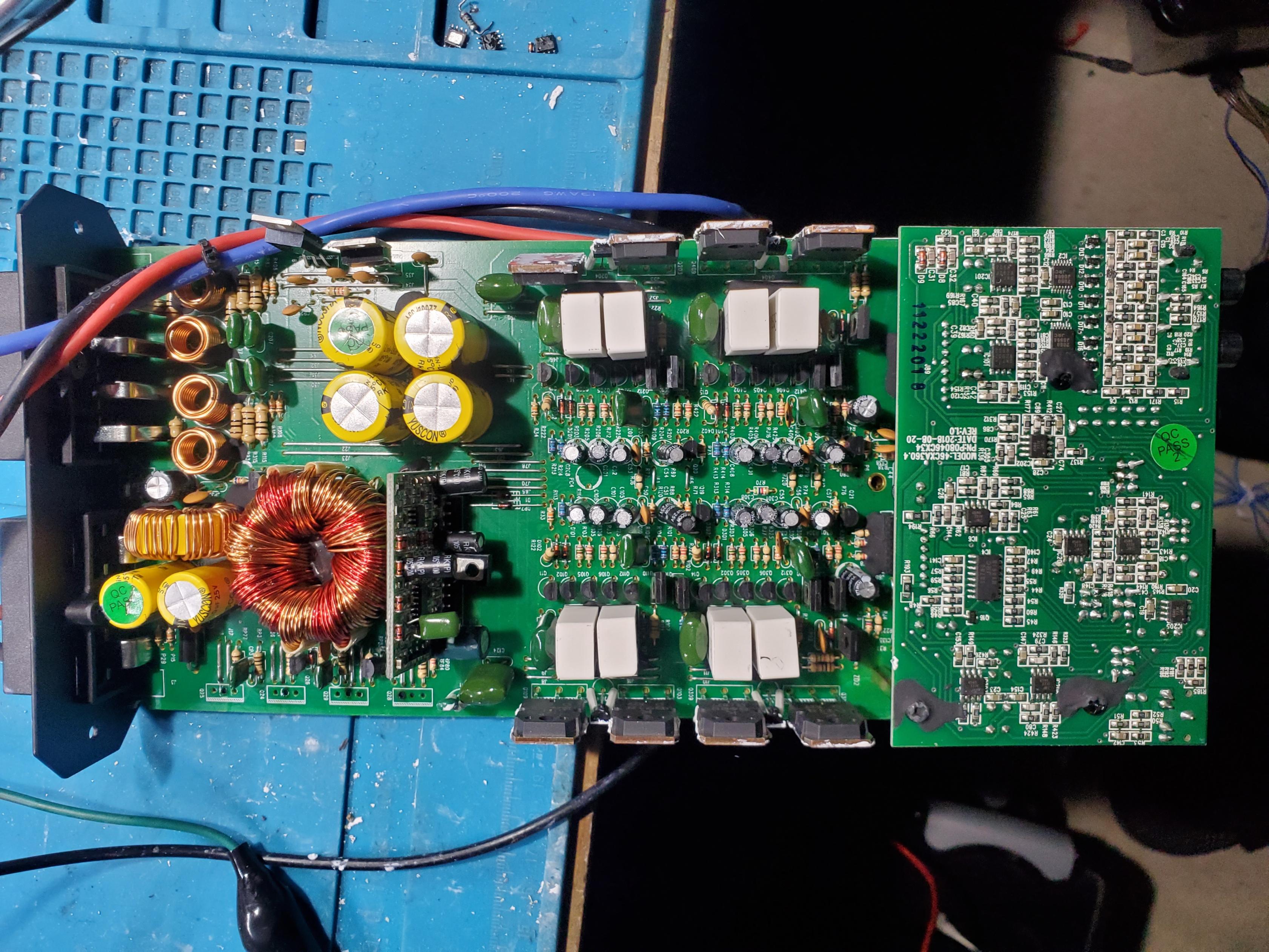

need help with drive, only 2 of 4 have a drive sign returned.
changed tl494c, replaced q5.
some help would be welcome. despite changing the 494c i still can not get drive on 2 of them. i dont have drive at both pins of the ic, only one.
Pins 8 and 11 of the 494 are tied together and should have B+ voltage on them.It would be unusually for this to happen.
Check to see if Q26 and Q27-2N4403 have drive on the base. If yes one of the drivers is bad,or a trace to the gates or gate resistor is open. If no follow trace back to the PWM card.
Drive was working i meant to say.
Installed new 3205 transistors.
Amplifier is still in a protection state.
If its still like the 300.4 then lifting the protection resistors r33,r34,r88,r89? should narrow it down.

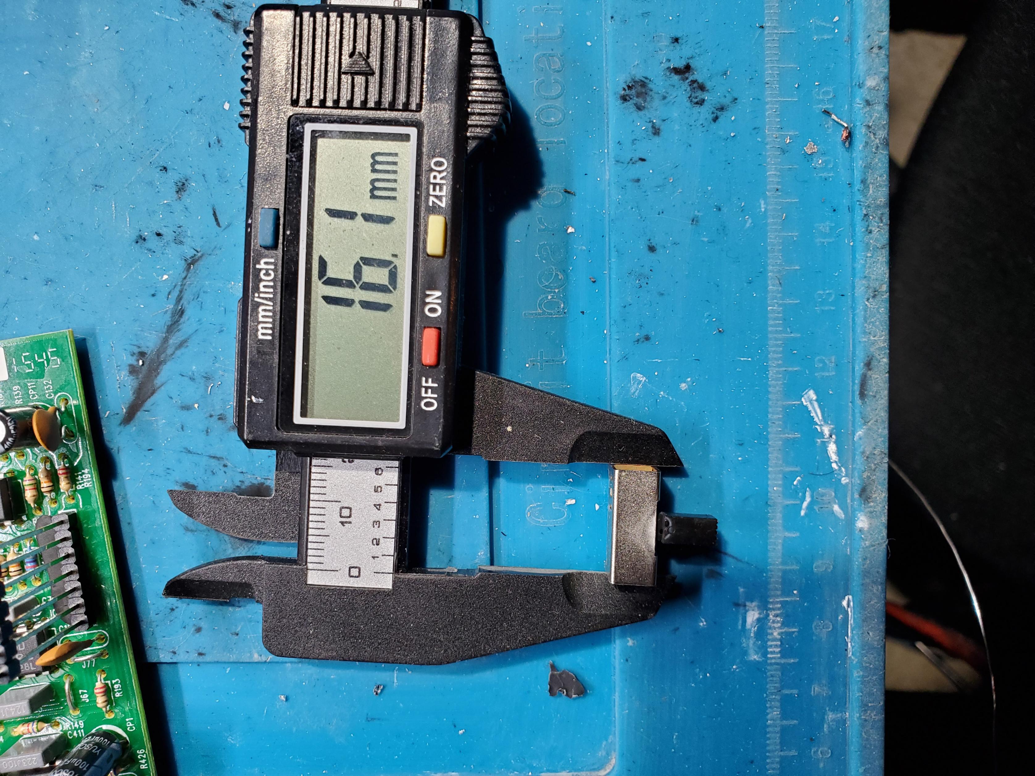

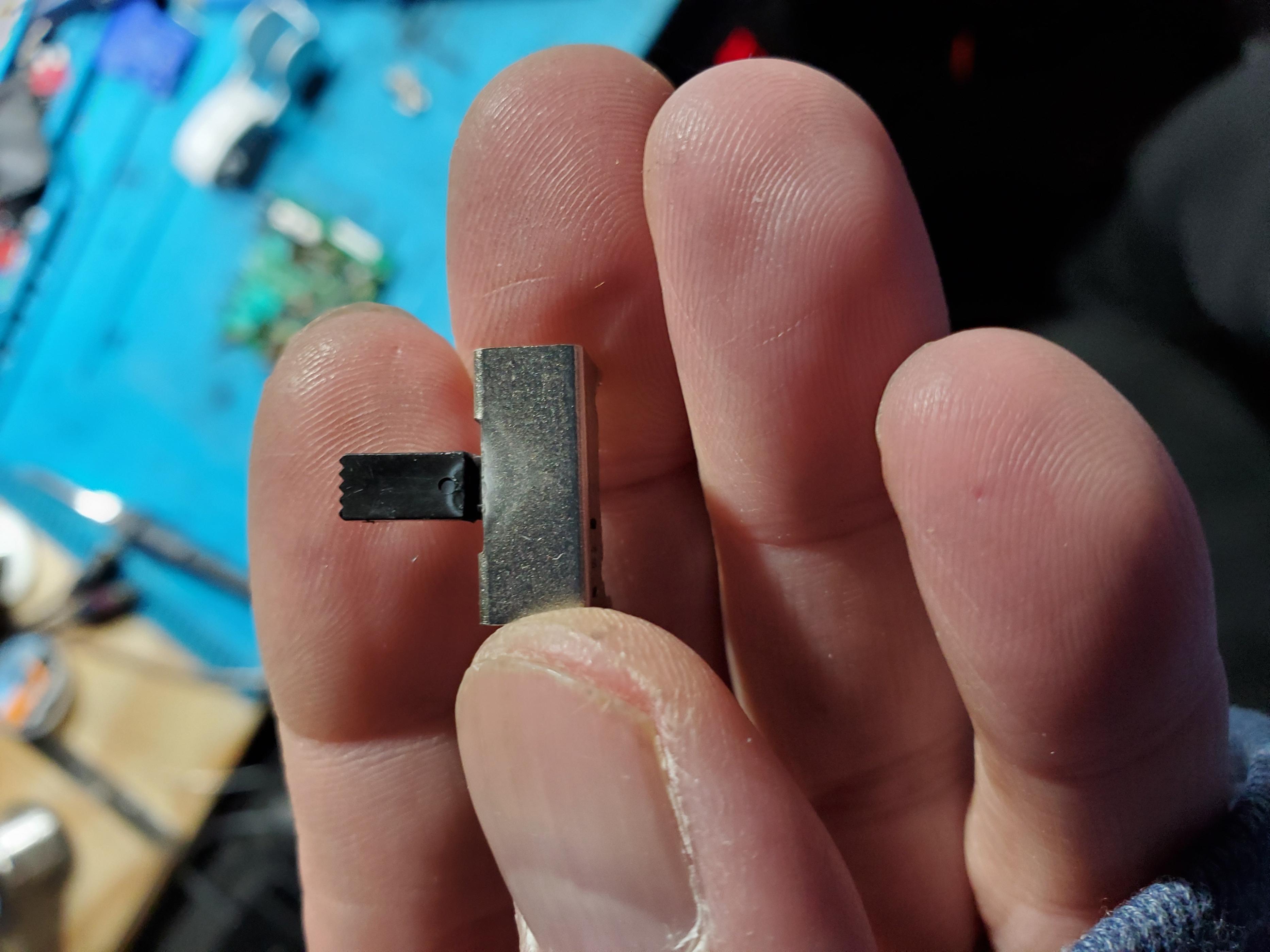

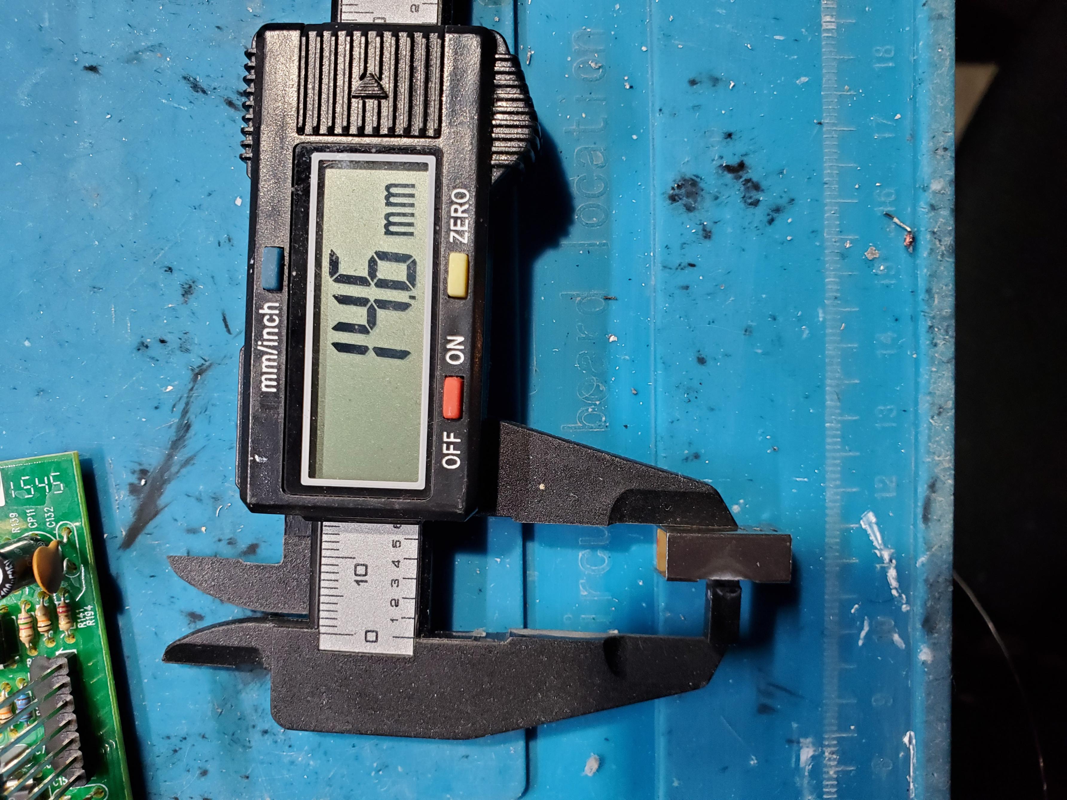

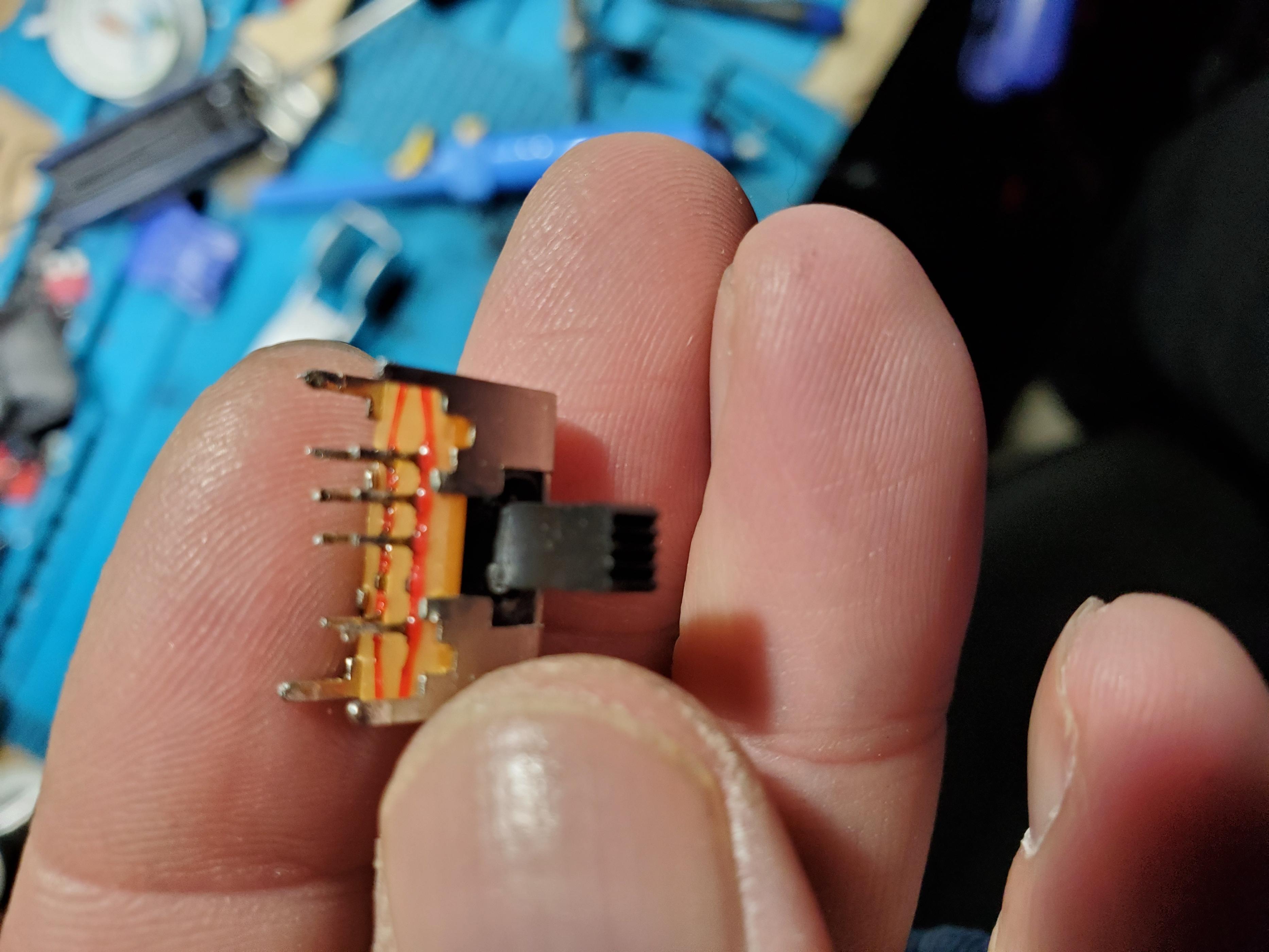

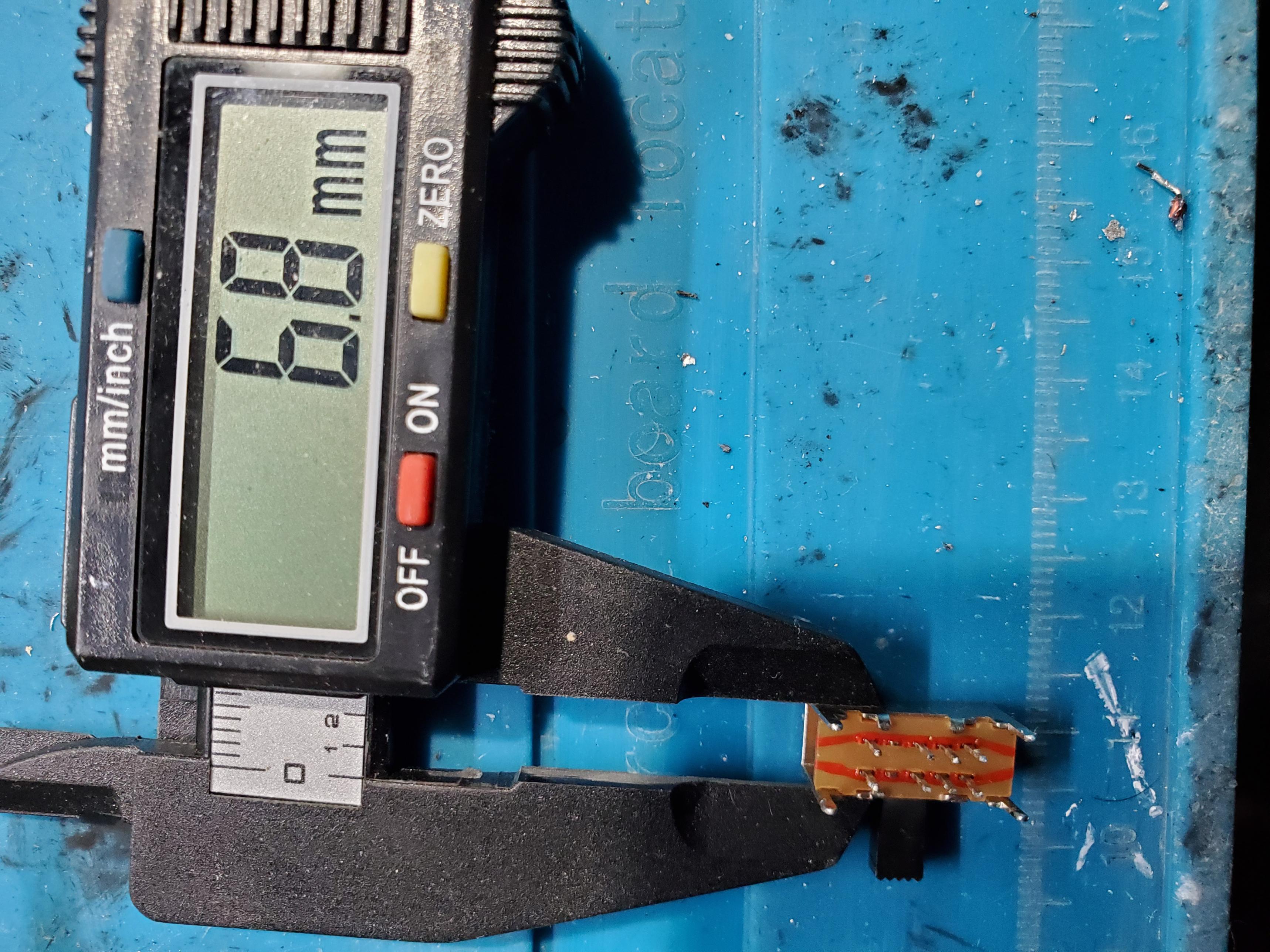

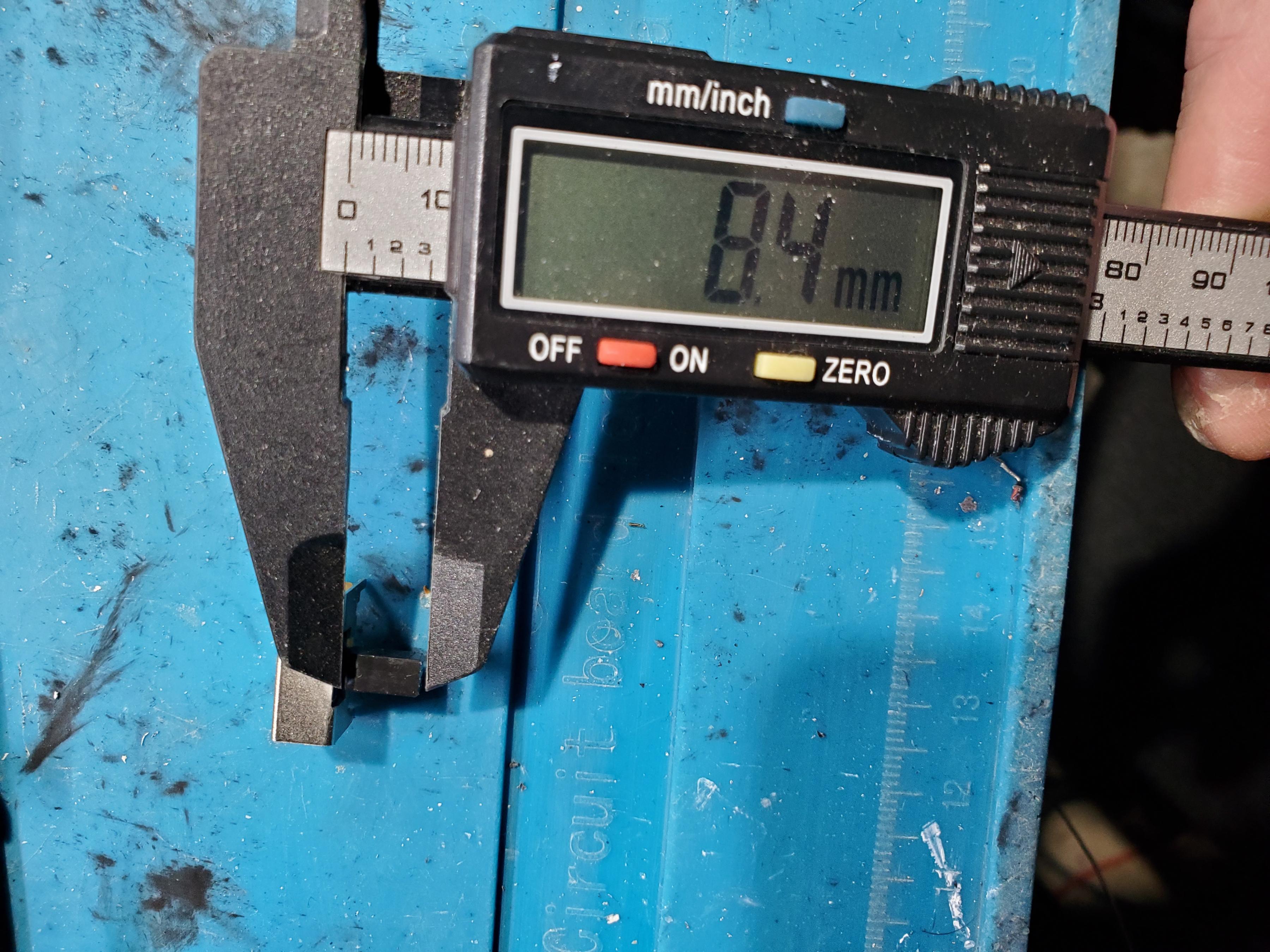

I need to know a part number for the switches in these amps. I have so many switches but these are reversed.
