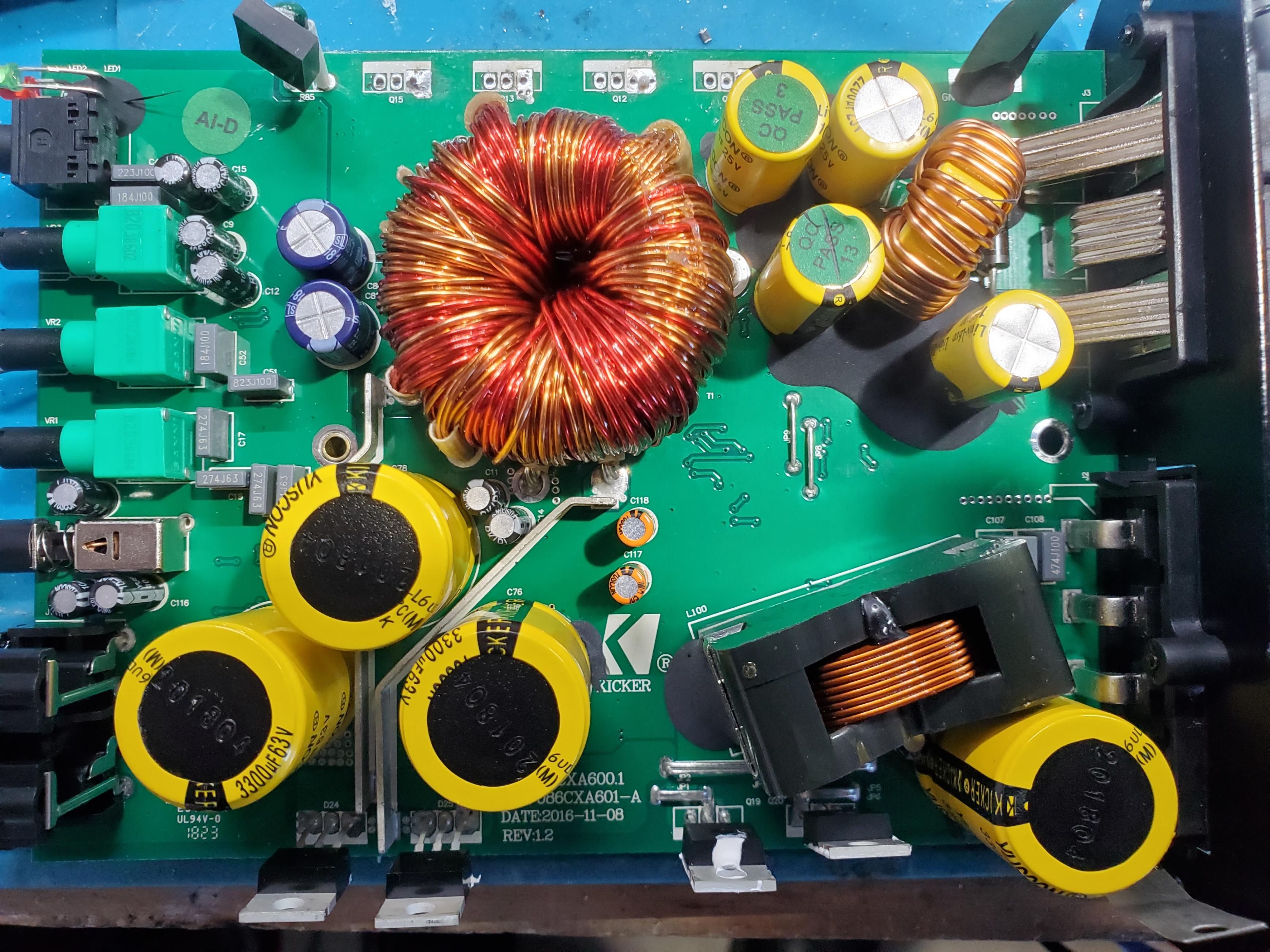

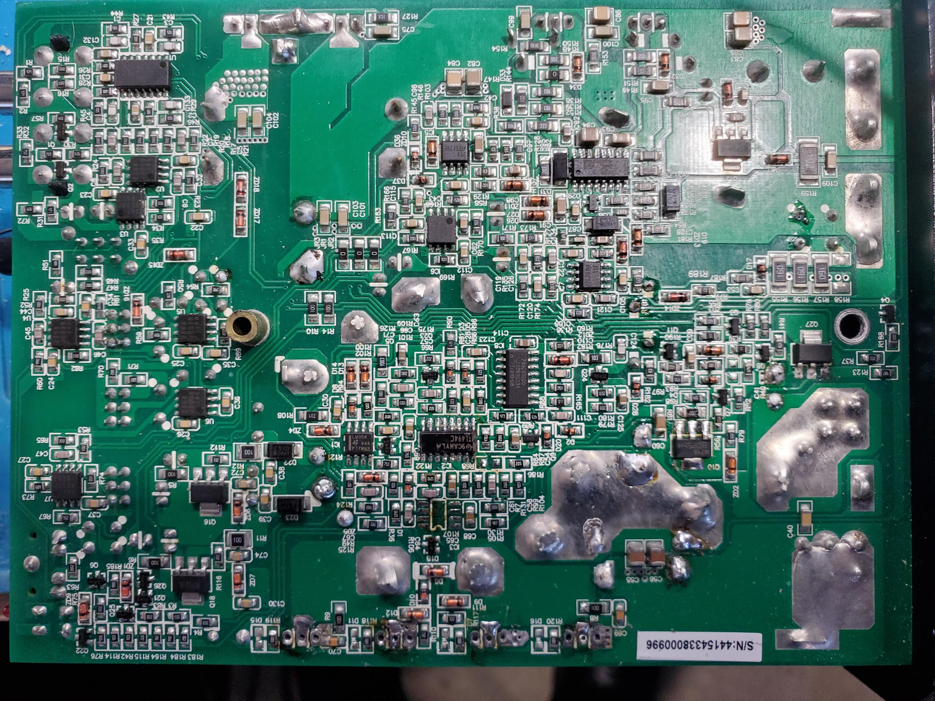

Kicker 43cxa6001 No Power, No Led, No drive.
i need help with a no power cxa600.1 No power, no protection led of any kind.
the power supply mosfets are removed and the r68 4.7r resistor is removed.
ic3 is also removed.
no drive at pin 9&10 of the 494

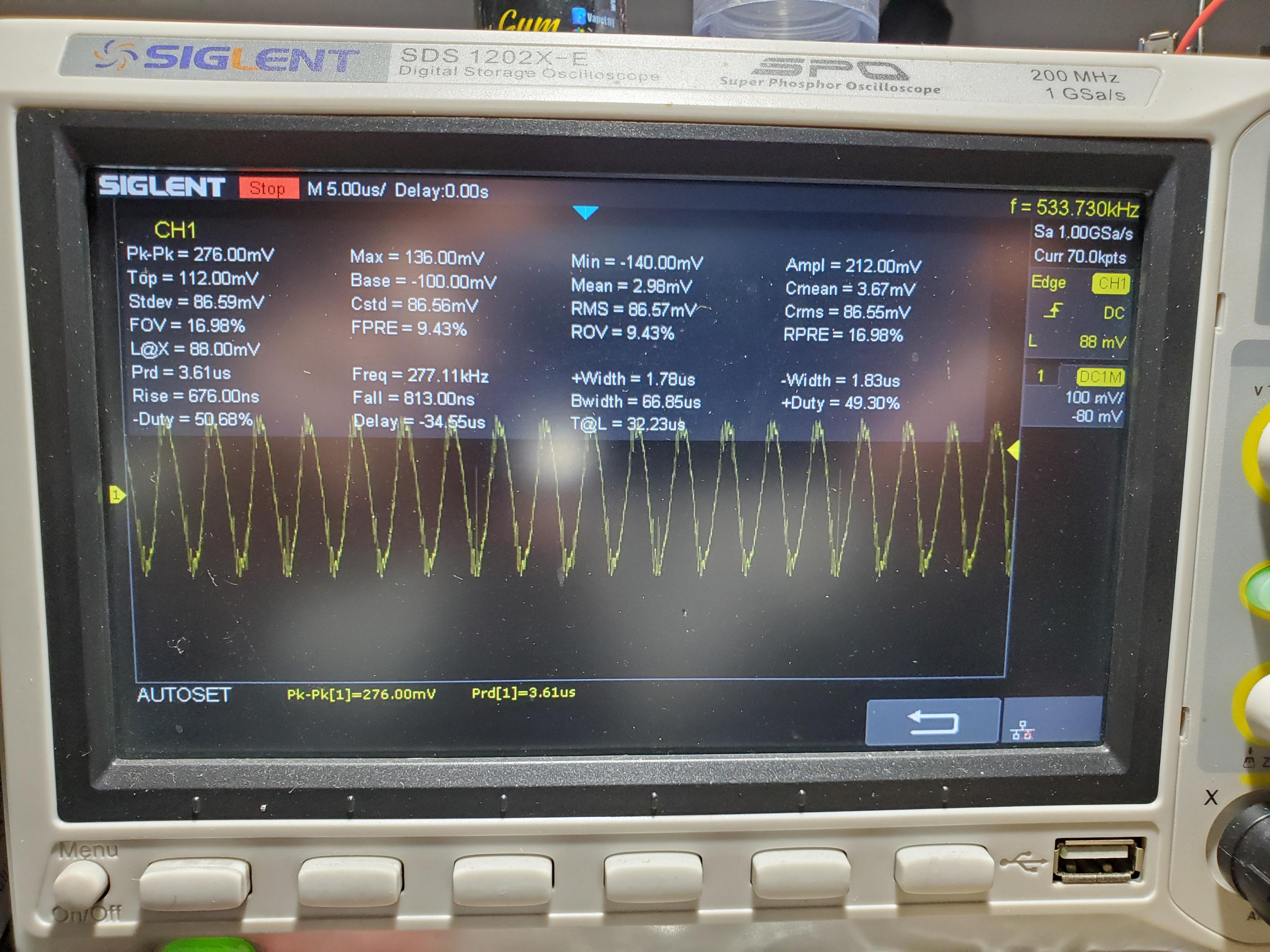

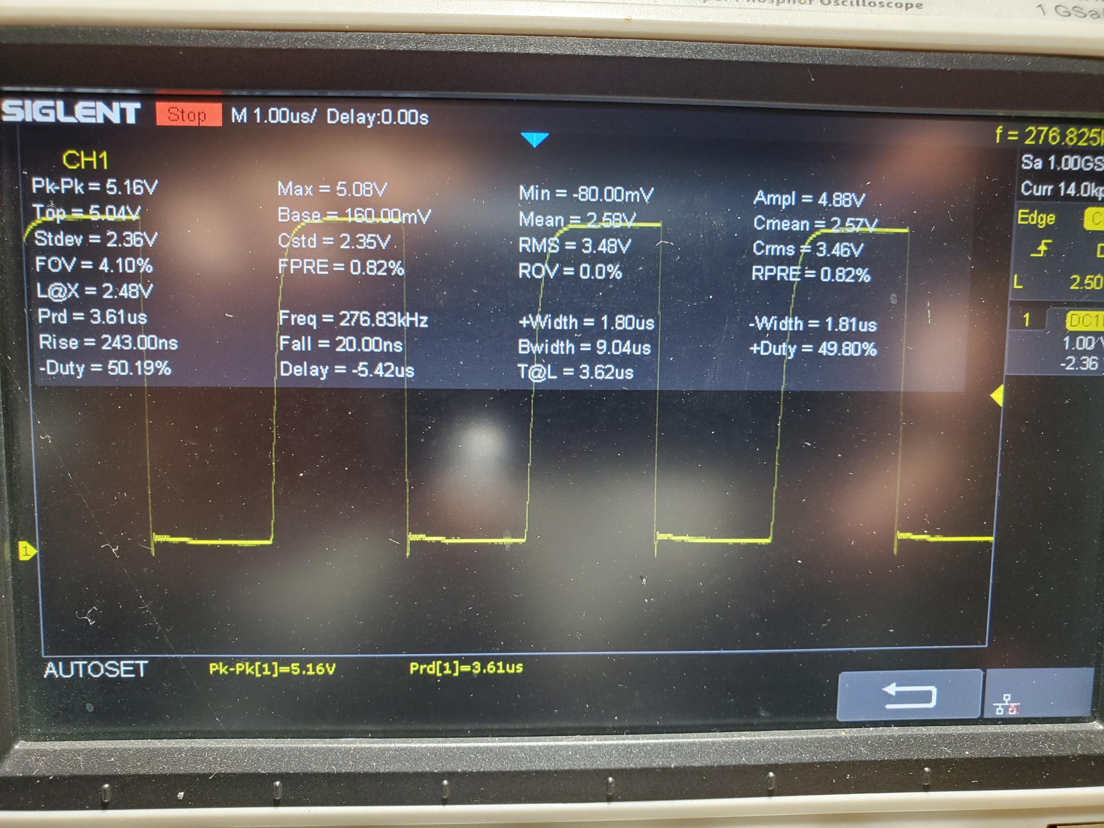

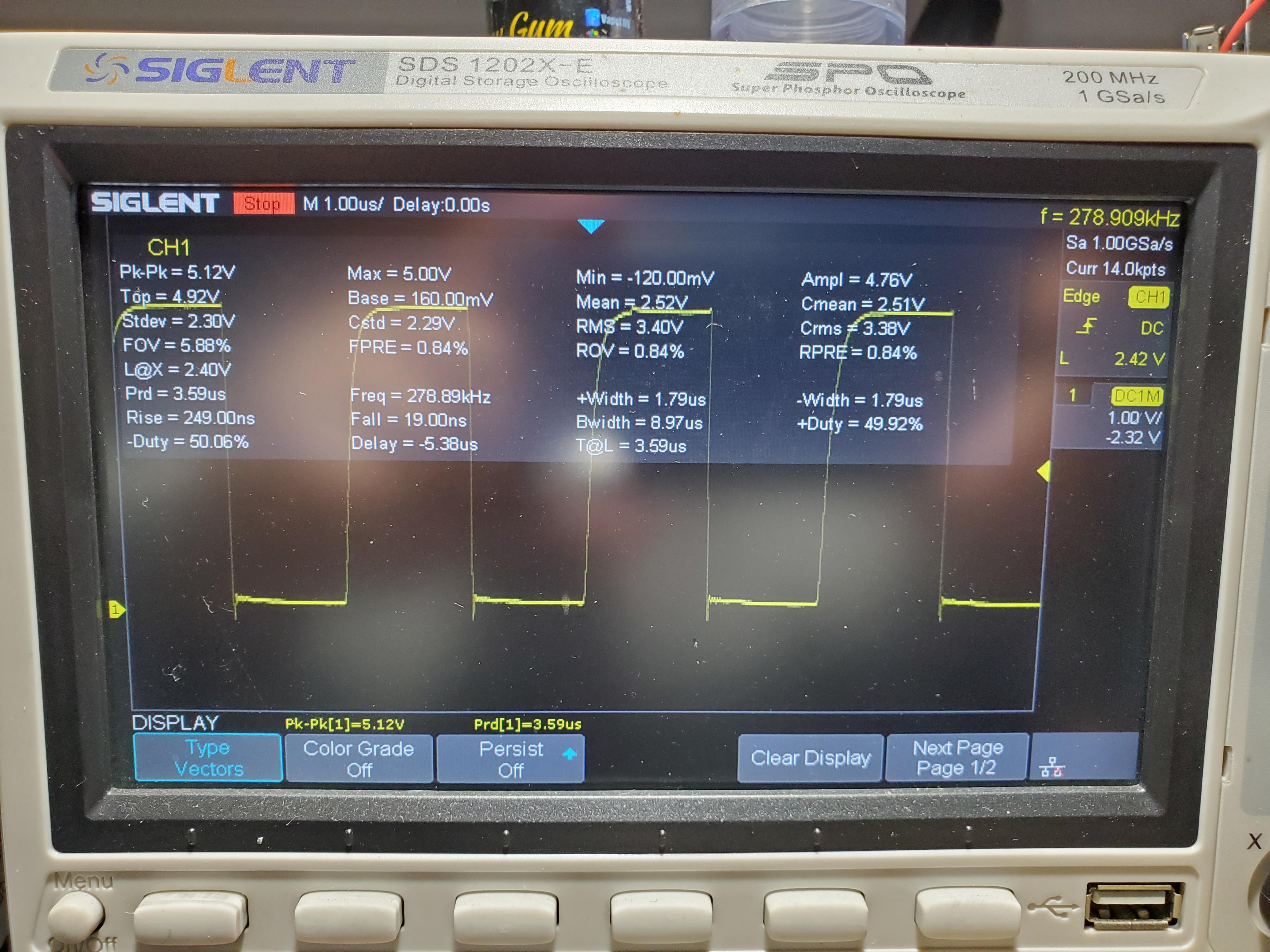

Check Vdc around IC4-IRS20957 and and post, also screenshots of Pin 3 and Pin 13.
Also check the Vdc around Q17. Black probe should be held at ZD8-13v zener diode(-Vcc).
You should see ~13Vdc on the emitter and base, and -28Vdc on the collector, middle lead.
ic4
1.) 10.21
2.) 10.21
3.) 2.506
4.) 0.00
5.) .001
6.) -47.91
7.) -52.10
8.) -49.61
9.) -52.91
10.) -47.67
11.) -40.74
12.) -0.001
13.) -0.024 fluctuation
14.) 4.093
15.) 11.98
16.) 2.117
q117
1.) 13.65
2.) 26.34
3.) 12.75
Check Q19 and Q20-200N15 if you haven't already. check C92,93,94,95 with an ohmmeter.
Check the voltage at R10-(+15VB) & R14(-15VB) both sides.
With a scope check on either side of C124, and IC7-LM311 Pins 2,3 and 7, IC4-Pins 3 and 13 and post screenshots.
