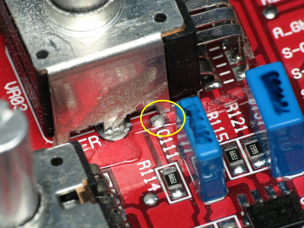

Check to see if the leg on one of the potentiometers is shorting to a feedthrough (in circle) are shorted.

i figured out that u102 was defective i replaced it and the amp powered up but then i noticed that when i move the sub bass pot it makes the speaker pop real hard and the amp goes to protect and the pot is feeling very loose and the traces from there lead back to the u102 so im guessing i need to replace that pot
when the amp is powered up and i have the speaker hooked up to the sub output and the rca's hooked up to my phone once i put the music on play the sub pops real loud and amp goes to protect even with my phone volume on 1 and the gains turned all the way down on the amp it doesnt make a difference at all jus the slightest little signal goin to the amp and it does it
