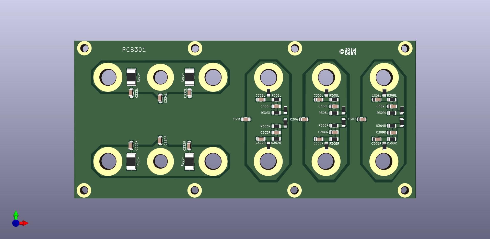

The board I am trying to make will be a mount for input/output jacks on the back plane of a stereo preamp, with RF/EMI blocking surface mount components on the inside. So I wanted it black on the non-component side, with PCB text labeling the jacks for the user. The jacks are grouped for each input and output left/right pair, with a separate isolated ground for each input pair as an island inside of a larger overall ground pour. I'm sure it is something I messed up, but I can't figure out what.

Well...Just as I suspected, my problems were self inflicted. And in the interest of full disclosure, I am a total noob when dealing with CAD programs in general and haven't been messing with KiCad much until recently...as if that weren't readily discernable.
So, where I went wrong was not paying enough attention to the details...the reason I was having so much trouble was due to 1)Not fully understanding how zones worked, and 2)Failing to set the proper attributes for each zone; specifically, I didn't have "priority" defined.
