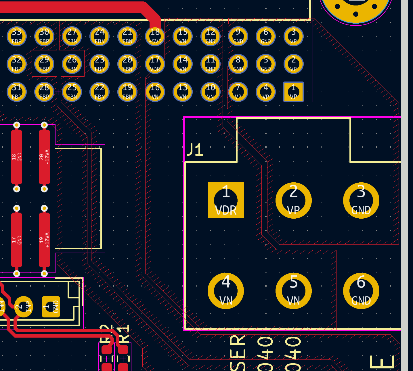

Another weird thing is there is no visible drill layer?, I recall someone saying KiCad does not support B/B vias, I can see why without having a separate drill layer(s). If I have a footprint or just want to place a hole, that is only a non-plated drill, no solder mask or anything else, will it display?

It's has nothing to do with generating a excellon drill file, or how to build a padstack, I can't see the damn hole(s) in the layout software, there is no layer defined for them, can you see them? I hope you do not ask why do I want to see the drill holes? 🙂
My gerber viewer, Gerbtool (once I load in the drill file), Orcad or any other s/w I have used, Cadnetix, Mentor BoardStation, Allegro etc have a layer defined for the drills that you can toggle on-off to display and print them out.
You don't see holes in the pads? Here's what I see:
I mean... You're right. There isn't a separate drill layer, but do you honestly need one? The only thing I miss from ancient OrCad is the drill table. I like to make sure I don't use too many drills. Though, that's probably not a relevant concern nowadays either. It used to be that you had to pay more if you used many different drill sizes.

Turn the solder mask layers off, what do you see?
Every other ecad tool that I have used has a drill layer but kicad seems to think one is not needed. okay so how do you specify a plated and a non-plated slot? Or I just want a pcb that is a bunch of non-plated holes, no copper or solder mask, I’ll be starring at a blank screen with a board outline? Sweet
