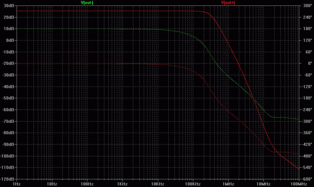

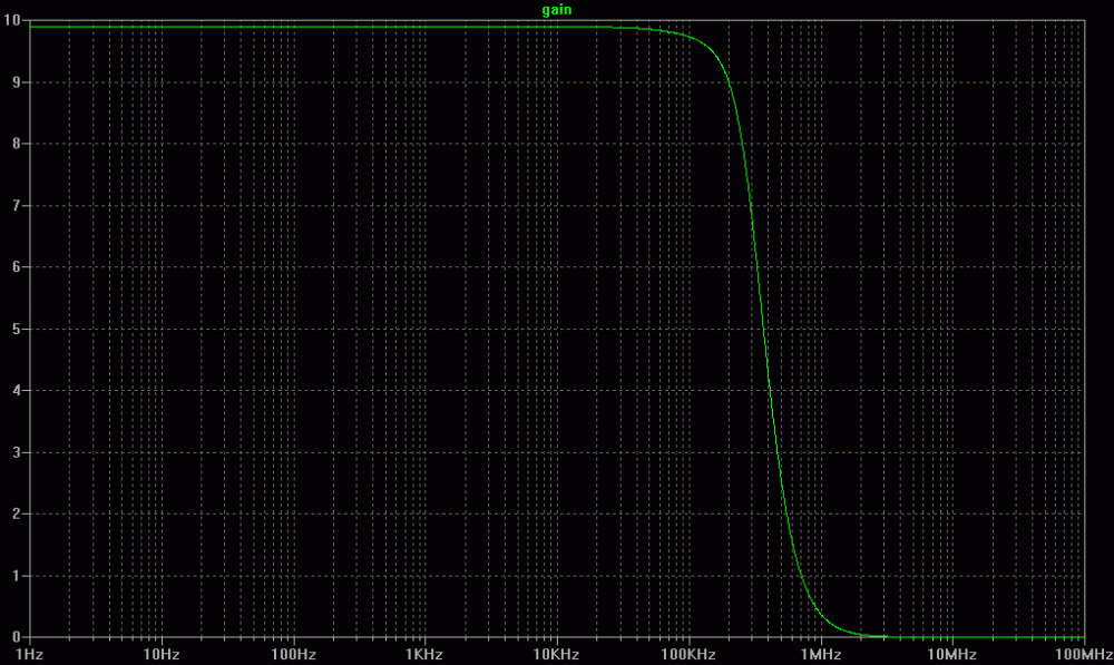

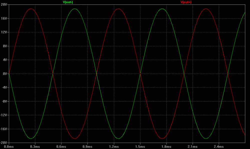

I belive this is my first post at tube section, 'cose I've been busy with sand, sorry:angel:. Recently I manage to buy 16 Ei PL509 along with Magnoval sockets wery cheaply. I also have a Sennheizer HD600 (300 Ohm) and Philips SBC-HP890 (32 Ohm) headphones but not a tube headamp capable to drive them both. So I am in the mood for something really special, like DC coupled balance OTL headamp based on PL509. I found only one schematic that satisfied my needs, that is schematic by dr. Kevin Gilmore (of head-fi.org fame) OTL based on 6C33C-B. Original sch have some mosfets which I can't get, so I changed that part of circuit for IRF9231 and IRF610 along with output tubes, some resistors and pots, added snoobers network and inductive decoupling at output. I think that servo opamps is a must in amplifier like this, but I have not try to solve that part yet. Guess that each output (+ & -) will need it's own servo opamp to control relative DC offset (+ output agaist ground and - output against ground) & one more to control absolute DC offset (+ output against - output). Let me tell you that I am NOT an EE nor have long experiece with SS and tubes, so ANY help and advise is wellcome.

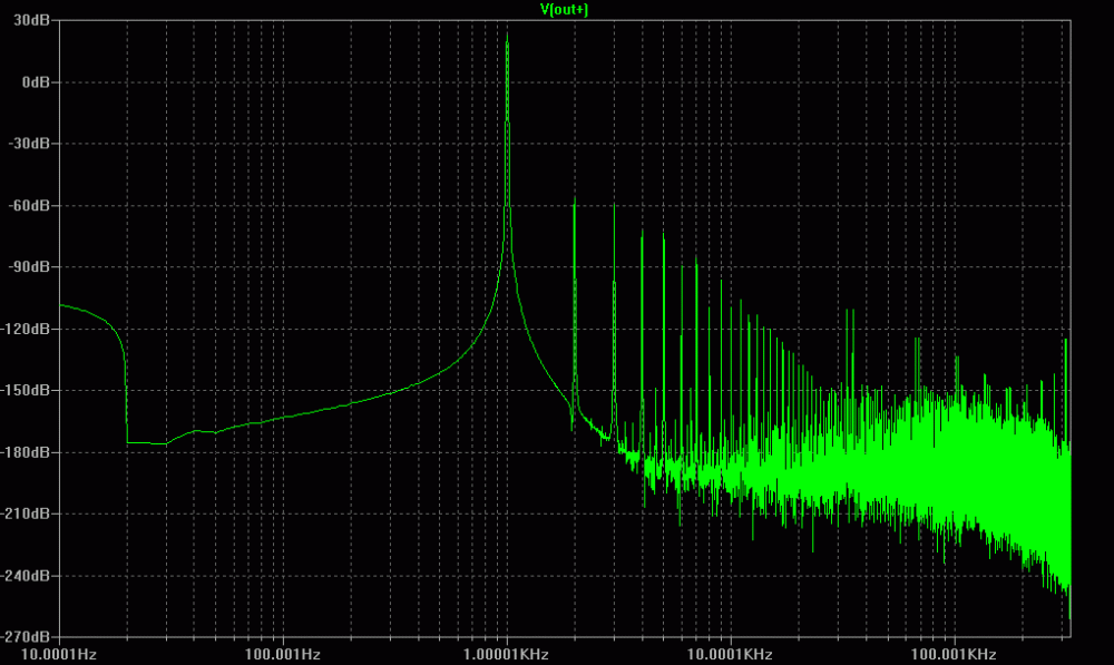

FFT at 1Vp-p output...

Now, as suggested, I managed somehow to swop BJT current source for tube one, but I have to learn that part first from Bruce Rozenblit book😀. How does it looks? At this point I should point out that, if this Headzilla ever come to life, I intend to bild poweramp base on same (more or less) sch. Therefore, I have to spare some of the PL509 for that duty, and for that reason I would rather use SS (M-fet or BJT) current source no matter how tube CCS looks good on spice or actual sound/measurement of a real thing.
That appart, I think I have trouble with Vbe mutliplier (Q3/Q4)and M-fet differential amp (M2/M3). Should I swop BJT Vbe multipier for M-fet Vgs mutipier (something like ZVN3306) and keep the 2 x IRF610 diff. amp with some resistors/pots values changes?
Any way, here is KGB v1.1 with tube current source...suggestions, comments?
