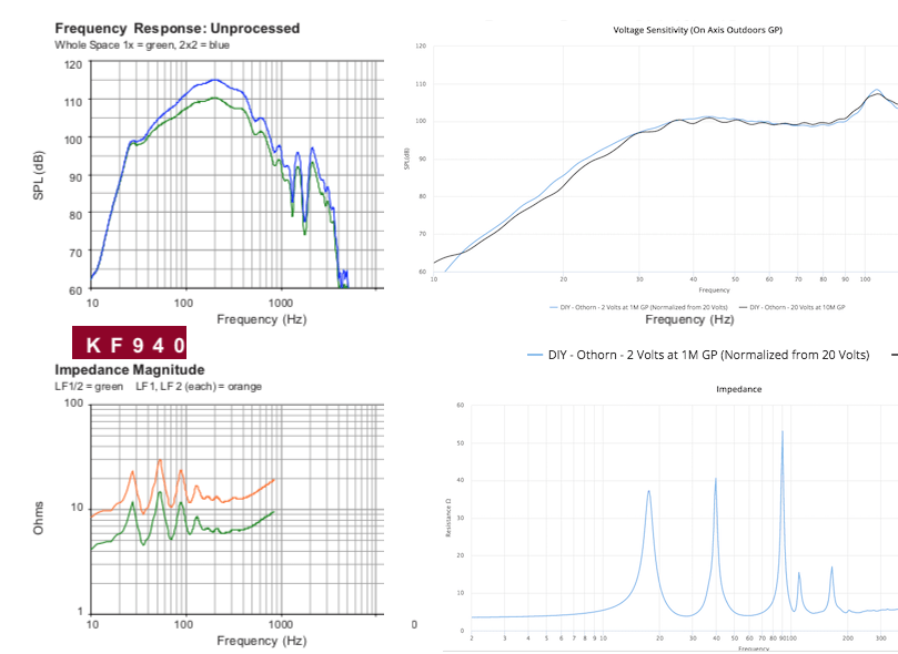

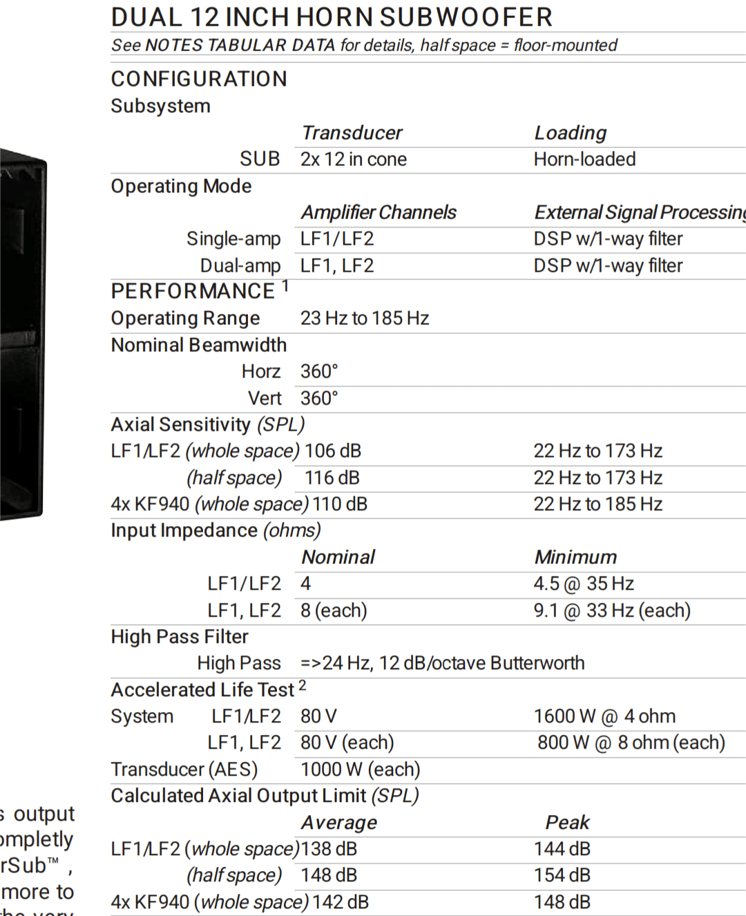

29Hz from a 34.6 cubic foot box (almost 1000 liters) is not very amazing.
The dimensions of 32" x 36" x 52" are not very DIY friendly, but the design is easy to build:
The drivers used in the EAW KF940 have low MMS (and Xmax) so contribute to the high sensitivity, but using modern drivers with over double the Xmax considerably more low frequency output is possible.
A tapped horn design like Josh Ricci's Othorn could be adapted for dual 12", using modern drivers could achieve similar low frequency output of the KF940 in about half the volume:
That said, limiting the driver size to 12" in huge cabinets does not make much sense now that high excursion 18" and 21" drivers that will hold up to horn loading are readily available.

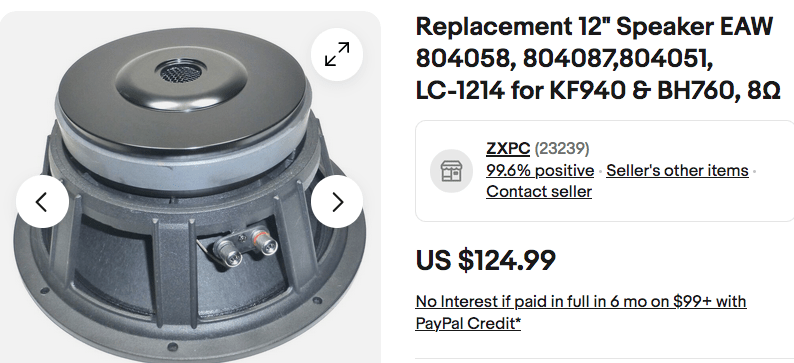

Yes, back in 1998 there weren't many 18" or 21" that would handle the power of the two 12" and also stand up to cone pressures of a horn.
The Othorn was designed to use the 21" B&C 21SW152-4,(Sd 1680 Cm2) which has an Xmax about double of the 12" used in the KF940.
To equal that displacement using the EAW804058 12" (roughly 7-8mm Xmax, Sd 520 Cm2) would require six, which probably cost about as much as the similar looking Eminence Kappa Pro-12A (only 4.8mm Xmax).
At Parts Express current price for the B&C 21SW152-4 is $907 (12.5Kg), Kappa Pro-12A is $175x6=$1050.00 (45.18Kg).
Displacement per $$ is a moving target, more options are available now than 25 years ago.

THs are limited in usable bandwidth to less than 3*Fb.
A 30 Hz TH would get you up to about 80 Hz and will likely needed to be LP'd pretty steeply at that point.
In comparison, a 30 Hz OTDL should be able get up to around 120 Hz,.
Ahhh, so a 21sw152 on a similar tuned horn will do the trick.
Can the keystone or TH18 be modified to do 30hz flat using the 21 B&C

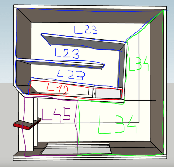

The driver/cabinet alignment is key to the "flatness", but the lower Fb of the cabinet does not change with the driver.
The scaled down, shorter path length version of the EAW KF940, the LA400, is a 45Hz horn.
If you "modified" the 35Hz Fb Keystone or TH18 to the have same path length, cabinet volume and fold pattern as the Othorn, they would also have 30Hz response 😉.
Art
