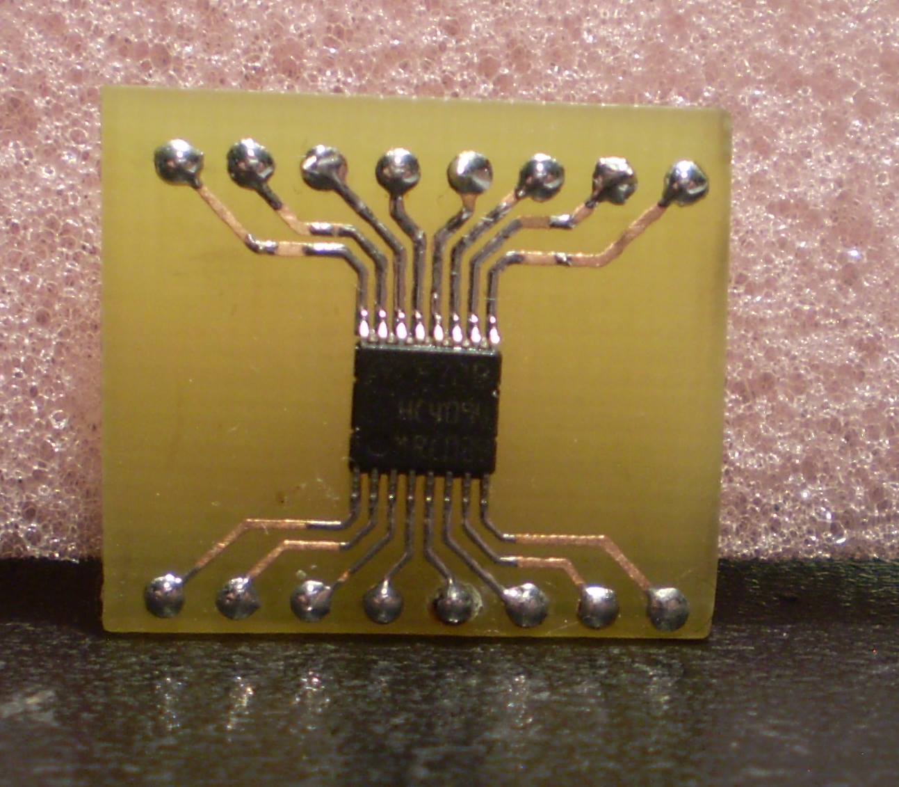

I have had good luck with the stuff found at Radio Shack as well.
The non-spill rosin flux paste they have (Cat. 64-022) is a must have and makes everything much easier.

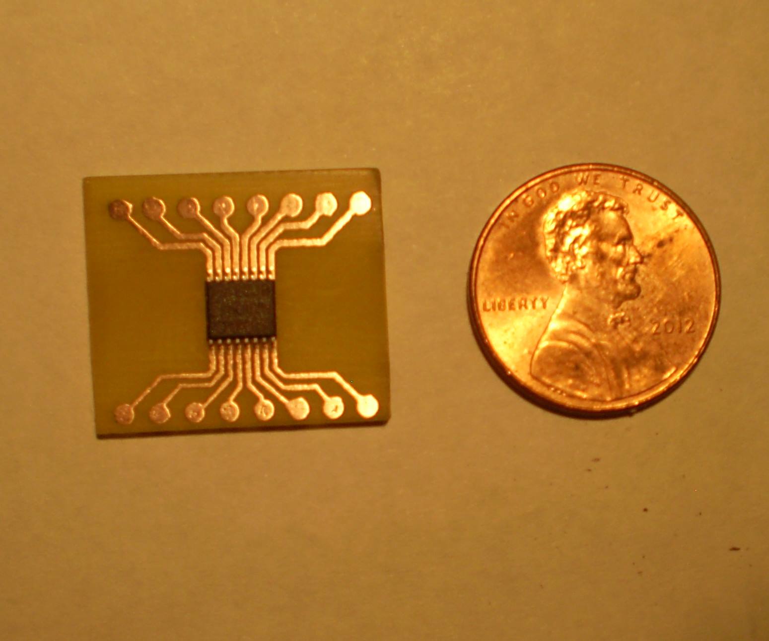

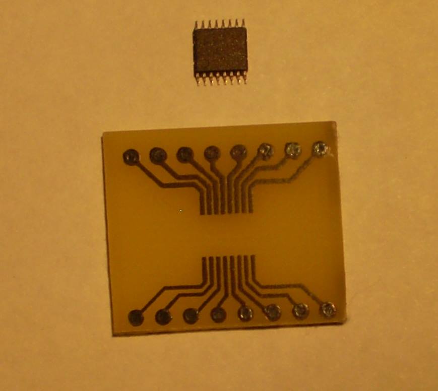

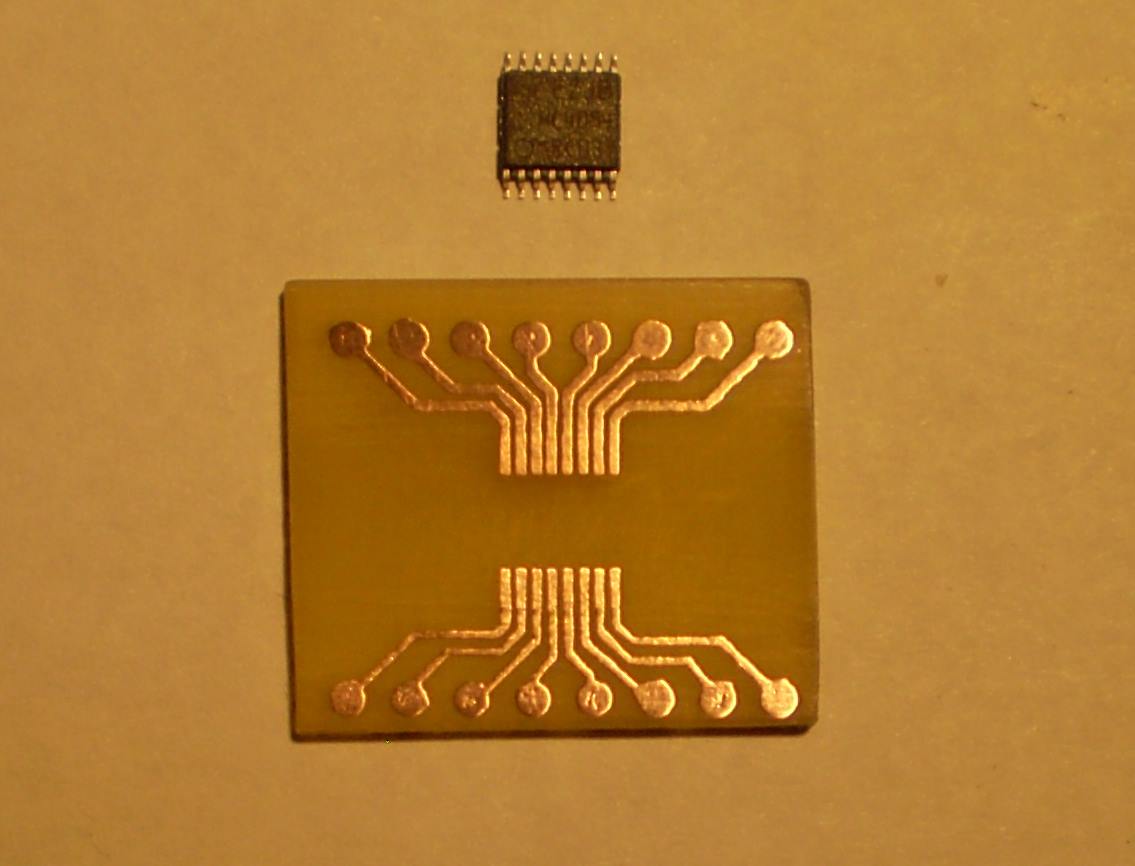

Here are some pictures of my very first attempt at SMD and it was much nicer and easier that I had expected!!
I used the RS Cat.64-1013 .022" 62/36/2 on this TSSOP package and it worked very well.
I haven't gotten any of the thinner stuff (.015") yet but I plan to give it a try as well.
Once I got the .022" home, I had realized that I maybe should have gotten some thinner stuff, but it worked.
Actually I was skeptical to use the stuff because it was silver based and I have used silver based solders before.
FWIW
jer 🙂
Nice work indeed!
I agree on the flux. Also cleaning the pads with iso alcohol and kim wipe then fluxing then soldering makes a really big difference on how things go. I have had good luck with the Kester Rosin pens they put down a tacky flux that holds the little buggers in place but clean-up's not as easy. My usual is a needle dispenser type my current is a Metron RMA sourced from All-Spec. Clean-up with it is very easy and it is the liquidy type so it provides a satisfying sizzle before the solder melts 😀
