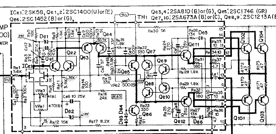

So i have restored my model 600 back to its former glory i.e completely recapped, new output the 2st5949's and 2st2121's new adjustment pots, zeners on poweramps etc.
Only now i have wondering bias, on switch on it goes higher than the 25mv it should, not a problem it quickly drops to around ~30mv leave it for a half hour and it drops some more to around ~23mv, adjust it to 25mv as per manual and it just drifts between ~20mv and ~26mv.
Is there any obvious cause for this? Schematic attached.

I'd guess thermal feedback is not unconditionally stable. There's a considerable delay in the circuit depending on where on the heatsink the thermistor is mounted, and delays in control systems always are potential trouble.

No... Seriously bias is not an exact science. It can fluctuate a bit, more at startup. Between 20 & 26 is not much a variation. But starting higher is weird though. Usually it should start at 0 or pretty low and raise slowly to 25mv. I would look for bad contacts or bad soldering. Wasd it like this before your restoration?

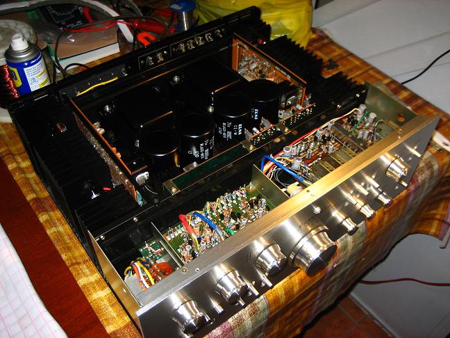

I discovered such variation and found that I had the 600 standing by side when I set bias, being so precise that in normal position bias became higher. After this conclusion I set bias in normal position (at the edge of the table...)
and it remains stable at 25mv. BTW very little heat generated, mainly by drivers and PS card, in normal and past normal use.

So stood on its side the bias drifted but in its normal position i.e like your picture the bias was stable?
Yes, that was my experience. It works as it should, now.
