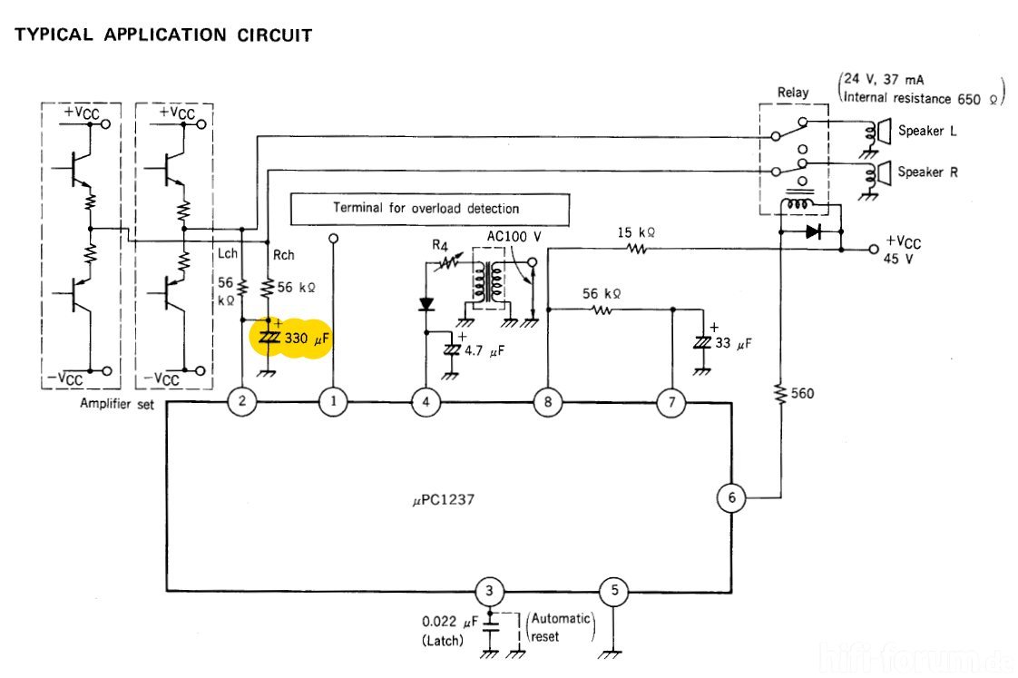

Looking the service manual by protection portion i get 0V or mV at pin 1 of the protection IC uPC1237HA from NEC while the unit in standby or while the led flickers
Now i wants to get the voltage at pin 2 but before I will do it I find on my actual L-A1 kenwood obmits 2 resistors R178 and R179 each 390K ohm it does shows on the service manual so i wonder is it the reason for the protection mode of my amp?
Since I do not understand much from the protection circuit from NEC uPC1237HA so I do not know whether its is Ok with it order not.
Maybe someone of you can explain me that-Thank you in advance!

The question is over current or over voltage on the output stage.
Check the DC voltage on the output emitters, ensure it is 0volts. I suspect it will not be.
This amplifier is from 1993 and will probably need replacement of the coupling capacitors first. You may be lucky and pin point the leaky one or two.
