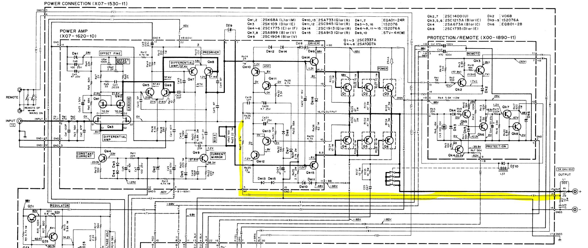

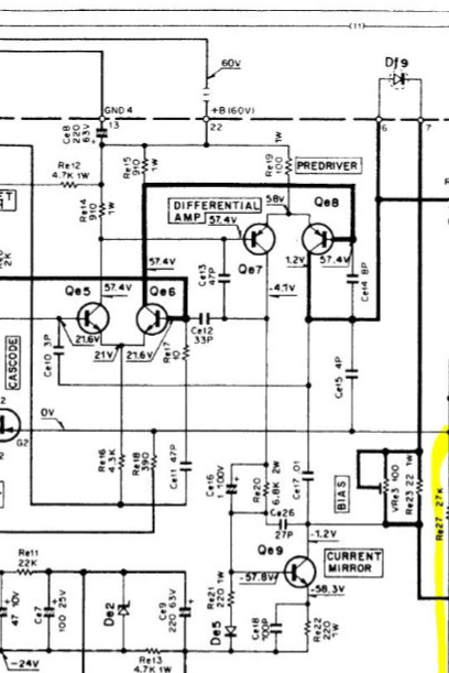

After staring at this for way too long, I noticed this amp has an extra feedback wire that going right from the amp side of the output inductor to the main feedback path to the diff pair (through a 27k resistor). So there is a feedback connection from each side of the speaker relay to the diff pair.
I tried disconnecting this and the issue went away. (But I didn't play it much like this, because I don't know how important this is and don't want any mishaps)
This wire is highlighted in the second schematic screenshot.

My understanding of design is less than the real gurus in this forum but I think I have sort of loop effect going on as this dual feedback loop creates a circle that is temporarily interrupted when the speaker relay opens. Am I on to something here?
50% of feedback is taken from near the output terminals, so that loop compensates also for relais and wire losses.
The other 50% is taken before the relais, so the amp can work correctly with no dc offset while relais still open, which is needed for proper operation of the protection circuit.

What is evidence that Onsemi isn’t fast enough? Do you have a scope showing oscillation?
I doubt the dual path for the two 27k resistors (Re26, Re27) has anything to do with the problem.

I’ll back away from my assertion that the parallel 27k resistors are not a problem. I maintain that the problem isn’t resolved until the amp performs properly with both in place, but your comment in first post deserves recognition.
When you disconnect Re27, the feedback ratio changes by 6dB. This migHt suggest oscillation. I highly recommend scoping for possible oscillation.
The closed loop gain will be about 6dB higher than it should be when Re27 is absent, so it can’t be deleted. The underlying problem has to be fixed.
