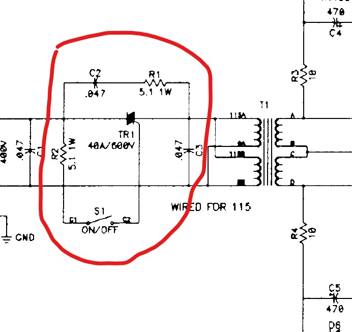

If there is an unused set of 'unknown' contacts and if it safe to do so then you could use those contacts to switch a Triac based switch. The switch contact would handle very little current but the switch construction must be suitable for mains voltages on those contacts. The contacts would have to be normal on/off and not a momentary action that only makes while the switch is being pressed.
The parts count is minimal, just the triac and an R/C snubber across it.
Nelson Pass used this approach in some of his designs such as the A75.
Just a possible idea.

So I just read about triacs, and that they physically switch off at zero point of waveform and can be robust enough and still super small?! A mod suggestion am reading says the off power consumption is super low as well.
I think someone in this thread mentioned them as well.
am not to sure yet but seems one of those can be used and that means I don't need to power a relay / have concern for protection diode and all that. Sure there is no satisfying relay click but it seems a less mechanical way of switching.
This is how Nelson does it. It is a classic triac configuration using a small switch for on/off. When off there is no power consumption as such apart from leakage. The snubber network across the triac will pass a tiny current and it is important that any caps are rated for continuous mains use. That usually means a "Class X" type of cap.
