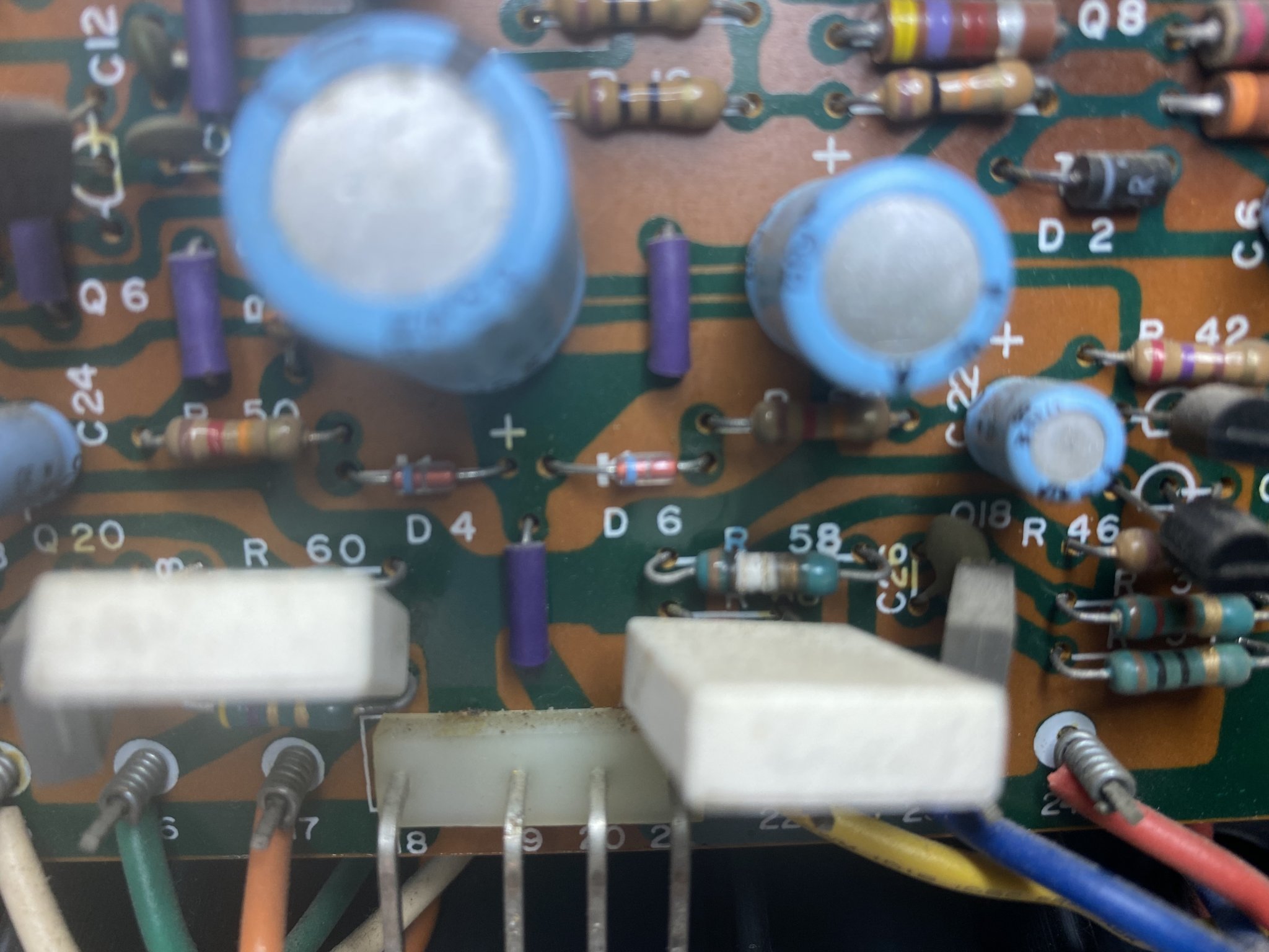

Hello all, newbie here who created their own issue - shorted the wrong pins when connecting meter to set bias. When I did this a pop happened and all the sudden the 180ohm R58 resistor went glowing red. I have 180 ohm resistors to replace this one, however I’m wondering if this is a protection type resistor that stopped further damage. The four main transistors on the power amp board all seem to check out fine and do not seem to be shorted. I see no other evidence (visually) of any other burnt up resistors, just this one.
any advice you can give I would greatly appreciate it. I’m including a pic of the board showing that resistor and a copy of the service manual if needed.
This will be powered back up with dim bulb tester in line next time as well

R58 glowing red would suggest that Qe18 or Qe22 (not on that board) may be shorted.
Can your ohm-meter check the forward voltage of a diode?
If so, check the forward voltage for the B-E and B-C junctions of each transistor, including Qe22 and Qe24 (also check resistance between C and E).
