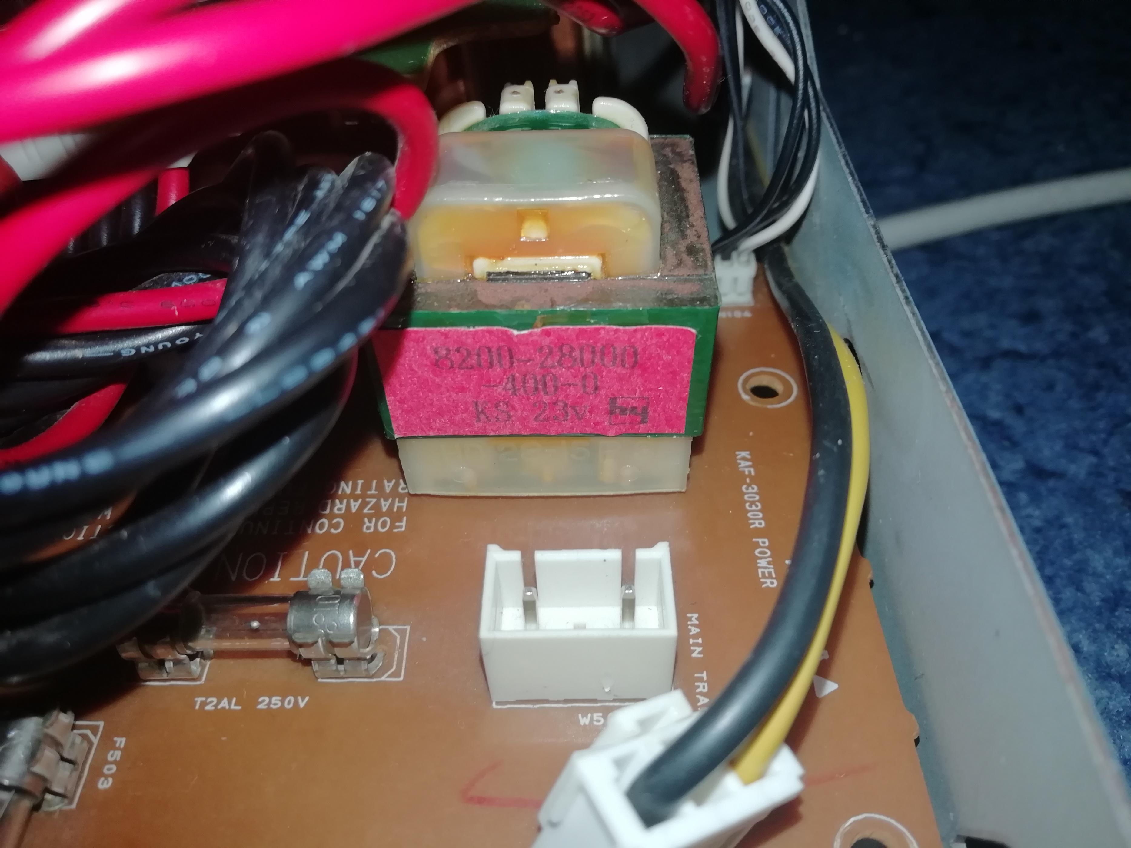

Thanks for reply Mooly.
The 47 resistor measures well, the voltage before and after that resistor is low.
I'm not sure how to check the transformer. I've always respected the big transformers can kill but Im thinking the small standby transformer will be OK for me check if you can guide me please
Appears to be a 9v transformer, should be easy to find one in the required footprint.
Do you have a bench supply? Supply 13vdc at the point it reads 13v on the diagram, see if the rest of it works before shelling out. A 12v "wall wart" should do at a push for testing purposes.
Thanks for your reply and great advice.
It says 23v on the transformer
I need to get a power supply, as well as other testing equipment. I only have a DMM, DBT and hand tools atm so a PS will be needed anyway. I'll take a look for one.
Least I know there's a chance I can get a replacement and find a way to check if the rest of the unit will work. Thanks again
Great advice you two again. I can feel foolish when it comes to test equipment 🤗

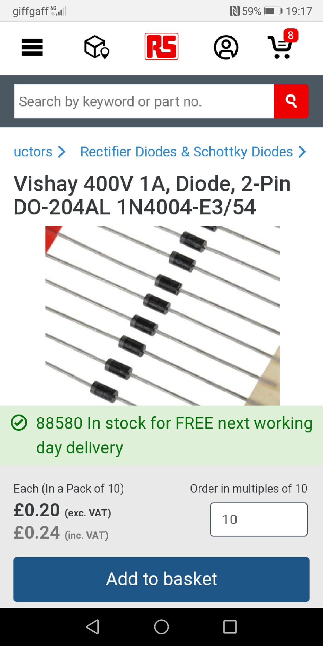

Just to be sure these are the correct diodes to order. Please excuse my ignorance as I'm learning. I've only ever ordered caps, resistors and output transistors/paste/micas previously.
6289029 item number, can't seem to share the link.
Schematic says IN4004A
Thanks for that Mooly. I just registered with them yet with the charge for delivery it worked out almost £5. It's free delivery from RS. Not sure if it's because one is up the road from me in Stockport or not. I like ordering from them as I could pick orders up when needed same day.
They will be delivered quick enough and only cost £2.40 altogether for 10
