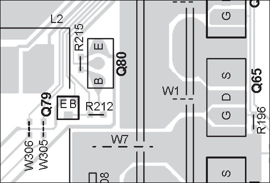

Ok here is my problem in a nutshell, MY trunk is uneven when my spare tire is in making my power wires pull out well while in the process the positive contacted the body of the amp and blew part of the board (a little part that had a line of solder on it) well i opened it up since no warranty and found this i ran a new bead of solder where the old one was it fixed the problem, a couple days later my battery was dead. come to find out now my amp draws current constantly even when shut off. btu the weird part is other than that my amp works fine. i dont know why its drawing current when off but it gets hot if left hooked up. when i remove the power i can here something click.

Q80 may be shorted. You should not read anything near 0 ohms between any of the legs of Q80. If you do, you need to remove it from the circuit to check it. Do this with no power applied to the amplifier.
Im kinda new at repairing amps and everything so im still learning what and where things are. i beleive i found what you were talking about and i get resistince between all the legs.
Can you get to Q79?
If so, check it to confirm that there are no 0 ohm connections between any of its legs.

no i cant even find the Q79
some more info i can tell you is that the resistance between the power and gorund inputs is when my red lead is hooked up to positive and black to ground it read out at 60K ohm but when i connect them backwards red to ground and black to positive i get 0 ohms a direct flow but it only does that in one direction.

Q79 should be within ~1/4" of Q80. It's a surface mount transistor. The base and emitter are marked on the image below. The 3rd leg is the collector. Measure the resistance between the emitter and collector (no power applied to the amp).
You can't use your meter to measure resistance with power applied. The voltage on the circuit will skew the readings.
