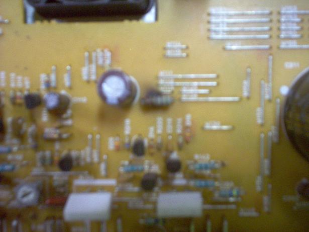

I have this amp with a burned resistor.The board is burned slightly so I can't read the designation number.It is between a cap C205 and W126.It is directly below W113.Any one know what it's value may be.Any help would be greatly appreciated,thanks.I have put a picture of placement,sorry my cam is not that good.The resistor in it is not the original,the original was alot smaller.It is a flame proof resistor.The amp works with the one in it,used it to just test amp.
Its R207 give me a minute to check the BOM for a device ID...
BOM says 10 ohm at 1/2 watt ceramic
