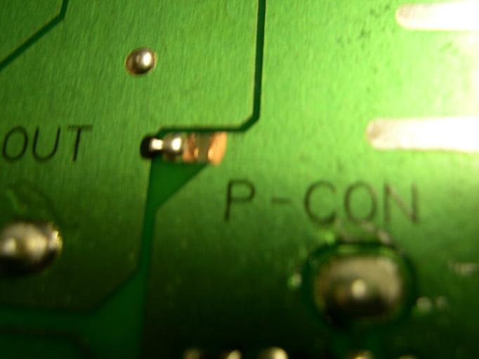

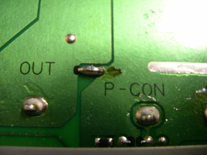

Upon closer inspection while looking for D4 i noticed a blown trace(see picture). I've since repaired the trace but haven't tried to power it up yet. I'm wondering what might have blown the trace in the first place and is it a good idea to try to power it up or should i be looking for something specific. Thanks for all your help so far!

Well it seems to be working. I'll have to test it with subs or a dummy load connected. So if i understand it correctly a 12 volt source was probaly touched to the outside of the amp where the paint rubbed off and blew the trace to ground since it was too small for the current traveling through it?
Thanks for all the help, i wish i noticed the issue earlier before wasting peoples time. I'll post the results of a true test tomorrow evening.
Sometimes people have the amp ground go bad and the case tries to ground it. Plus the bottom cover is bare metal on the ones I have seen. If you look close sometimes you can find the little burn where it grounded or someone hit it with 12v.
